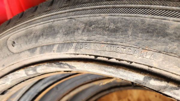

Looks just like my tires. Dan

That photo of the side wall looks the same as an Olympic tyre.

First thing, if they are Australian made they are tyres, not tires
Olympic stopped making their legendary 30 x 3.5" tyres in the early 1970's. The moulds ended up with Lucas in the USA. They had Lucas branded where there was once Olympic. Then the lucas brand was deleted and the panel was left blank like yours. As far as dating them goes, they are at least later than early 1970's.
If they have not been mounted on rims for a long time, they will need stretching to make them fit. I have just mounted a set of five brand new Olympics which had shrunk up to 1.5" in diameter. Let me know if you need advice.

Allan, your timeline fits the backstory of my car that the tires came off of. Supposedly it was restored in the mid 70s and then put into storage for 45 years before I bought it. The tires were like new when I started driving it. 5 years and approx 25000 miles later the age was taking their toll so I bought some new Blockleys. Those old Australian tires are awesome.
