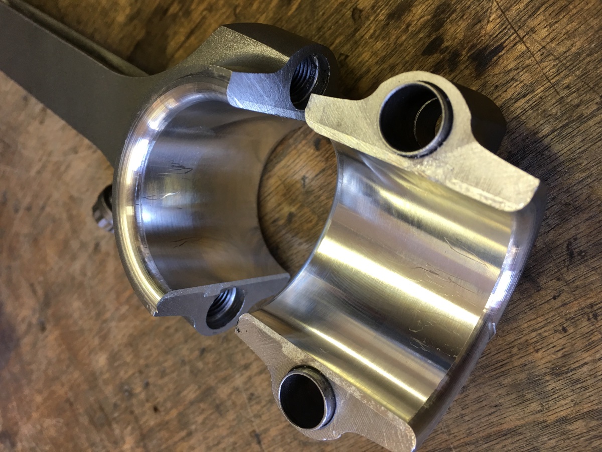

Your wrist pin issues sounds like it could be pin hardness. Have you checked the rods for proper alignment?
Just one minor thing I’d like to point out that I’m sure you already know, but I’d like to bring it up for the possible benefit of others viewing this thread.
Inserts are more correct for a pressurized oil system.
Babbitt is more correct for non-pressurized oil systems.
The reason is that the regular thick babbitt can “bed in”
contaminants and keep them from rapidly wearing the crankshaft. The inserts only have a very thin layer of babbitt which is an anti friction material, but not thick enough to bed in most contaminants. The pressurized system constantly forces filtered oil thru the bearings.
BABBITTED SCAT RODS:

Re: Scat Stroker crank question
Dan, I did babbitt & machine those rods. It was done a couple years ago for a friend of mine. They went in a stroker SCAT Fronty motor. If I remember correctly, I think they were ordered as rods for babbitt.
