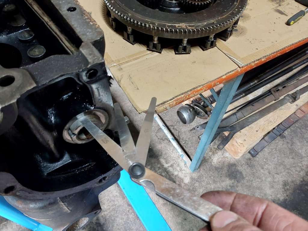

I have wear in the bore of the camshaft bearing block. I have about 0.01 inch play. What is the best thing I can do to fix the problem?

Vonau, do you have the same or similar measurement when the camshaft is in the bearing?

Yes, the dimensions are the same as with the crankshaft. You can also see signs of wear on the block, so new bearings won't fix the problem.
The bearings are close to the crankshaft. I actually expected that to be the problem.

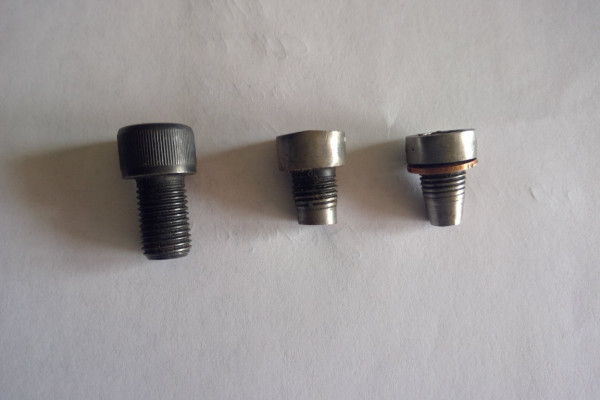

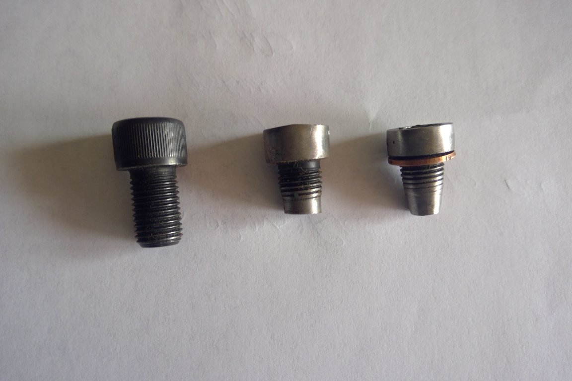

As John pointed out this may change how true the cam runs but I have made tapered allen bolts to take up cam end play and if you make it a bit to long it will push the cam to one side of the bore, which will also change your timing gear back lash (with the worn cam bore it is most likely excessive). I have included a picture of what I start with and what I end up with. Good luck. Dennis
