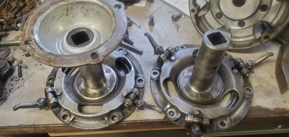

Work is continuing on the 25 coupe tranny. I ordered correct screws from Langs for an original ring gear. As I was cleaning up the driven plate I realized the holes were badly egg shaped and the clutch push ring pins badly tapered. I found a very nice spare in my stash, shown on the left, that fits my fourth main beautifully also. I will also try the square hole on the u joint while it's much easier.
- Posts: 5105
Re: Magneto setting, doubles as a good sanity test
You may not be aware there are 2 different push ring pins. The ones that came for the wide drum are tapered smaller.
A good fix for the slightly worn holes in the late drive plate is to use the earlier (large pin) plate to better minimize the slop. It appears you had the later push ring with the earlier output.
Dont throw the worn drive plate or the finger ring. The drive plate holes can be welded up & re-drilled. They are not being reproduced.

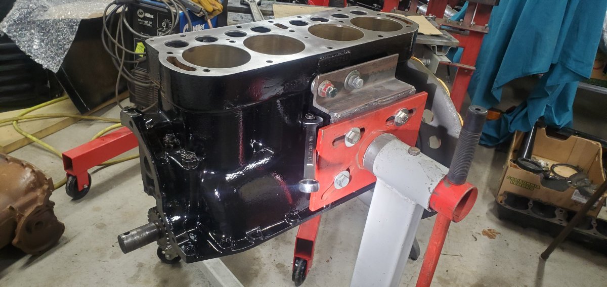

Work continues on the 25 Coupe engine. What started as a magneto repair has become an opened pandoras box. The engine had original cast iron pistons with number 4 cracked on top. Luckily the rod and main babbits were excellent with many shims. Repaired two freeze cracks in the jackets by drilling holes at ends and v'd out with an air file. Filled with Belzona 1311 Ceramic R metal. Filed flat with a file, it doesn't sand well. Got the block cleaned up to .40" over from Metal Crafters in Stevens Point. Thanks MTFCA for the drawing with dimensions for the block adapter engine stand mounting plate which I built this morning as vendors are out again. Set the crank mains to .001" to .0015", turns nicely with a 10" adjustable. Would have been nice to get a Stipe cam, none available. Getting ready to set field coil clearance.

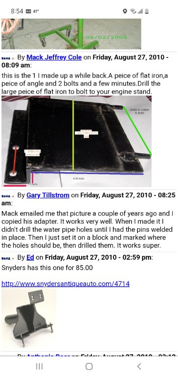

Steve, would you be so kind as to tell us where you found a drawing for the adapter? I need to make one too. Thank you.Steve King wrote: ↑Tue Mar 14, 2023 4:47 pmThanks MTFCA for the drawing with dimensions for the block adapter engine stand mounting plate which I built this morning as vendors are out again.
Mark, I copied the stand adapter from a drawing provided by Mack Jeffery Cole. It was simple and I used 1/4" plate. The design is nice because it offsets the weight due to the heavy flywheel and transmission when you get that far. The thread is engine stand adaptor plate.
- Posts: 5470
One problem with the full plate stand adapter is that it's near impossible to capture the center main bearing nut in the middle of the block to remove it or hold it to loosen.
Steve King
Topic author - Posts: 86
- Joined: Tue Oct 20, 2020 7:39 pm
- Last Name: King
- * REQUIRED* Type and Year of Model Ts owned: 14 Touring, 25 Coupe, , 26 Touring, 22 Aluminum Fordor, 23 Coupe
- Location: Wisconsin Rapids, WI
- Board Member Since: 2010
Steve, I'm not saying it's ideal but it is offset to 1 side. In the picture I can get a hold wrench in there. I could have helped myself by offsetting the adapter on the stand plate. I set the mains in another stand that bolts to the 4 exhaust clamp stud holes actually. I am using this stand adapter to make the engine vertical for magneto work.

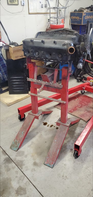

This is the stand I'm using for main clearance adjustment and valve work. Imagine the head off here the engine can be flopped back and forth so the deck or crankshaft is on top. The device in front swings up and bolts with 1 bolt in a head hole thread and has 8 spring loaded pins to hold the valves up while you put all 8 keepers in and adjust valves. You can look in the bottom of the crankcase which is on top, turn over engine until the cam lifter is on the heel cam and adjust the lash of that valve. The spring loaded pins holding the valves up allow the valves to open and close like normal and you don't have to stand on your head to see the cam heel.
