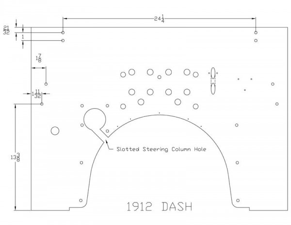

Finally found some of the information I was looking for on an image in another thread.
http://www.mtfca.com/discus/messages/82 ... 1543334612
It looks like it was drawn by John Regan so I am confident it is correct.
It confirms what I suspected. The brackets are in the wrong place on my current dash.
The image is not very clear, due to the low resolution, but it looks like it is 24 1/4" between the sets of holes. The top hole looks to be 21/32" from the top edge of the firewall and the lower hole is 1" below that. I suspect these are 9/32" holes like the side lamp bracket holes. Someone can correct me if I am wrong (and please do!).

Just a note, This drawing does not show the second mixture rod hole that made the dash reversible.

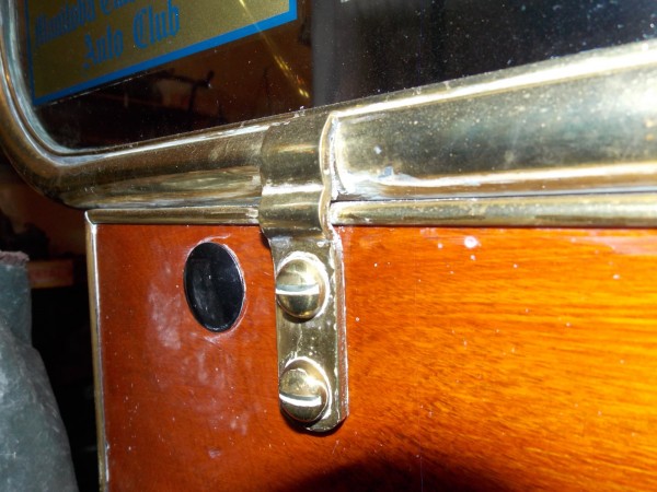

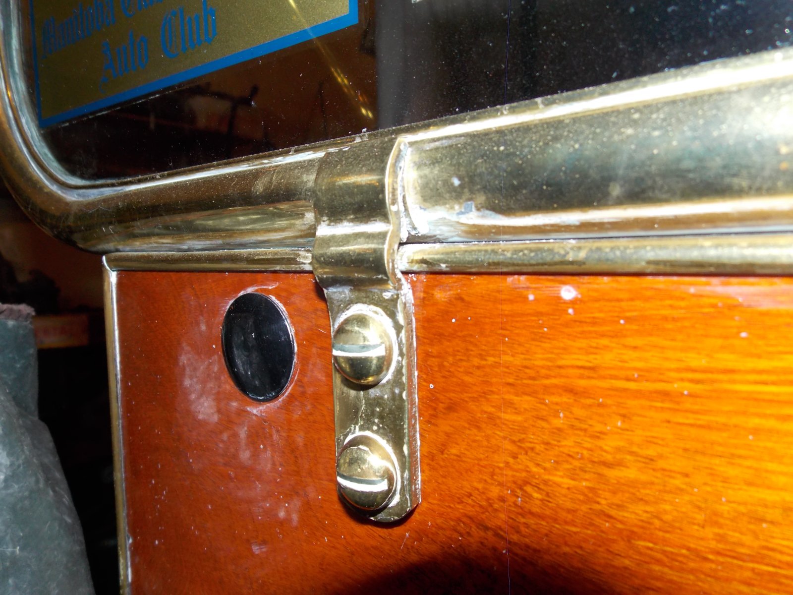

Tod, the brass trim is not notched. The clamps have a second bend so they clear the trim. The windscreen does sit on the trim with no packing/gasket. I would not drill the clamp holes until you get the correct clamps. Then set the screen in place, set the brackets in place and then drill the holes to suit.

Re: 1912 Firewall Question
if you enlarge you can see the clamps cheers Colin

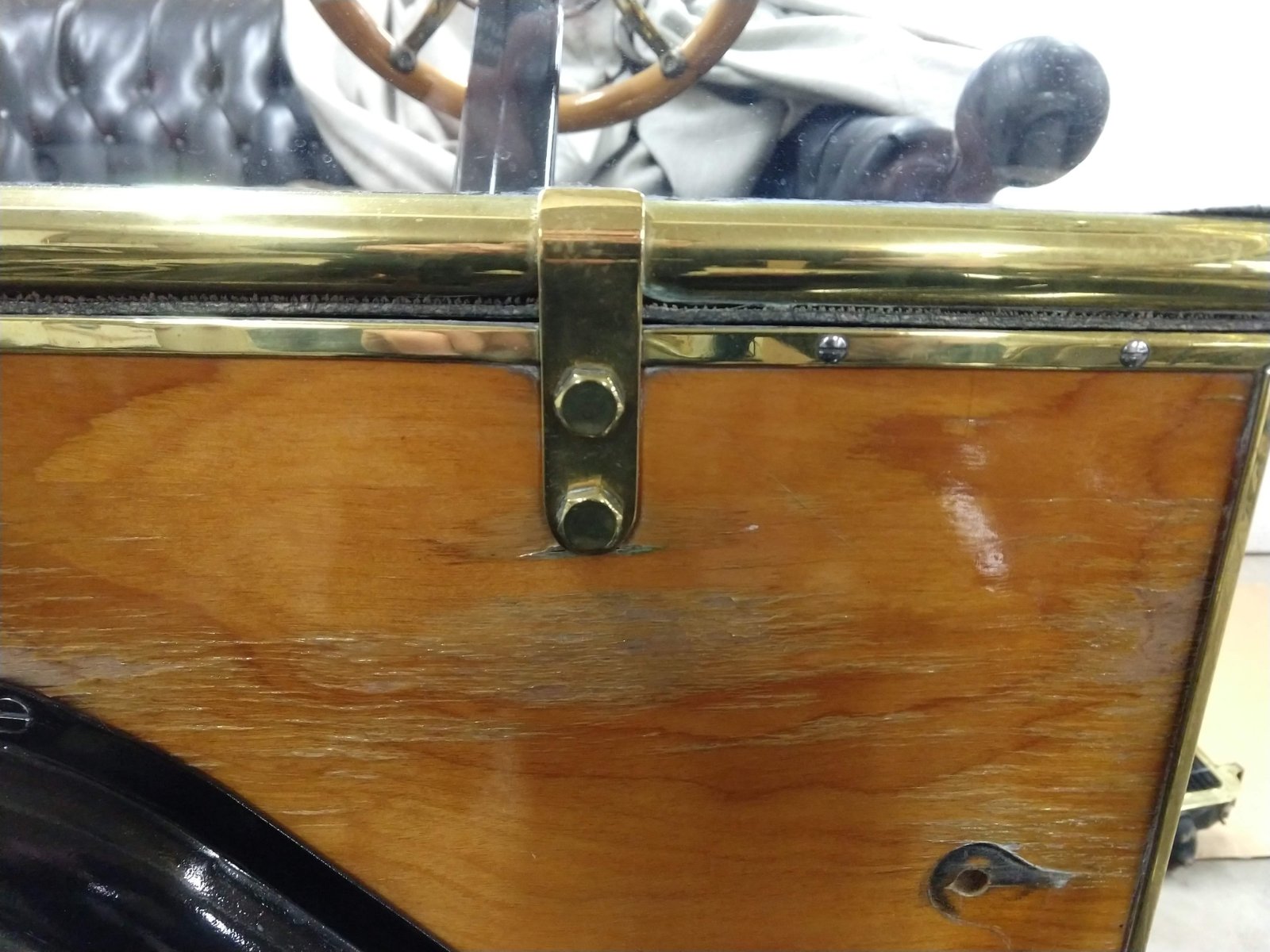

here is a close up the brass trim is original as are the brackets Cheers Colin
