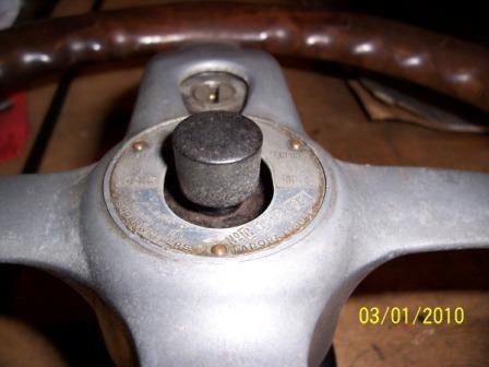

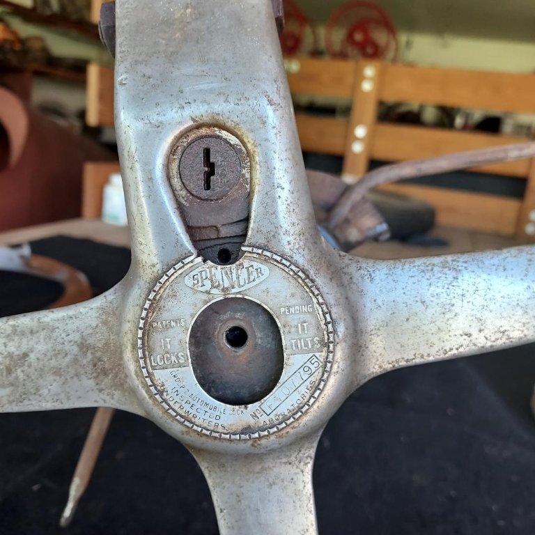

Any suggestions for Spencer Fatman steering wheel removal?
Post by ModelTSpeedster » Tue Apr 25, 2023 9:24 am

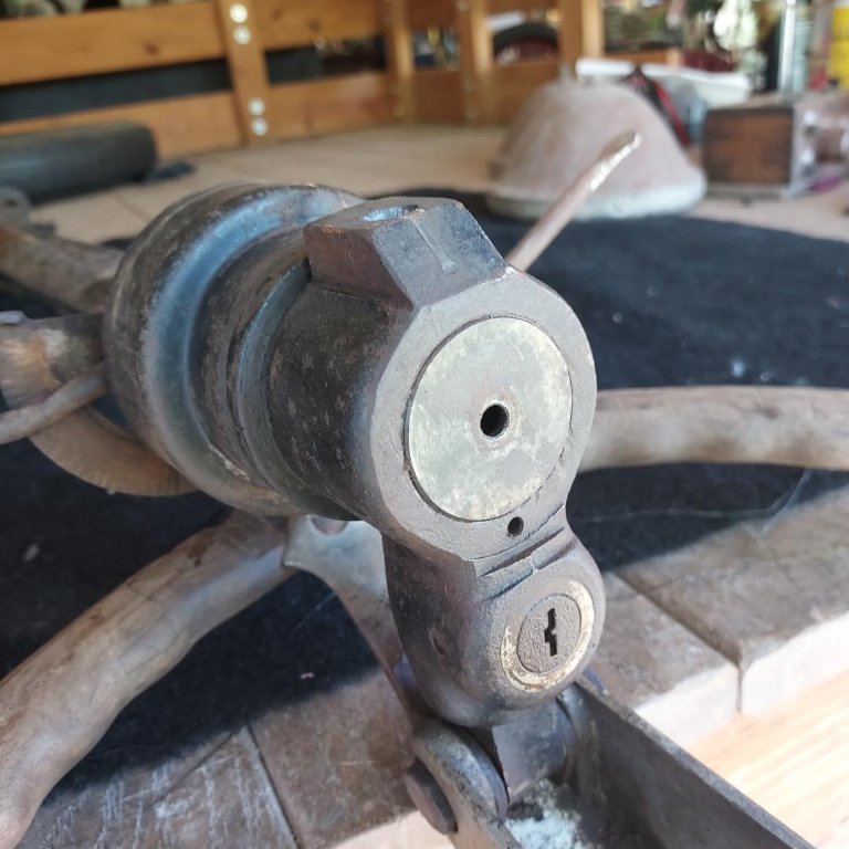

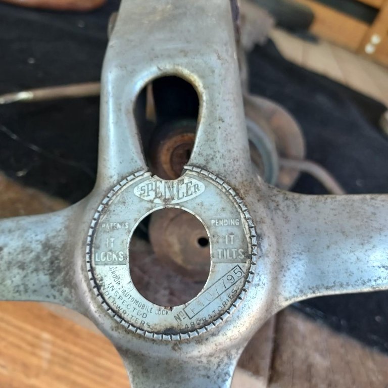

I recently picked this up and need to know the secret for removing it from the steering column. The wheel spins freely, so the lock is not engaged. Is the key required to remove the center cover in order to get to the retaining nut?

Look in that cover cap hole. I expect that plug must be pulled to access the nut.
The question would be is there also a pin or 2 retaining it also.

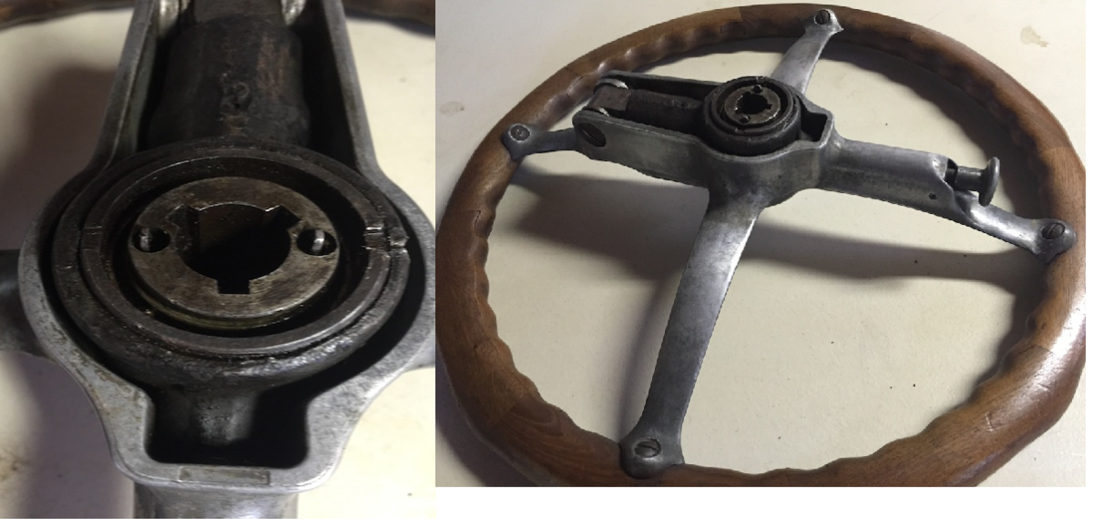

Look at the patent drawing for patent 1,596,230. It may help to see what's inside the mechanism.

Someone put a washer in the center instead of a cap. Pry off the washer and the nut is underneath. It will then come off.

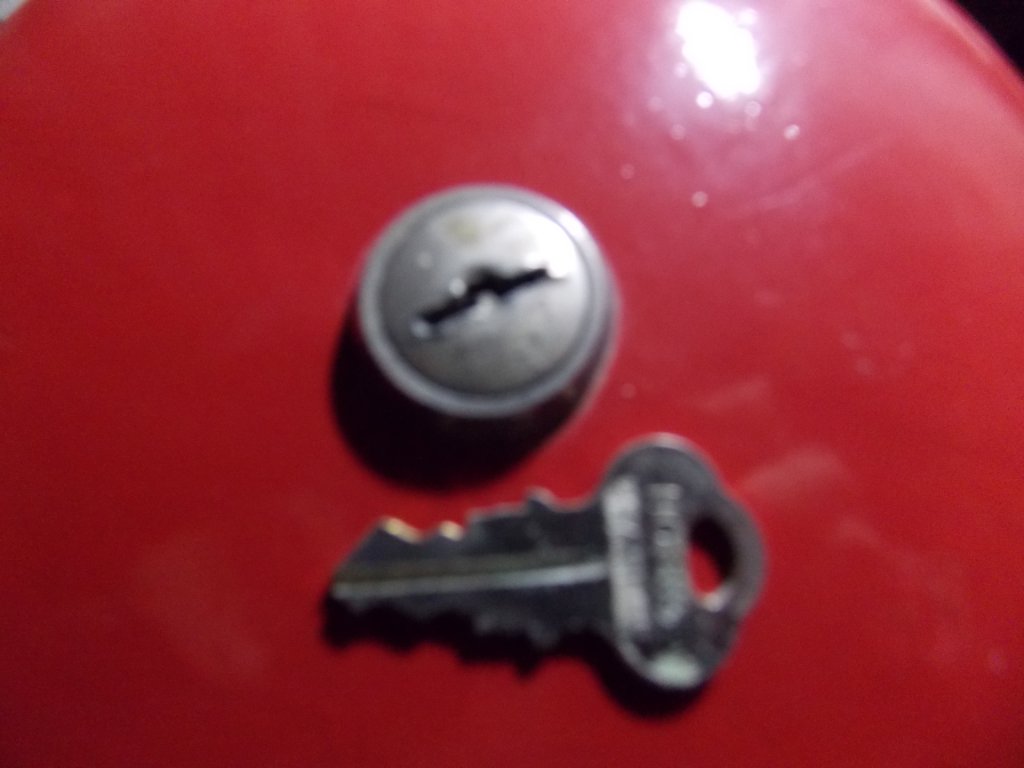

"With the pawl engaged, the wheel operates normally. With the pawl retracted, the steering wheel spins without turning the steering shaft or the front wheels, making the car impossible to drive (and harder to steal.) "

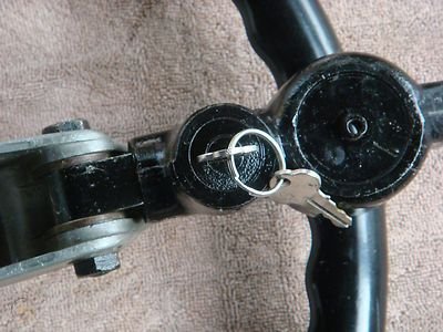

Picture of the key
spenser fatman keys.jpg (31.75 KiB) Viewed 3604 times

I had a look at two different Spencer Fatman wheels that I have here.
Both have the flat disc with the hole in the centre. I believe it
is part of the design of the wheel. If Spencer made the wheel to freewheel
through the key, I doubt they would allow the security to be defeated by prying off
a small plate. Sorry I can't answer your original question.

Judging from the pictures and the description with the patent information that Mark provided, my best option is to get a key from the Chicago Lock folks and use it to (ultimately) release the cover plate and get to the nut holding it to the column. I have found several possible sources of keys that match the number on this wheel.
I am trying my best not to butcher it. The steering column is the later style that I would like to use on my Faultless speedster project.
Thank you all again for your ideas.

Randy, If you can get the number off of the face of the tumbler a good old time locksmith should be able to make you a new key, I have done this several times with gumball machines and one locking T steering wheel. Hard to see in the pic but this particular one is #2007. Jim

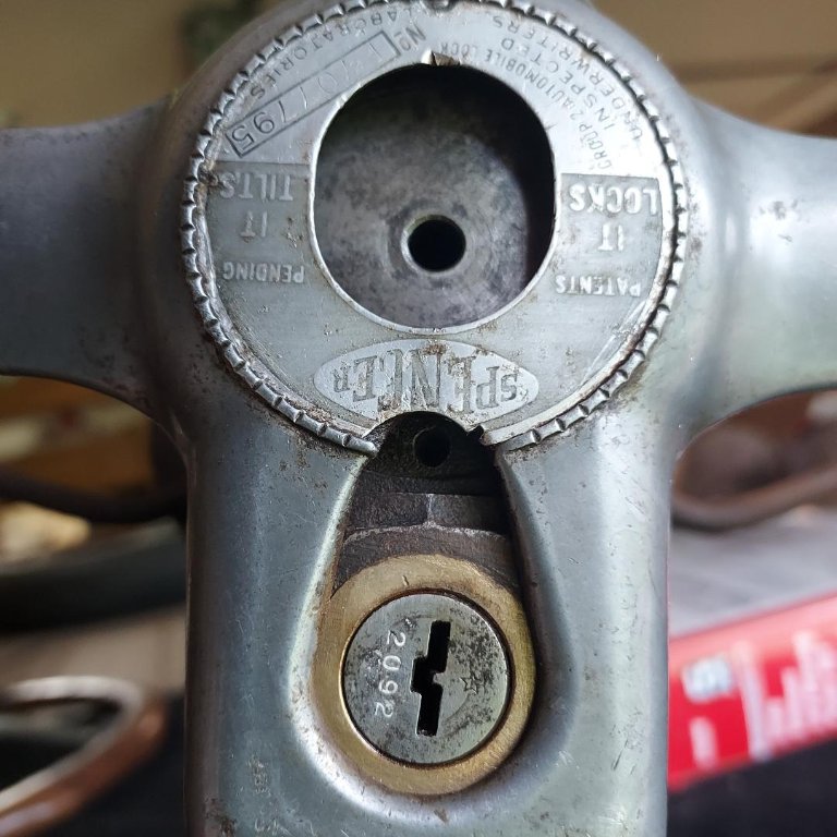

The Chicago Lock Company key is #2092 and should be fairly simple to obtain.

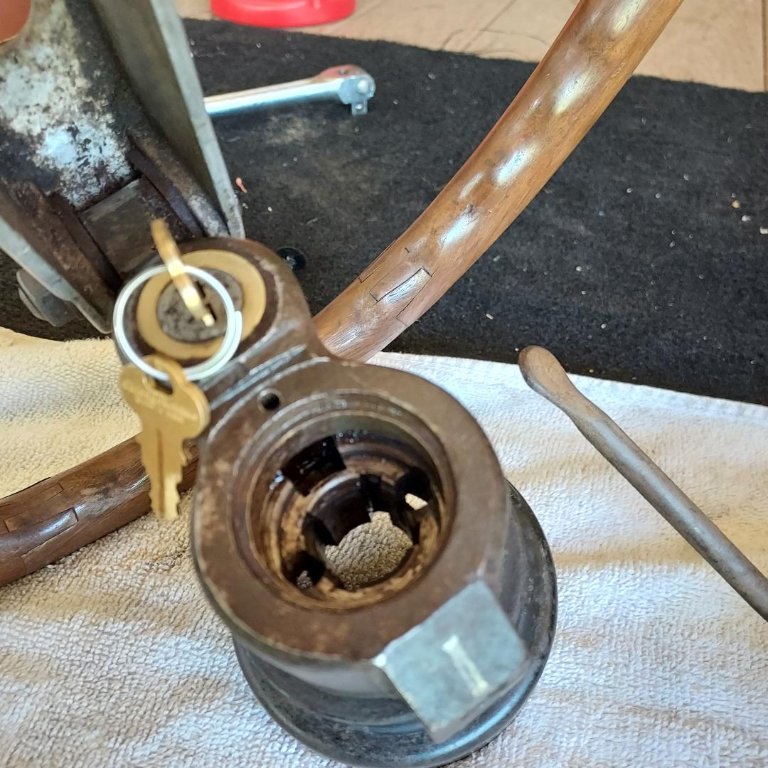

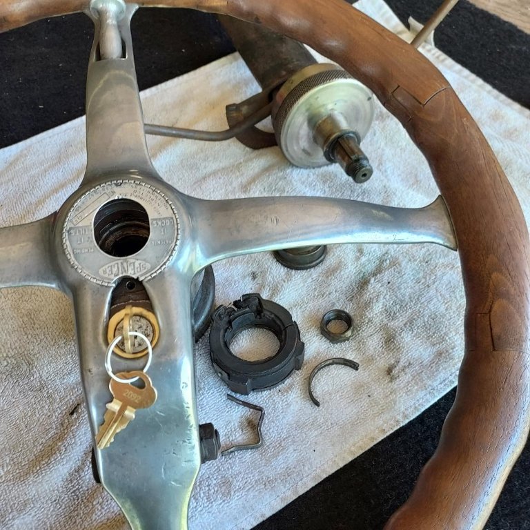

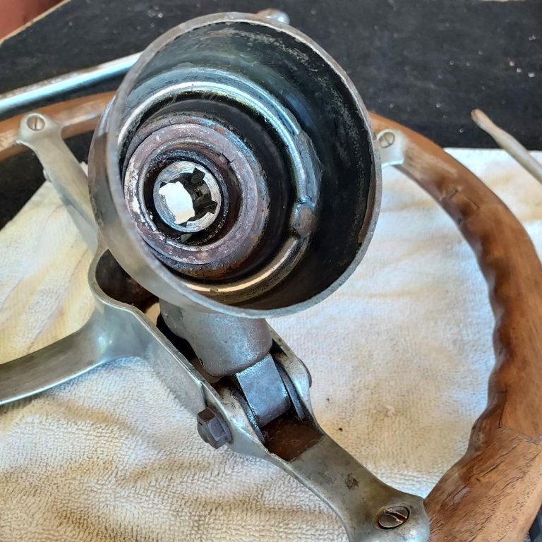

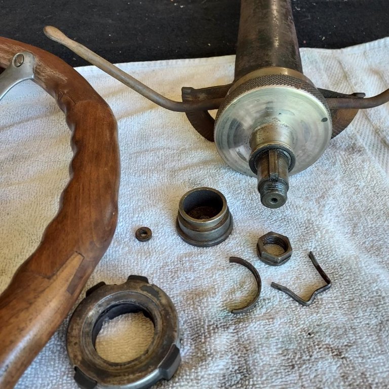

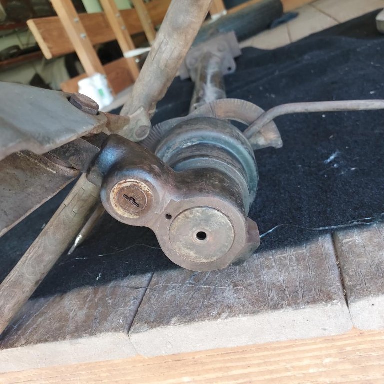

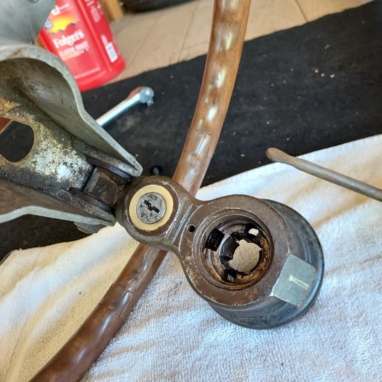

Update: Spencer Fatman steering wheel removal
Post by ModelTSpeedster » Mon May 01, 2023 3:15 pm
Update on the Spencer wheel:
I was able to purchase replacement keys from a company called easykeys and they are a perfect fit. However, they did not make any difference in removing the steering wheel.
Since the horn button is no longer present, I tapped a threaded hole in its place and the center cover came out very easily. A retainer clip surrounding the steering case nut was easy to remove and the the steering wheel was as well.

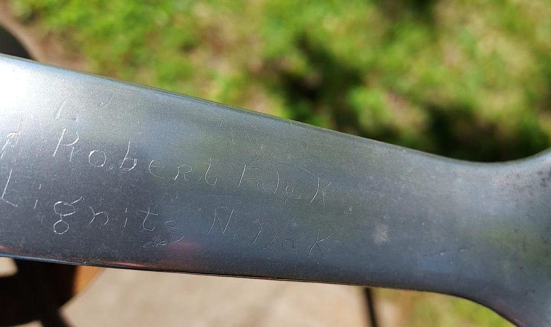

On another note, on cleanup, I found the name of a previous owner inscribed on one of the spokes, Fred Robert Falck of Lignite, North Dakota. A quick search shows that likely family members still reside in Lignite.
