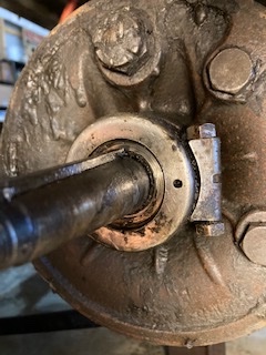

Has anyone ever encountered this type of grease cap? I am assuming that it is an old accessory and not something currently manufactured. Dan

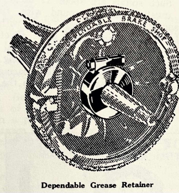

That is an in the day retainer to keep grease off the rear brake shoes, mfg. by Dependable, they also made steel asbestos lined emergency brakes shoes.

Thank You Dan for the information, it seems to have worked and stayed on. Dan
