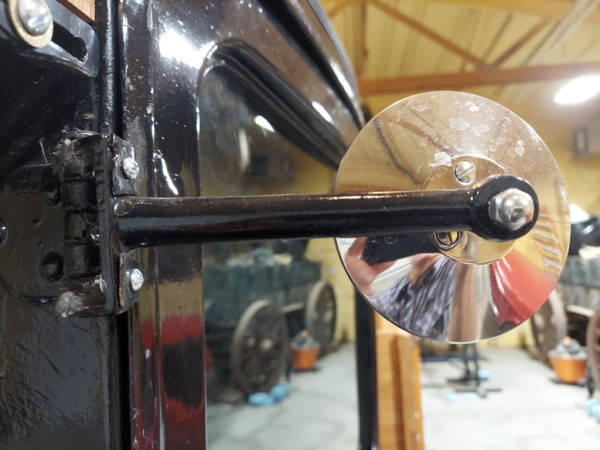

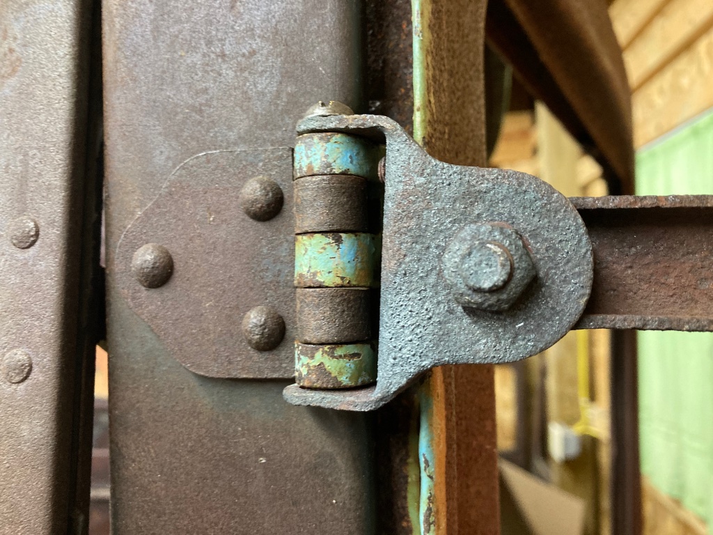

Very few pics on the web of TT’s with mirrors. I would like to mount a drivers side mirror and have had no luck finding one. I like the looks of the hinge mounted brackets but dont like the brace going to the door panel. I have a couple of the extendable stalk type mirrors and can easily fab a “period looking” bracket. I would like to try to find an original first. Anyone have one for pics or possibly for sale?

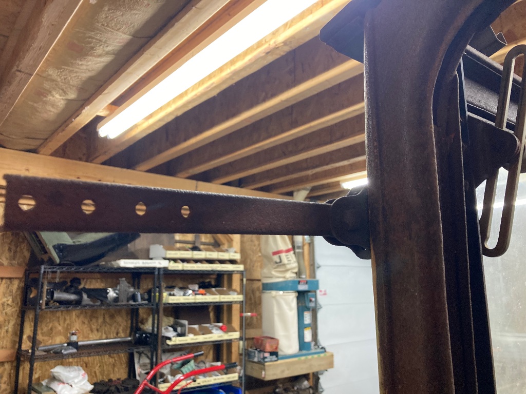

I was lucky enough to acquire an original one for my TT recently. They are very rare from what I understand. Hopefully this is helpful.

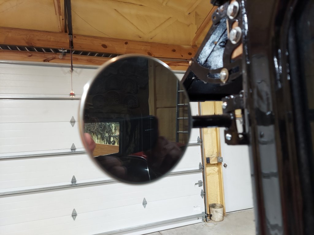

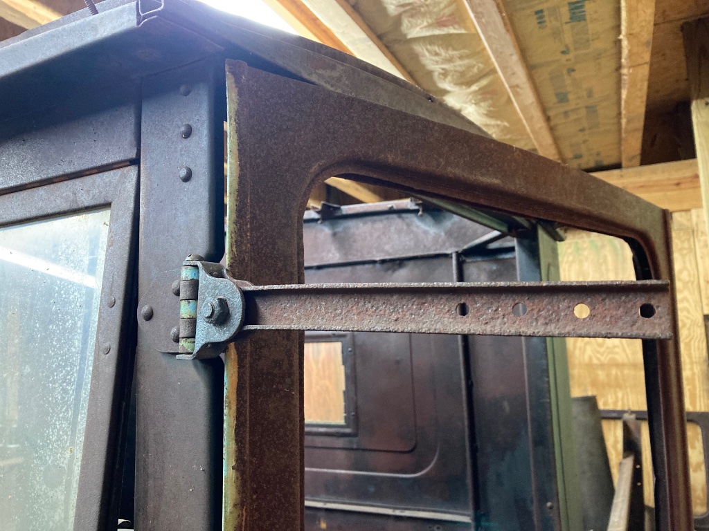

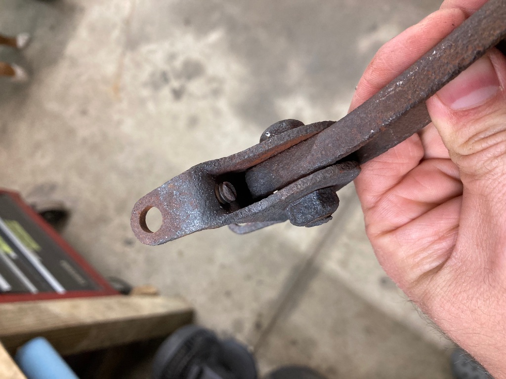

Here’s some pictures with it in place on the truck

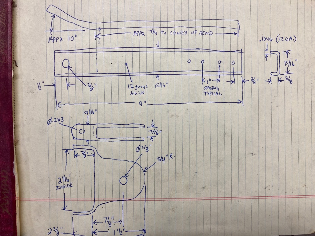

Nathan,
Thanks a million for responding and making such a nice complete drawing! Now, my question is what keeps the assembly in location? I see its mounted on the door hinge ears but I would think clamping it with the hinge pin would tighten the door hinge too much? Is it functional on your truck?

On closer examination of the pics, I see the locking setscrew in the hinge bracket. Is it pointed to dig into the hinge ear?

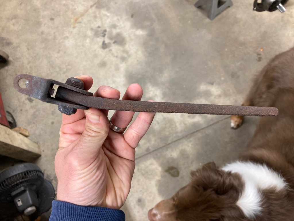

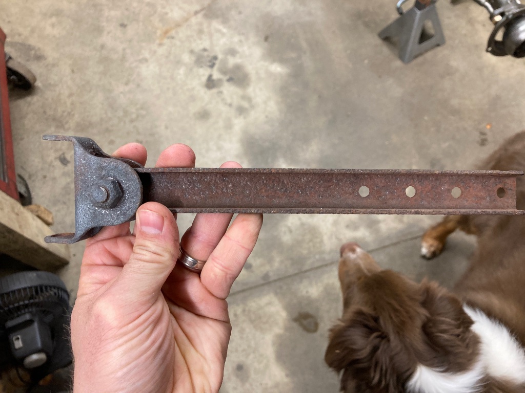

My 26TT had the bracket but no mirror. I bought a mirror from one of the vendors and I can see traffic behind me just fine. After cleaning everything up the bracket wanted to vibrate out too much so I added a small piece of tin to keep it from doing so.

Post by Rod Petrie » Fri Apr 28, 2023 11:26 am

Mike, yes there are two drilled and tapped holes for set screws about 1-1/2” apart, they line up with the door tabs to keep the mirror bracket positioned to the door.

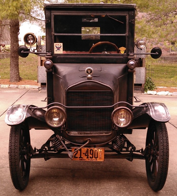

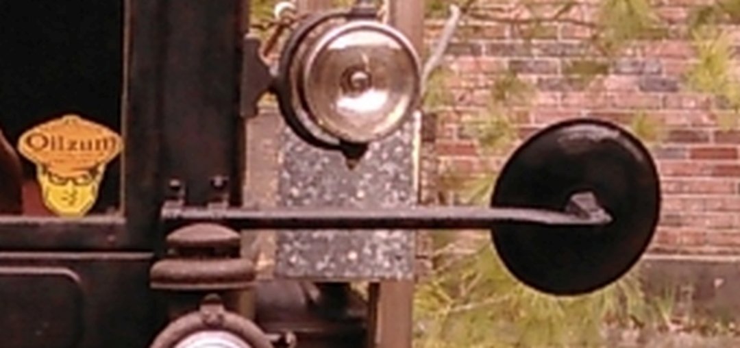

Here is what I did for mirrors on my TT.

Post by BUSHMIKE » Fri May 05, 2023 11:32 am

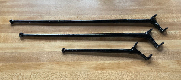

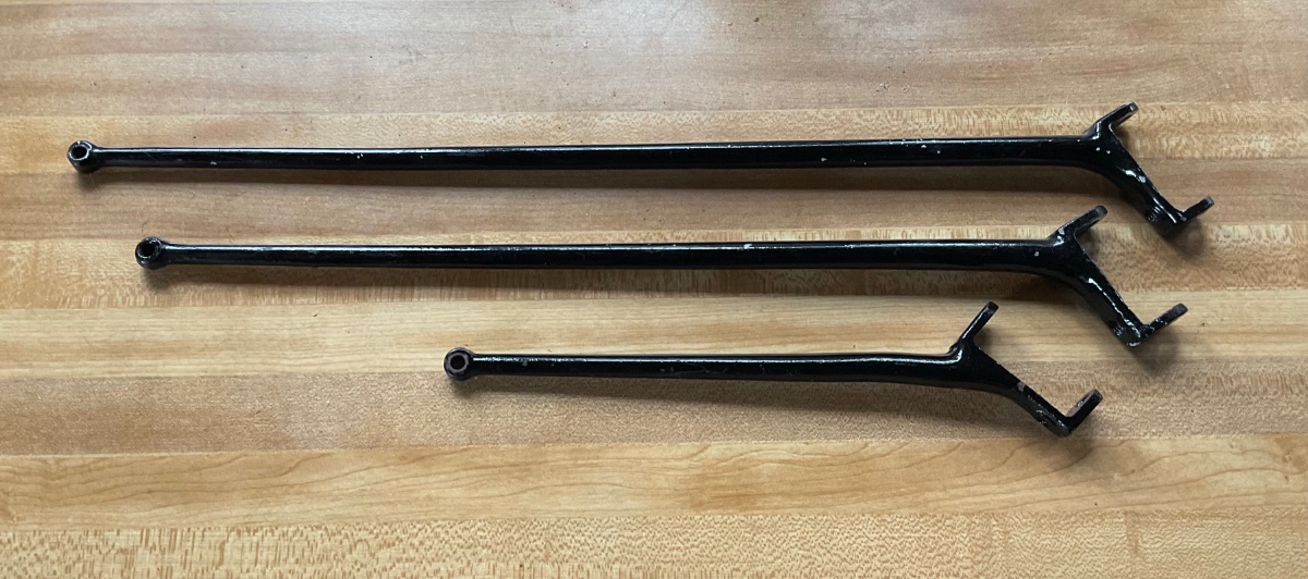

Thank you all for input on mirrors. I found and purchased a set of NOS mirror stalks on EBay that, after confirming some dimensions with the seller, looked like they would work. They arrive today and a quick preliminary fit-up looks like they should work perfectly. They mount on the hinge and have a locking setscrew which I will detent into the appropriate hinge “ear”. The distance between ears is 2” as is the TT hinge. Anyone recognize these as to era or application? Ill get a couple pics after mounting them. They will work until I either find or make a set of originals.
