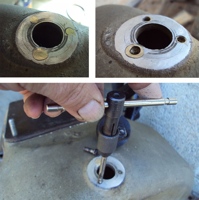

Re: Mag post threads stripped out
Mine were pretty bad. I tapped them to a bigger size and JB welded in threaded brass plugs. (2015) Then tapped the new holes. It has worked fine so far.
