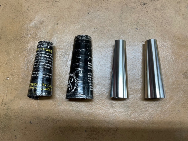

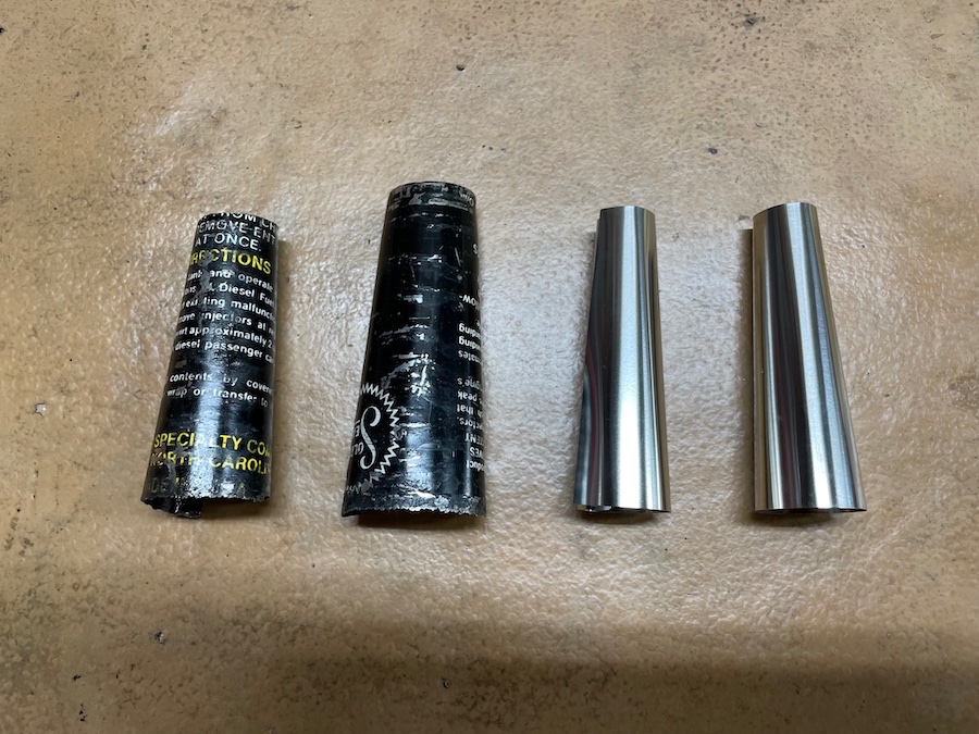

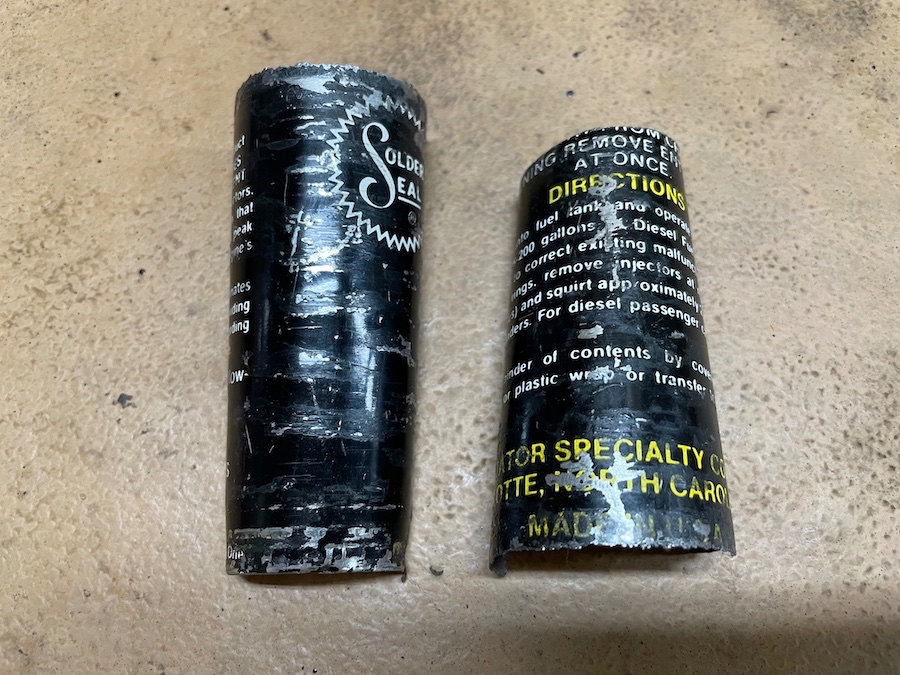

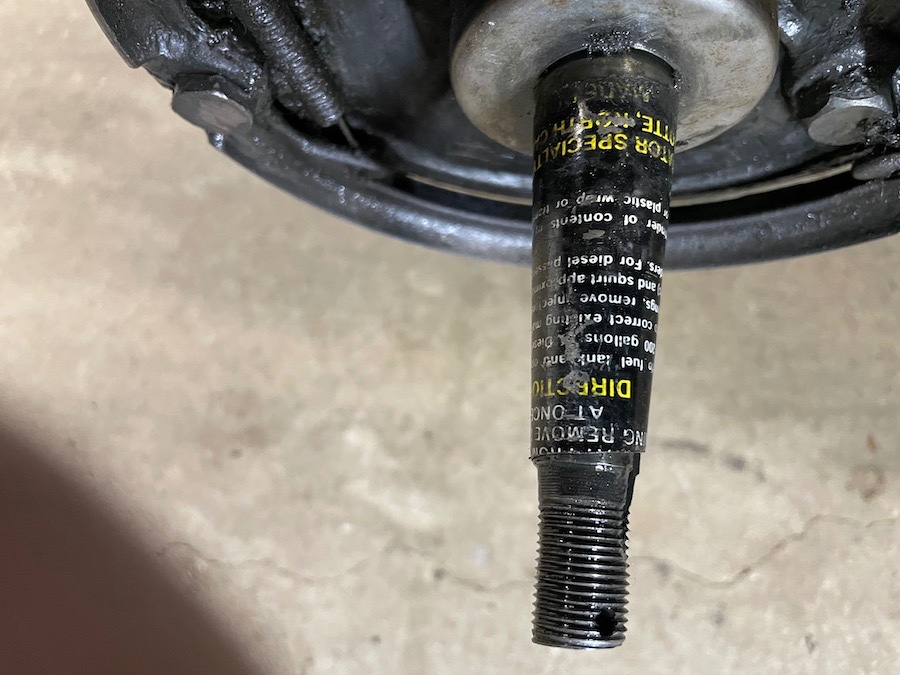

I pulled the rear wheels off my 1925 Roadster today and found these home made axle shims. I just picked up the T in October, and what I could find out I don't think its run since the 60's or earlier. I've done a lot of basic maintenance to it and hope to try and start it in the next few weeks.

In looking @ your axle with the shim on, am I seeing that the shim has been cutting into the seal? That is expected.
I dont like shims as a permanent fix. However, I have learned that using 1 thick shim tends to stay in tact better than 1 or 2 thin shims.

If the car had been run any distance with those shims, there would not likely be anywhere near that much of the print on them.

Does your axle have a left hand thread? Looks odd.
The axles or the hubs, or both, are worn out. The best way to address it is to replace what's worn and lose the shims.
