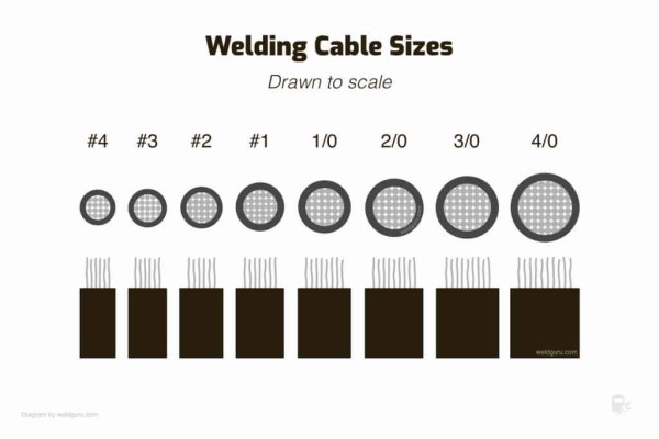

Would it be safe to state that ground and positive electrical cable for the Model T can be mage in house using electric welding cable?
https://weldguru.com/welding-cable-size/

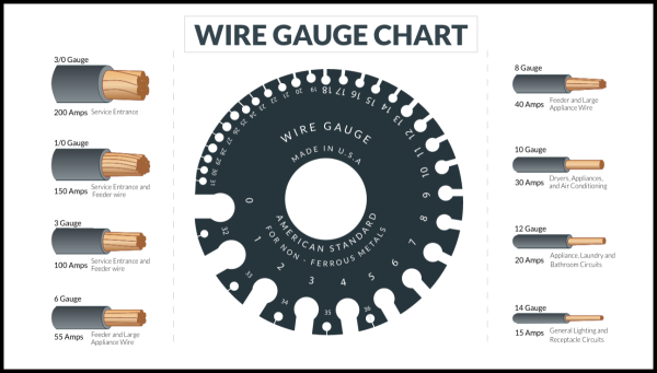

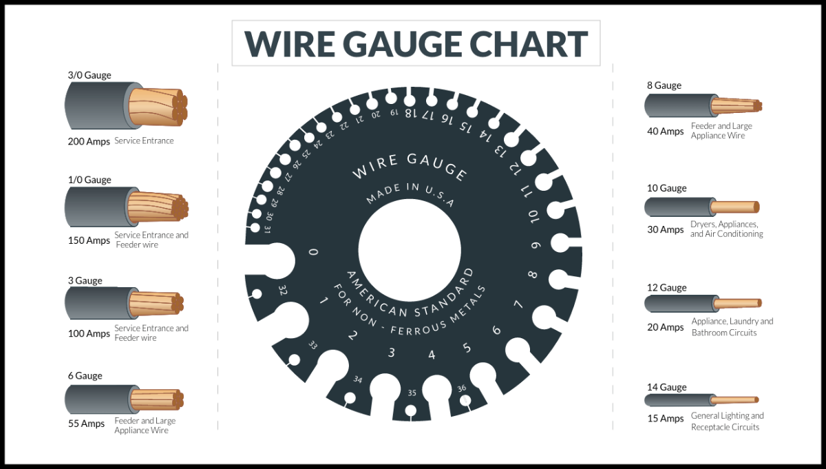

Been Here Before
- Posts: 654
- First Name: George John
- Last Name: Drobnock
Re: Ground wire melted
Ye Gads! Why are we talking wire gage and welding cable wire?! Stop backwards engineering/reinventing the wheel.
Well, From my limited owing a Model T Ford, I have found wire gauges to be standard. As for backwards engineering, I can say that some folks don't like to get their hands dirty.
Reminds me of the time I went into a national parts dealer looking or sparking plugs for an UR Audi Quattro...Bosch equipped I believe...the fellow behind the counter...could not find the Bosch sparking plug on the computer screen and informed me that Bosch of Germany did not make sparking plugs for an Audi of Germany. If it isn't on the computer it does not exist?
I hope the two pics attached will give a sense as to the size of wire being discussed. Yes with backward engineering the welding cable will carry the 6 volts DC, 100 to 200 amp current to start the car.
Using Number six cable....there may be a problem.....
