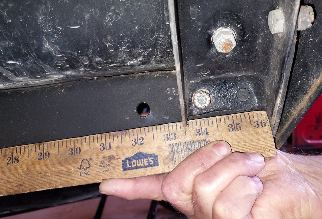

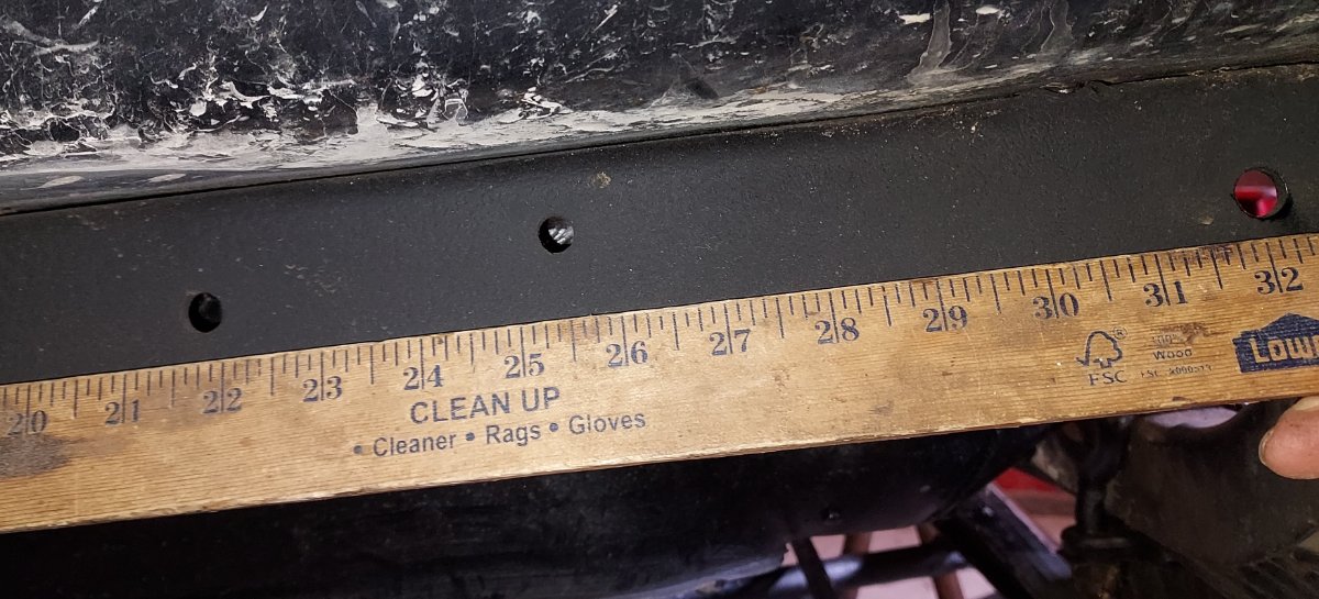

Although the 26-27 Ford bumpers were for the improved car, I don't see why you couldn't use them on an earlier car. The 26-27 frame was made with the holes for the bumpers for easy installation, although no bumpers were actually installed at the factory. The bumper brackets have two tabs with holes close together and one hole near the end of the bracket. The first tab aligns with the fender bracket hole location and is slightly offset to allow for the thickness of the stamped steel fender bracket. I layed some 26-27 front bumper brackets along the frame of my 24 T and I don't see why it couldn't be done. You could use the rear bolt of the fender iron for the front tab, and drill the other 2 holes using the bumper bracket as a template.
Attached are pictures of a 26-27 frame. The yard stick 36" mark approximates the front of the frame. The bumper brackets first tab hole will use the frame hole at aprox 34" and 32". The third bumper bracket hole in the frame is at aprox 22". Ignore the hole in the frame at 25.5", my car is Canadian and the frame has factory holes for left and right hand drive and that hole is for a RHD steering column lower bracket.

Thank you!
Using the fender mounting holes answers the question perfectly and it makes so much sense.
