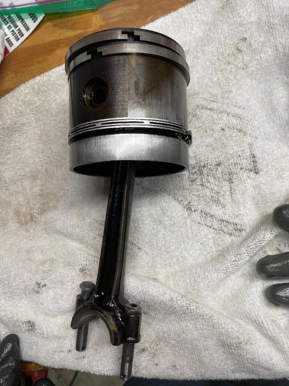

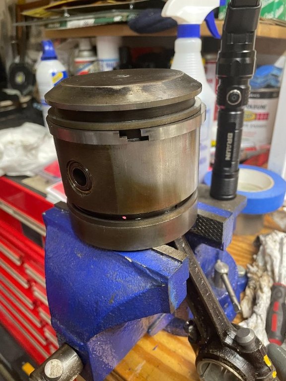

I've been working on my T for a while and just when I thought it was ready to be driven, I hear a knock. With a stethoscope I believe it is coming from cylinder #1. I pulled the #1 spark plug and it is oily. All other plugs were dry. Initial thought is a cracked piston ring. Took the head off and the #1 piston out and the pistons are intact. I measured the bore and is straight.
BTW, I tried to get the top ring off and broke it so going to have to replace the rings anyway.
My questions are:
1. Could improperly seated rings cause a knock and allow oil to pass through?
2. What else could it be or should I check?

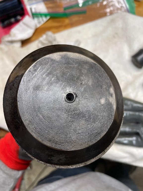

3. The top of my piston, which is iron (tested using a magnet and it sticks so not aluminum), has .005 stamped on it. Do I order standard size rings or get .010 and file down?
Additional info: I recently checked to see if the rod caps are within tolerance and they are all good.
Appreciate the help! some pics of the suspect piston:
My questions are:

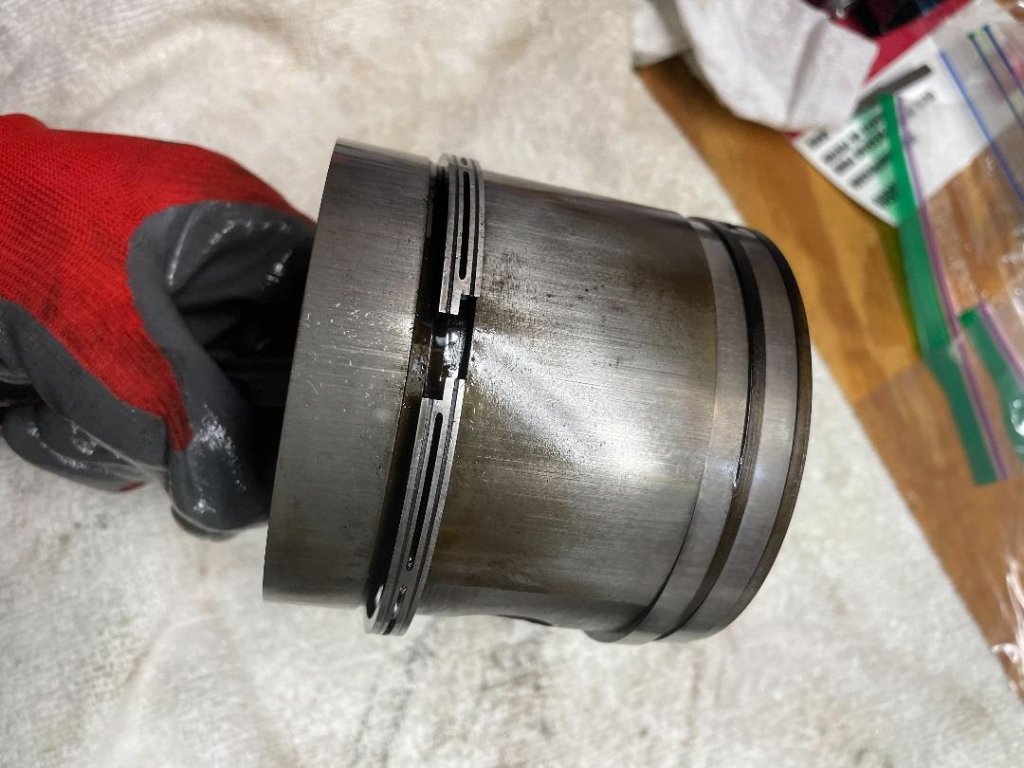

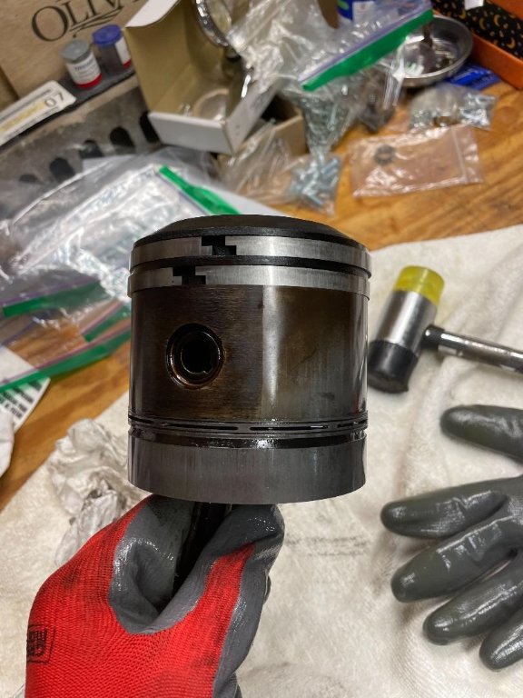

Was your knock on acceleration of when going along at a constant or slightly slowing down. Main knocks or piston slap tend to knock on acceleration. A rod knock when going along at a steady pace or slightly slowing. A wrist pin knock can be a double rapping sound. Caution, if the center main is worn, do not tighten it because it could cause the crankshaft to bend leading to metal fatigue and broken crankshaft. The center main usually wears at the top in the block caused by the weight of the transmission pulling down on the back of the crankshaft. This can be caused by a very worn 4th main at the rear of the transmission or by a bent crankcase
looking at your pictures, it looks like the ends of the rings are on the same side of the piston. This will cause some oil to work it's way through the gap and into the cylinder. They should be on opposite sides of the piston so that any oil leaking by will be wiped off by the next ring above it.

I did a compression test and all 4 cylinders were at 50 if I recall correctly, including #1. You are correct that there is a .005 on the top of the piston. #2 and 3 have .010 on the top and #4 has .005. I don't recall if the ring gaps were in the same place when i removed the piston.

Given that the piston is .005, which size ring set should I get?
- Posts: 5545
Re: Riddle me this Batman!
Personally unless you are doing a full rebuild I would do a quick hone on the cylinder(s) and use the rings you have. If you go that route, maybe someone can send you a standard size (maybe .010 os if they have one) and reassemble. If your head gasket looks ok, clean it and use copper coat. These are low compression/rpm engines and think some go overboard changing things.
- Posts: 8643
Those don't look like Ford rings to me. If they aren't, you may have trouble matching them. 005 is an odd oversize. You may have non-Ford pistons, also.
.010, .020, .030, etc are much more common.
Assume nothing. Before buying anything, measure everything and determine any corrective action, such as honing or boring, that may be needed before installing any new parts.
A new set of aluminum pistons in a common oversize, with a matching set of modern style rings is probably the best path forward, assuming the crankshaft and other critical parts prove to be good condition.
I doubt if a piston ring caused your engine to knock. The carbon in # 1 cylinder could be due to a number of things, including something as simple as a shorting plug wire or a dirty spark plug, too much oil in the crankcase, a timer or timer wiring issue, a problem with the coil or coil box, or simply not having been run down the road in a while. A sticking valve is another possibility that copuld explain the carbon/oily deposit and the knock. As far as that goes, the carbon/oily deposit itself could have caused a knock.
Regardless of the universe of possibilities, tearing into the engine is not the first thing to do.

I would like to avoid a full rebuild unless it’s the only path forward. Since I broke a ring and have an odd size piston, .005, I’m guessing my best bet is to purchase a .010 and file the gap?

Check the cam for end play and colliding with the bearings. I don't remember a oily plug ever knocking? I have not seen .005 rings lately so .010
will be your best bet, if your bore will not accept .010 pistons. Look at every possible issue to be sure.

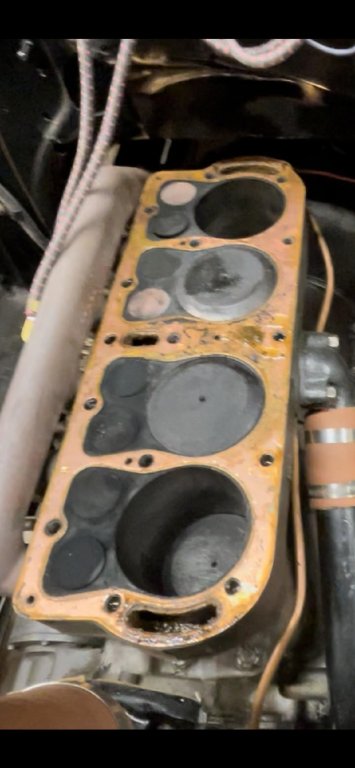

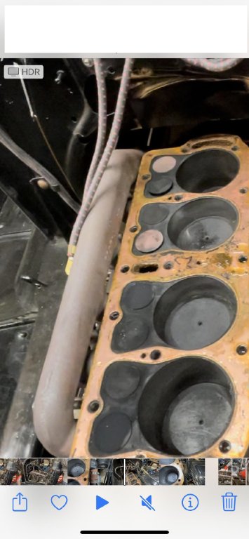

This is a pic of what it looked like when I first pulled the head off. Not sure if this provides any more clues to the problem.
- Posts: 6800
at first blush, it appears that you may have had a bad intake manifold gasket, causing front two cylinders run a very poorly combusting mixture...not intuative, but it was likely your rear intake running lean, causing you to run a very rich mixture which fouled #1&2.
as far as knocking it would be one of a myriad of issues, but finding it will be very very difficult on an engine which is not running. Too bad, as I've found most T's still running cast iron pistons are very sweet running cars.
If I was to ever design a head for a Model T, I'd have the phrase "NO, IT'S NOT UNDER HERE!!" cast into it to help prevent people from pulling the head at the first sign of trouble.
- Posts: 8643
A misfiring plug can lead to excess soot and carbon deposition, which can lead to a piece of carbon getting loose and mashed between the piston and head, which can cause a knock.

Scott's manifold leak fits.
If only one cylinder was black I might test the plug under pressure to make sure its firing consistently.
