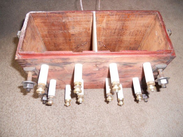

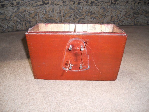

Larry, These are pictures of an original KW coil box you posted in 2019. Not sure if this is the one you referring to. The box looks good but the wires look questionable. Have you inspected them recently or replaced them?
