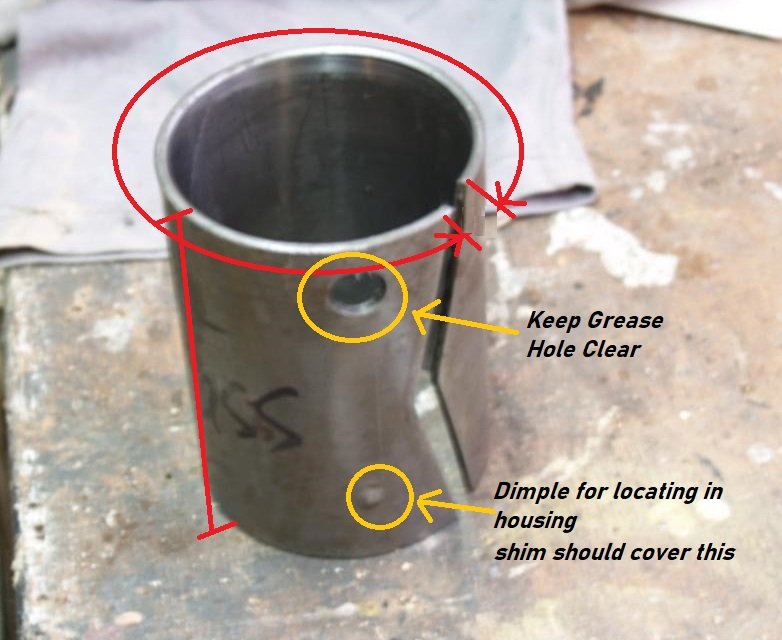

Mike, when installing a shim (once you have the right size) make sure you have a hole punched in the shim to match up with the grease hole on the sleeve (or you won't be able to grease the bearing later).
I clamp large 'jubilee' clips (hose clamps) around the shim and sleeve to squeeze them down and hold them tight to make installation easier. Slide the clamped shim/sleeve in the housing and release, move the clip out a bit and re-tighten the clip bit by bit as you slide it in bit at a time. Oiling the outside of the shim before hand helps.
This IS a fiddly step and can be a pain. I have sometimes had to have 2 or 3 tries before I get it in without ruining the shim, but patience will be rewarded.

Is your shim almost full circumference of the sleeve OD?
- Posts: 1219
- First Name: Adrian
- Last Name: Whiteman
Re: TT Axle Bearing Sleeve dims?
Hi Mike,
Yes, it is a full 'wrap' but with the ends cut in a chevron to match shape of the sleeve, just a shade shorter.
As the shim goes right around the gap it closes is twice the thickness of the shim.
It is also the full length (or width?) of the sleeve as well.
