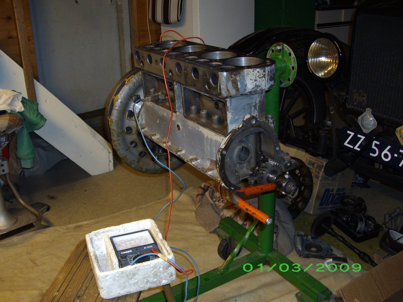

Mike ; As soon as I mounted the Coilring and Flywheel , I test the mag output . When I crank as fast as I can, then I have about 3 1/2 V AC .

Just checked. Looks like just over 2 volts with hand crank. May not be a good mag, but likely is a functioning mag. Thanks
