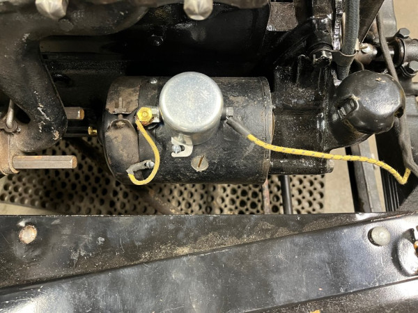

I do not have the headlights or taillight wires hooked up, I grounded the generator, I think I read you should do that if it bad and I don't know if it's bad. Now with the key on battery I have 6.24V at the coil box but the coils don't buzz

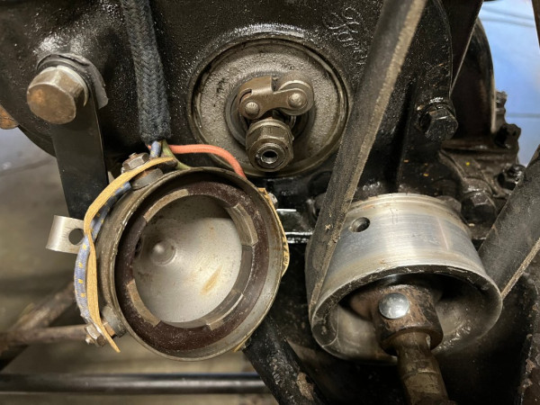

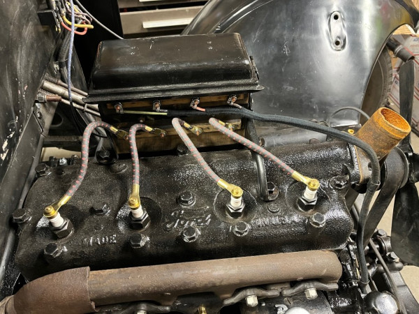

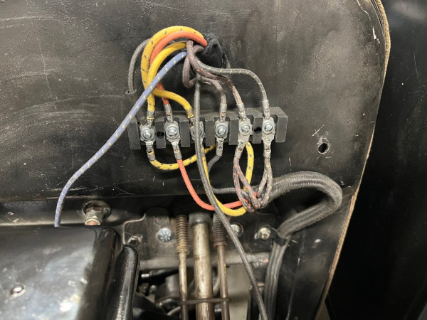

Disconnect & tape off the cut out wire, in case you have a cut out issue for further testing.
Is your timer roller secure. Does it turn when you crank the engine.
You can manually ground each terminal from the timer on the coil box. You should get buzz on each. That would pin point a timer issue without removing the timer. Did you do the "pack it full" thing in the timer?

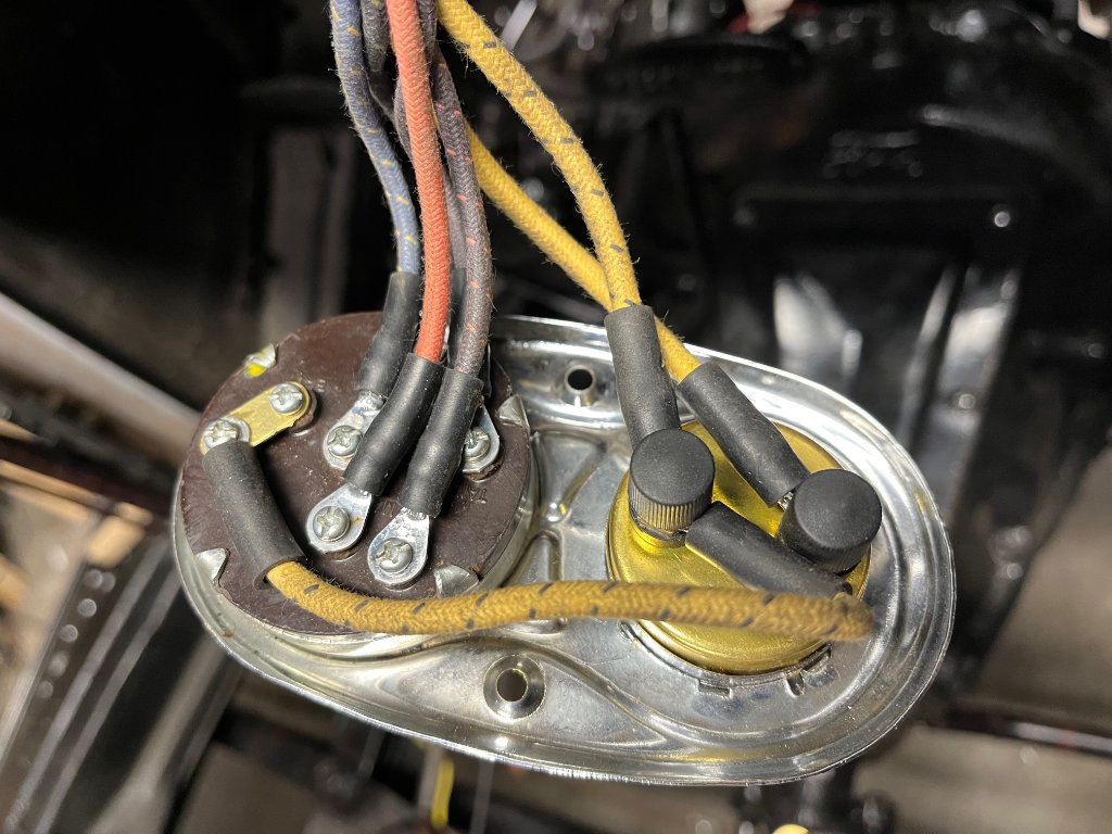

Is your ammeter wiring correct? I dont recall 2 wires on any terminal.

The timer provides a common electrical ground for each coil in turn as the camshaft rotates. If there is a problem with it, it could prevent any of the coils from buzzing, even with good battery voltage at the coil box. Cranking the engine by hand with the fuel shut off and timing retarded should allow you to hear each coil to buzz as the engine is cranked through 2 complete revolutions with the key on BAT.

Slow down and go through all of your wiring connections again. I don't recognize the ground connection from your cutout to the generator case. That ground wire is usually there just during the shipping of a rebuilt generator and is removed once the cutout is installed.

Well damn, when I got this car it had a distributor and I added the coils back in so this is my first experience with coils, from watching all the videos of how to start a Model T I believed the coils always buzzed and the timer just connected the coil to the spark plug at the correct time.
Sure enough cranking the engine over by hand I can here each coil going in turn, another duh moment for me.

You have the yellow-black wire from terminal #1 connected at J instead of K, but that should make no practical difference. Here's the correct wiring in case you want to check everything.

The car does not need to be pulled it has been run in at my place, I see a ground wire on the generator, better remove that since power is going into it from the other side, the ground wire is there only to short the generator if power is not supplied to it. Crank it by hand and listen for every coil to buzz take the coil box cover off to verify, if all four are not buzzing then it is in the timer or the coil box. Hope this helps! Joe

I timed the roller style timer with the timer gauge and found this to be way off, the No 1.coil would buzz when the No 1. piston was 1/4 to 1/2 down from TDC.
