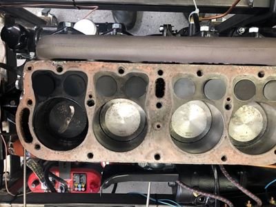

I got a complete rebuild motor. I put the motor in a teststand to run the motor to see that the motor is running fine. After about 10 minutes run (motor is running fine), i removed the sparkplugs. The sparkplug from the first cylinder was complete black with a oil film. The others are fine. So i removed the head and i found this:
The Pistons are Aluminium with 0,040 oversize.
Than i start to investigate what is the problem. I removed the first Piston to see where are the gaps located from the Pistonrings. That was fine.
Then i checked the installation direction of the piston (Wrist Pin goes toward the cam. The slot in the Piston goes away from the Cam). That was fine.
Than i started to measure. Here are the results:
Top Pistonring 0,026 Gap
Middle Pistonring 0,022 Gap
Oil ring 0,020 Gap
Gap from the piston rings in the piston groove 0,002
Piston: Diameter from the Piston bore 3,791.
When i put the feeler gauge in (Piston in the piston bore without Piston rings) there is a Gap from 0,008.
I will now remove the second piston to measure it.
what is your opinion?
Markus
