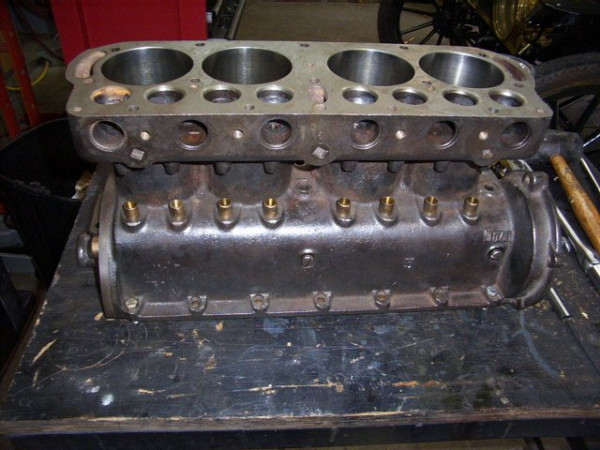

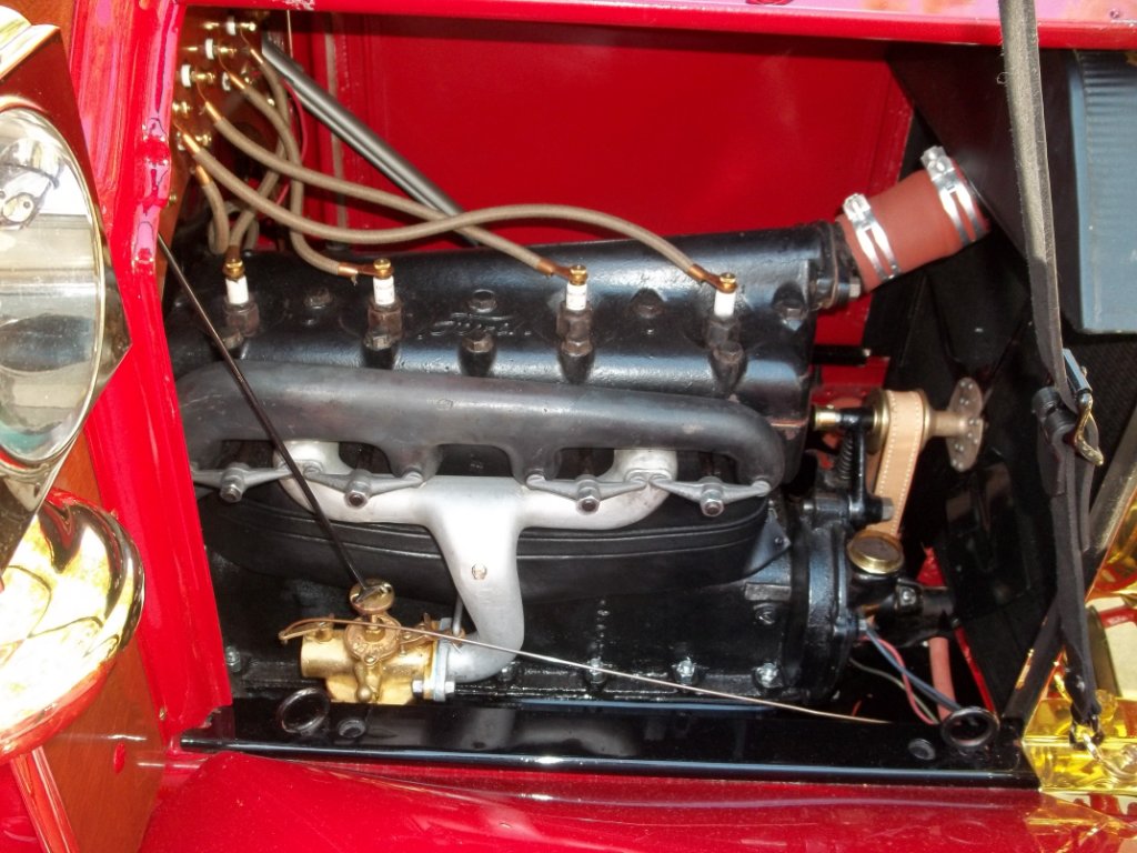

Help a newbie!…..Pray tell….what is an open valve engine….
Posts: 6825
Re: Open Valve Gallery Engine
Post by Scott_Conger » Wed May 03, 2023 12:02 pm
Posts: 6825
Post by Scott_Conger » Wed May 03, 2023 12:09 pm

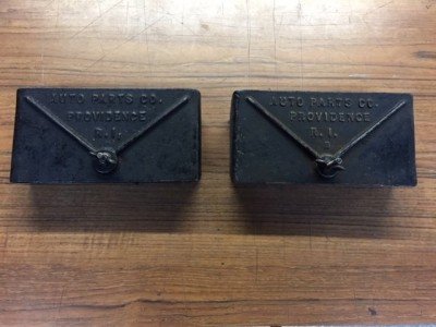

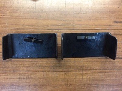

and for the very discerning motorist (Russ!) some pictures of rare accessory covers (photos courtesy Mitch Owen):

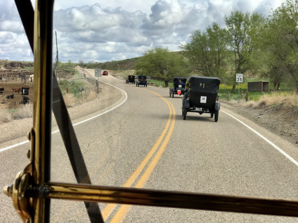

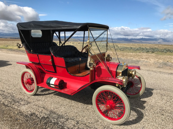

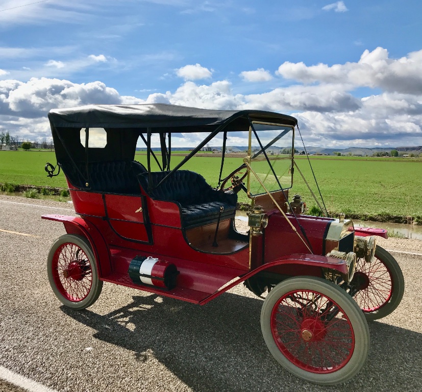

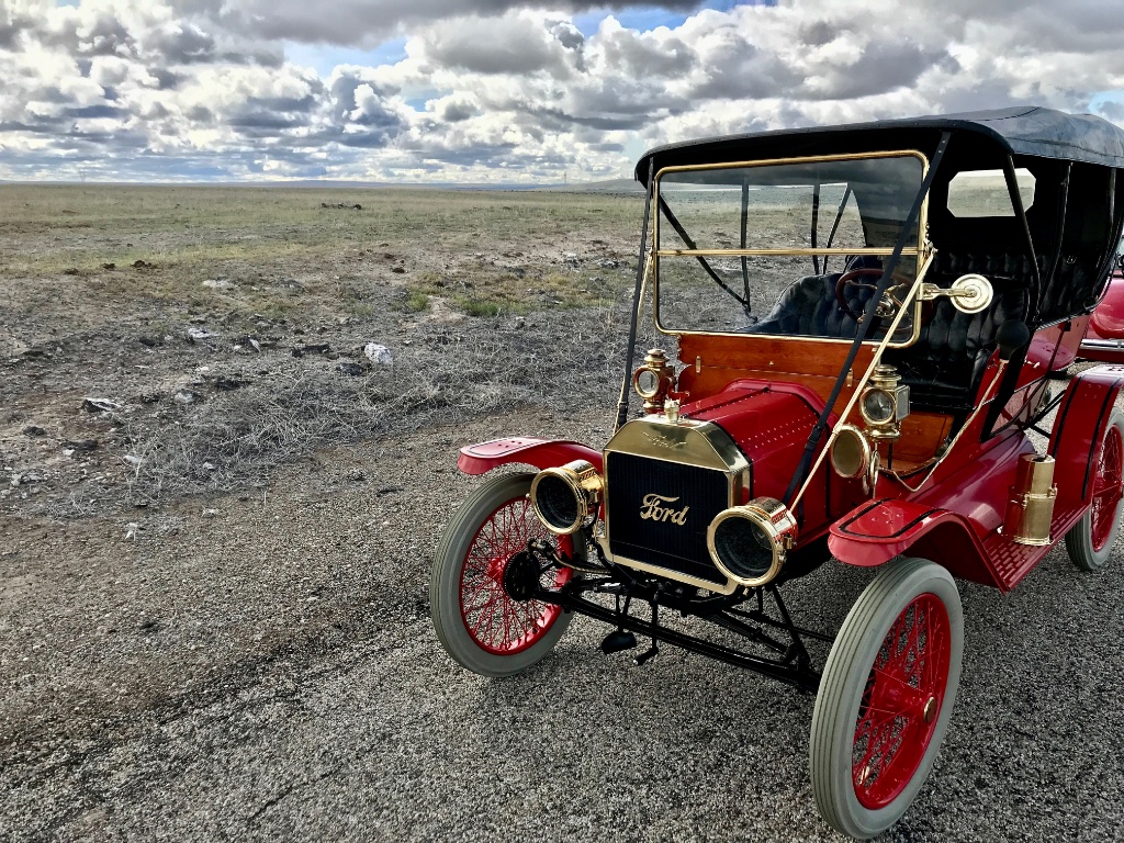

I took my open valve T for a nice drive today 50+ miles, over flatland, hills, and wonderful Idaho farmland roads with the Western Idaho Model T Club. My T chugged right along at a nice clip, though I must admit I have a Warford installed to give my engine some compassion. Yes, I have oil that leaks here and there, but nothing major that doesn’t get cleaned up with a rag when the ride is over. Replace the engine with another and put my open valve out to pasture? No way, for this is living.
