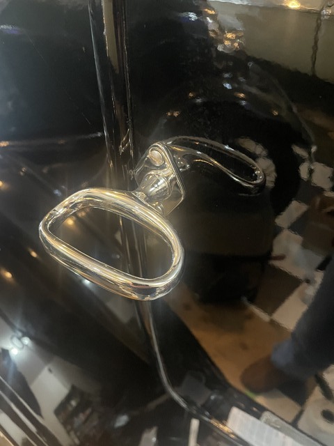

I had my door handles nickel plated last year. I used a local place, Denver, to get it done. Ajax Plating 1423 S Broadway. 303 777 8930.
Not real convenient for you but he does shipping also, I am sure, if you cannot find anyone else. $100 for the 4 parts. About a 3 week turn.
Before
After
Good Luck!

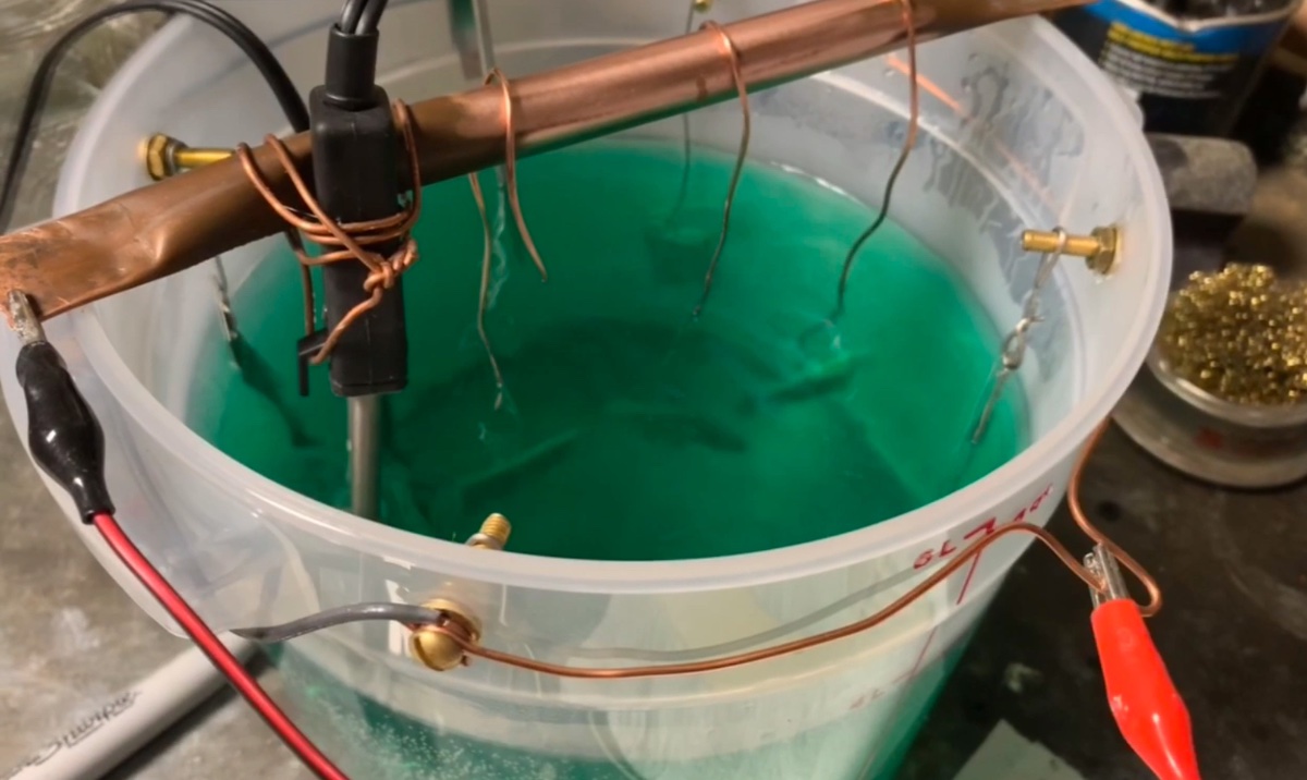

If you’re interested in doing it yourself I can help you. I made up a small tank and all the supplies are available on eBay or Amazon.
