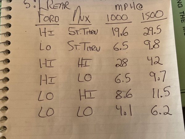

This chart is where I was headed with this whole ratio exercise. I just wanted to know the expected range of MPH in my Twin-High TT. I believe the math is correct because the proportions coincide perfectly with the advertising literature stating 33% overdrive and 66% underdrive. For those with high speed TT rears, do my straight Ford numbers look ballpark? Its looking like my intended/hopeful 20-25mph on Forest Service roads is quite realistic.

Looks pretty much 'in the ball park' to me.
On the road you will find certain gear combinations are 'good' and some you will avoid. Not sure why, but I find some work and some don't depending on the road and I guess the 'fettle' of the engine.
It is fun sometimes to work up the ratios like a semi, my 8 forward options (Ruckstell and axillary over drive combinations) sound cool but requires a lot of lever (x2) and pedal gymnastics :-)
