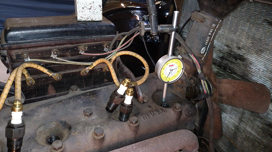

Edwin, I did what Adam suggested a few weeks ago with success. My head was off the engine to make the process easier. However, when I adjusted my timer, I made an offset tip for my dial indicator where I replaced the normal tip with a properly sized piece of wire. The wire was bent in a Z shape. The tip goes through the sparkplug hole and against the top of the piston. I could see making a smaller Z that could rest against the valve with the head still on. It is worth a try if you have not removed your head.

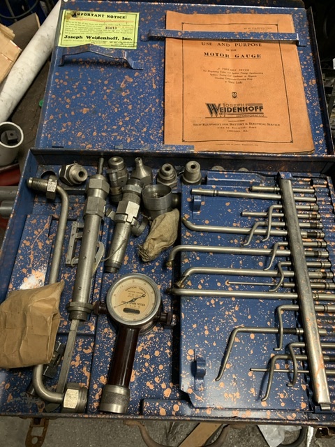

Here is how piston position was found back in the day

Re: Calling all T Gurus
Thank you, Dan. I looked for that photo you posted a while back but could not find it. I can see how one of the offset parts on the right could be used to measure valve lift too. I made one for my dial indicator.
