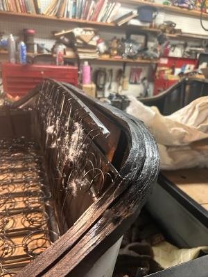

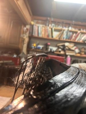

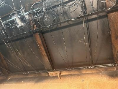

I have a new Uphostery kit from Langs I had ray, Wells rewood the body and there were no springs when I got the car i believe the back rest looks weird compared to most springs I've ever seen the top of the Spring has sharp edges on the end and I don't know if I am supposed to staple the top down against tack strip , or leave it loose nothing in the instructions says anything about it. I will try to send a picture of the spring, did not work,to show you what I mean, but should it be secure on top like it is on the bottom I would appreciate it if someone has done this I found this problem before would let me know. Thank you. Have a nice day. Enjoy T in

Could you post a picture of the spring and of the body where you want to attach the spring? Hard to understand what you mean by sharp edges. Do the instructions from Lang's describe the situation? I know that some seat springs, that is the one which goes flat at the bottom have an edge that you crimp around the upholstery. Would you by any chance have the seat spring confused with the back rest? It has been a long time since I upholstered a T but it seems to me that there were some straps to pull the top of the spring back toward the body which held the top closer and then the upholstery went over that.

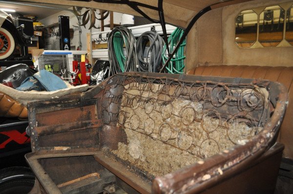

I can't speak specifically on 1914s, but on later year cars the rear seat back springs were hung with strips of seat material looped around the spring and tacked to the wood sill, like this:
