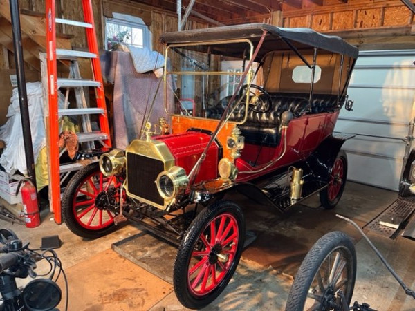

Finding good coils for a 1911 Model T is the problem, now that R V Anderson no longer makes them.
A friend has a car that looks like new and he cannot drive it with two coils!

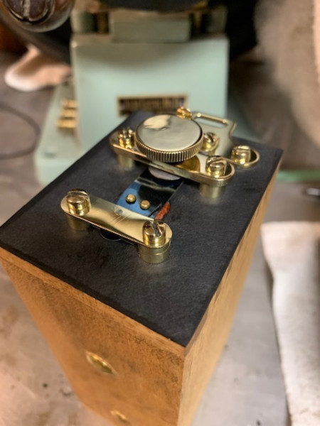

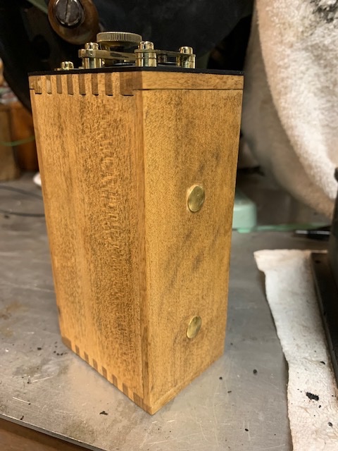

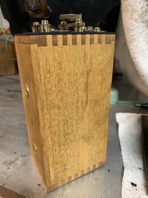

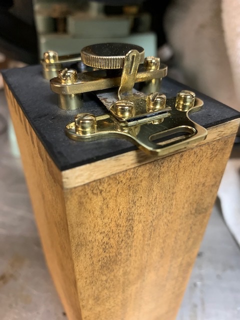

Just FYI, I started making and repairing Kingston coils.
I attached a few photos. Happy to help.

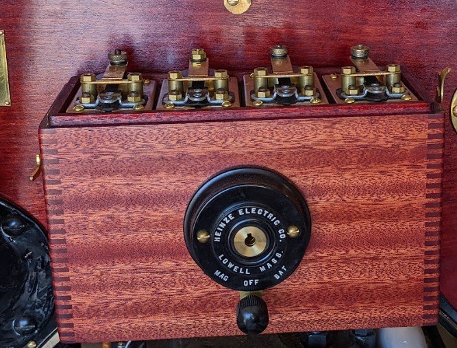

I modified KW type coils to fit and function in a Heinze coil box. I can run either original Heinze coils or my modified coils.

After removing the capacitor, I cut the dovetails 1/4" deeper then cut the ends off.

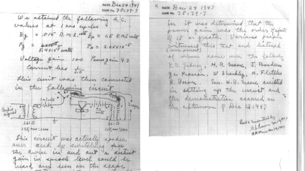

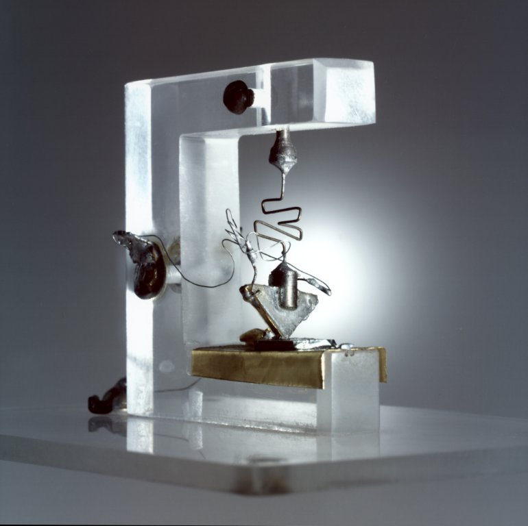

"What, pray tell is an "original transistor"? "
So this discussion is showing that the Ford Tremble coil was being made smaller.
I guess it makes sense imagine if the original transistor was not downsized?
Imagine the size of the electronic version of the HCCT?
https://www.bell-labs.com/about/awards/ ... sics/#gref
Putting the hobby back another 60 years (c).
