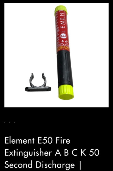

But reviews are good on what I carry on tour, the little Element stick. Magnet mount behind my seat back in the 27 touring, easy reach and grab. Strike it like a flare to operate, no residue but smothers fires. Last 50 seconds, way longer than a 2lb typical unit. I fired off some out of date 2lb cylinders and was surprised they exhausted in a very short 10 seconds.
The Element E50 is pricey , but so is a Model T !
