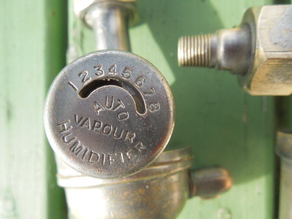

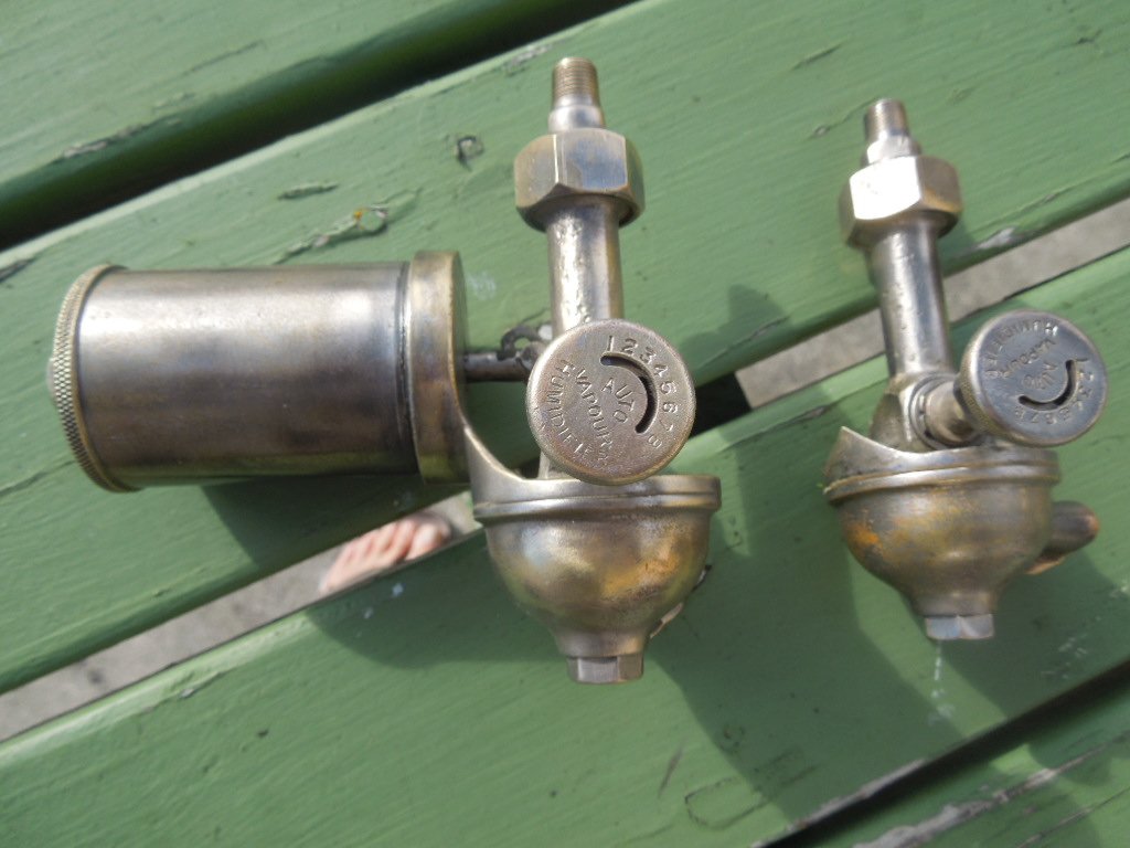

I picked 1.5 of these at a swap meet yesterday. It had a Model T sticker on it not that it means anything.
I guess they are a period accessory to improve economy/performance on any car at the time.
Has anybody tried one?
[attachment=1]DSCN4096.JPG[/attachment]
[attachment=0]DSCN4099.JPG[/attachment]

That's a new one for me, but I'll take a guess. I would say the intake manifold has to be tapped and threaded in the central part of the Cross piece, this unit screws into that manifold and the what looks like a threaded cup attachment to this piece could be filled with something like marvel mystery oil or even just plain water just for the purpose of eating better combustion in the cylinders.

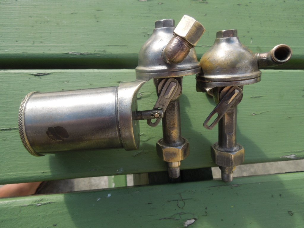

No, I think it goes in the fuel line. Sorry first pics didn't show the other pipe. It has a inlet and outlet.
[attachment=0]DSCN4097.JPG[/attachment]

I am going to suggest that one of the fittings is probably for a vacuum fitting and that it has a dashpot arrangement to vary the water going into a manifold. This era was rife with humidity/water injection devices. I have never seen any kind of device which delivered water or any other liquid into a fuel line...
carburetor - yes; manifold - yes; fuel line - no.
Since it says "Auto Vapor Humidifier" I think you can take their word that it humidifies vaporized fuel (not raw fuel) and thus mounts to an intake manifold via the NPT fitting.
It's a fun gizmo which has little practical use other than to probably double your gas mileage or some sort of other similar promise that these things typically came with. Too bad the one is broken.
Whether I'm right or wrong, I am hoping that Jay, Dan or someone has some period literature that will tell you (us) what it really does and how it does it.

That looks like the Vix Humidifier that was advertised in Popular Mechanics magazines in the 1920s and 30s. It drew water from the cooling system and injected it into the intake manifold.
