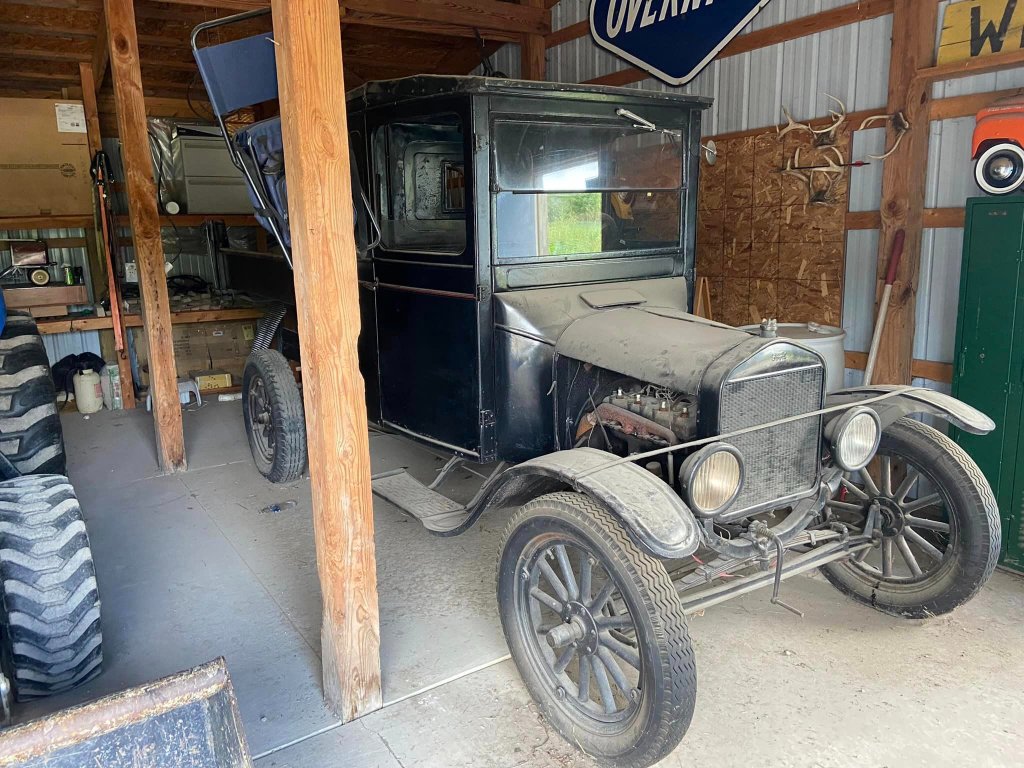

Well, with the wife's 26 touring coming close to being on the road, it's time to get back on the TT. I was sold this truck as a 27, unfortunately the title never appeared, but that's another story. Anyway, the block stamp is a 23, the frame stamp is a 26. The transmission is a 26/27, wide brake drum and the two mounts on the top corners with brackets to each frame rail. But along with the 23 stamp on the block it has a steel firewall with all the holes for the coil box, coil box is mounted on the head 26/27 style.
I'm thinking maybe a 26 chassis and transmission with a replaced cab and engine?

I think the cab is also 26-27, along with the rest of the chassis. I believe the 26-27 TT used the 24-25 high firewall. The only steel cab Ford supplied in 1923 was a C cab.

So they still used a firewall with holes, just didn't use the holes. That would make sense then that just the block/engine was changed at some time.

1926 TT: High firewall, empty holes, coil box on engine.

That does look like it Steve, so cab is likely original, just the motor replaced, thanks.

The 26-27 TT has most of the pre 1926 TT features, same cab, same fenders, same hood and radiator shell, etc. The few 26-27 features that are noticeable without having to look too hard are the oval ignition switch, longer boot scraper running boards, and the 26-27 improved T engine. The firewall has holes for a coil box because the 26-27 TT has a firewall mounted coil box, just like the earlier TT's and T's. I would recommend retrofitting a 26-27 engine someday because it is better than the earlier engines and transmissions. Good luck with your project.
