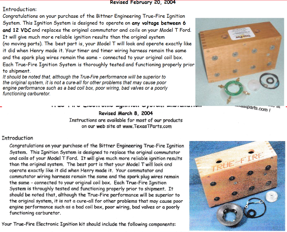

Thought about it long ago & so I copied the instructions
Congratulations on your purchase of the Bittner Engineering True-Fire Ignition
System. This Ignition System is designed to operate on any voltage between 6
and 12 VDC and replaces the original commutator and coils on your Model T Ford

I have a version of the instructions (that maybe from a later manufactuerd dated "Revised March, 2004." indication 12 volt only. (See attached) The extra unit has a"IGBT 60-12 V" on the bootom, I'll have to go to actual T and see what's there (if anything) fingers crossed.
Thanks for all the imput.
Ross
Ross

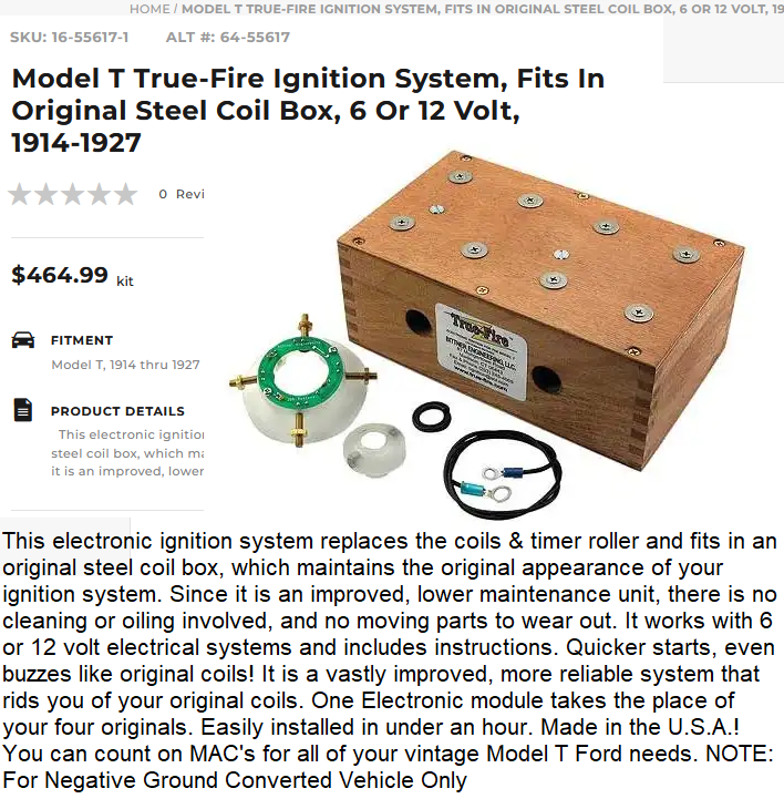

The revision dates on the two instructions are just 1 Month apart and the commutator parts are different. It is possible that the electronic components initially used were no longer available - hence the changes. Regardless of what model? you will need the small puck like piece (clear or white) for the commutator. A member made a few last year I believe --My1914T wrote: ↑Wed May 10, 2023 8:10 pmTrue-Fire March 2004.pdfYes TRUE-FIRE, my error!!
Ross
This is from MAC's web site (out of stock) https://www.macsautoparts.com/model-t-t ... 617-1.html
-- Trying to see if there were 2 versions
