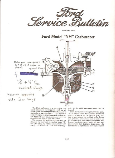

Here is picture of a measuring tool you can make from the rigid paper of a Manila file folder. Cut using a very sharp razor blade. Measure from the flange to the top of the float opposite the hinge. Jim Patrick

Re: measuring that 1/4 inch float level
