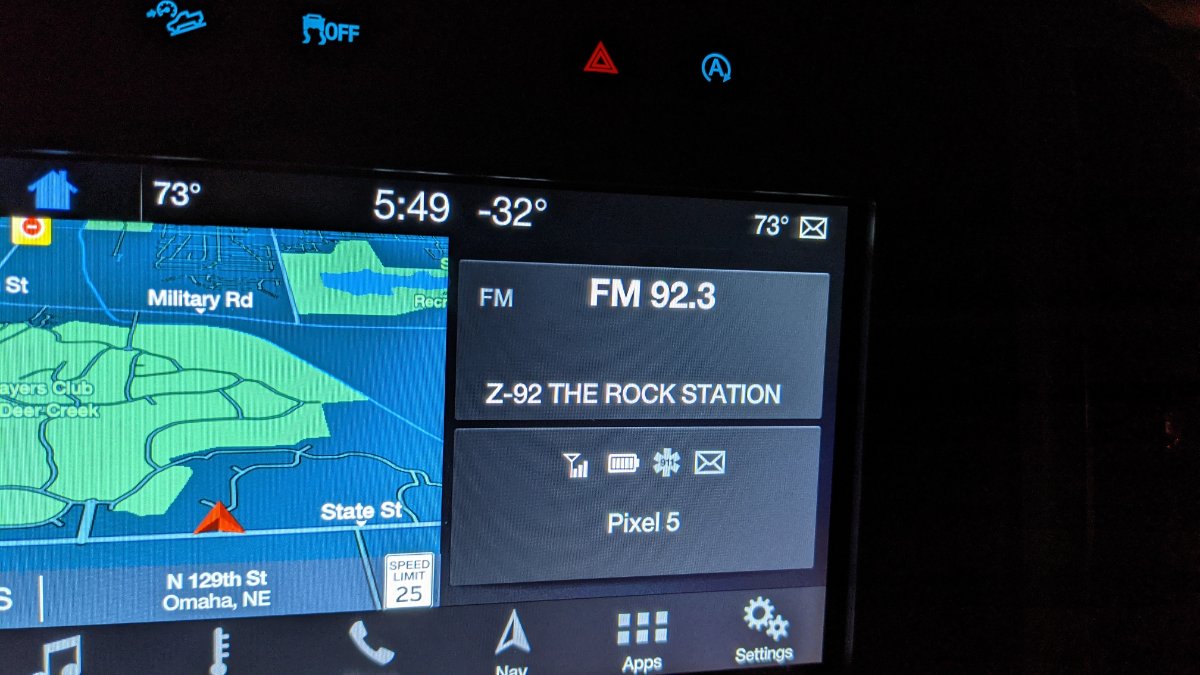

I took this photo on my morning commute. Note the -32 temp.
