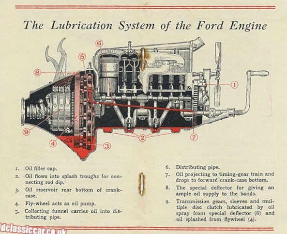

My thought. On a running engine, the internal oiler tube sends oil to the front of the engine's crankcase. Even more goes to the front of the engine if it has extra auxiliary oilers installed. Shut the engine off- the oil in the front flows to the rear of the engine, but not all goes to the rear of the engine. Some stays at the front of the engine, some gets trapped by the dips in the oil pan. If you filled the oil at the front through the filler cap, not all oil goes to the rear of the pan. If you put in 4 1/2 qts, then you overfilled it by 1/2 qt.
Had you not overfilled, the level would have been just about right in relation to the top petcock.

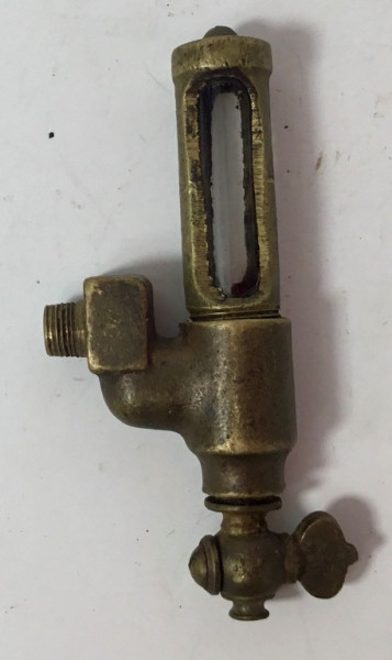

When you fill the oil pan with oil using the front oil breather, it takes awhile for the oil to completely make its’ way all the way back to the transmission. If you immediately drained the oil after filling it, the oil may not have had enough time to completely make its’ way from the front to the back. The correct level should be between the upper and lower petcock. A glass tube oil sight gauge mounted in place of the lower petcock would help you on this. Jim Patrick

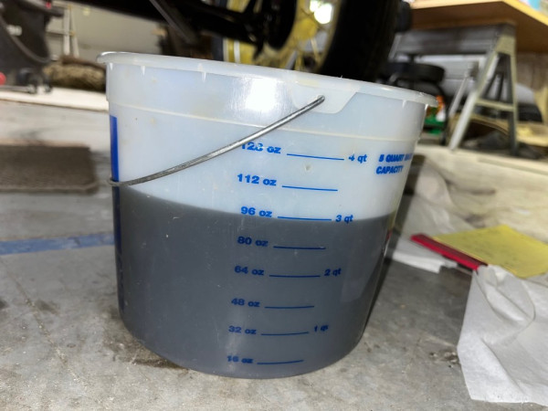

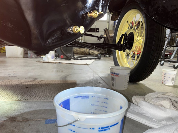

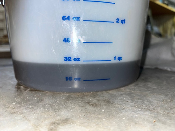

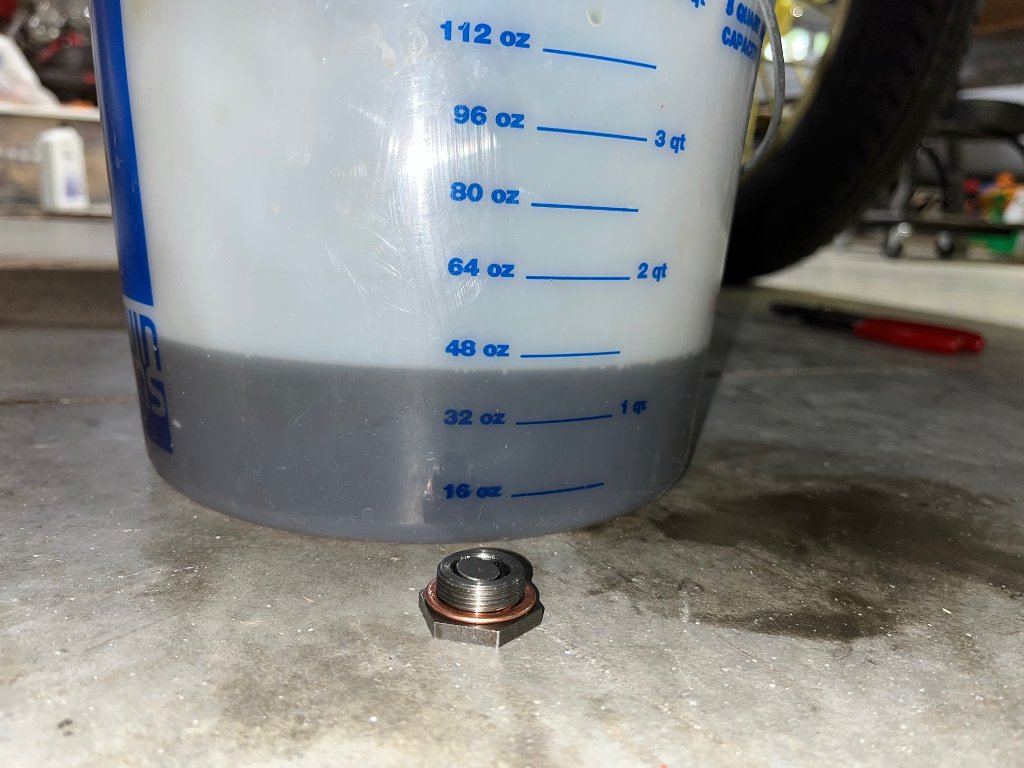

Jerry V in his May 13 (6:41am) reply raised the possibility that water maybe leaked into the oil. The block was inspected during the engine restoration so I doubted that there had been leakage. I checked the coolant level in the radiator, but I couldn't remember the level to which I filled it. Therefore, I decided to investigate by draining out the oil to determine if more came out than the 4 quarts, 23 ounces I put in.
I drained the oil in three stages. First: The oil above the top petcock (30 ounces) (See photos 1 and 2). Second: The oil between the two petcocks (2 quarts, 2 ounces) (See photos 3 and 4). Third: The oil below the bottom petcock (1 quart, 13 ounces) (See photo 5).
Total drained = 4 quarts, 13 ounces vs 4 quarts, 23 ounces put in.
I drained the oil in stages because I was curious how much oil was at the various levels mentioned above. I thought others might also be interested in that information.
Jerry, As I said in my original post, I was curious why there was so much oil above the top petcock. Thanks for pointing out the possibility of coolant leakage because now I know it was not due to leakage.
Posts: 6830
Re: Just Curious!
Post by Scott_Conger » Tue May 16, 2023 10:21 pm
You were significantly overfilled and there is STILL a good bit trapped in the rod dips that you could not get out (by design)

Posts: 8700
Re: Just Curious!
Post by TXGOAT2 » Tue May 16, 2023 10:54 pm
Some oil will remain in the rod troughs and soaked into the bands and some will stay in tight places throughout the engine.
I'd follow Ford's advice and NEVER run the engine unless the oil level was up to the lower cock.
