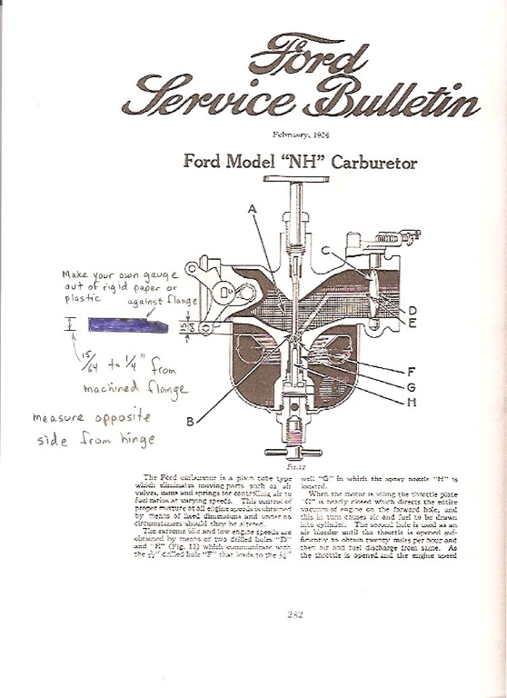

Here is picture of a measuring tool you can make from the rigid paper of a Manila file folder. Cut using a very sharp razor blade. Measure from the flange to the top of the float opposite the hinge. Jim Patrick

Re: measuring that 1/4 inch float level
A round drill bit won’t work. You must measure from the flange and a bit will not seat on the narrow, recessed flange. The best way is to make a rigid paper measure that will seat on the narrow flange surface. If you don’t measure from the flange, your measurement will be about 1/32” too wide, meaning the float will not close the valve, stopping the flow of gas, when the bowl is full and the float is raised all the way up. Jim Patrick
