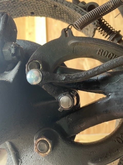

I did a parking brake rebuild on the 22 which included installing new cams and brake shoes. The arms on the cams appear to be in the right position but now the rods won’t connect to the arms on the handbrake lever when it’s all the way down unless the cams are partially rotated. Is this an adjustment issue or have I done something wrong?
The position of the cam arm.

That bend in the rod doesn't look correct. The rods should have an offset to get around the radius rods but I haven't seen one with a curve like that. Anyway, adjust the rods to where the pin just goes through the clevis with the parking lever all the way forward and the arm on the backing plate all the way back. Then check that both brakes get tight at the same point when you pull back the lever. Final test would be that you can shift from low to high with the pedal without needing to push the parking brake lever forward and that the transmission is in neutral with the lever straight up. Also if you drive on level smooth concrete and pull the parking brake lever the car does not pull to one side.

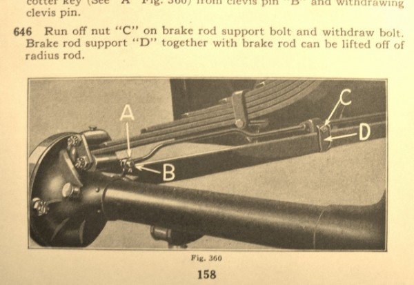

for starters, rod should look like this as mounted...does it?

That’s what the rod looks like and the position is correct. It’s hard to tell from that shot if the cam arms are in the right place.

when at rest, or the brake "off", the arm should cant back like it is (yours looks a little far back but perhaps the brake shoes aren't on?)
the cams come as "left" and "right" and if mixed up, the lever will be forward when the cam is at rest, so I'd say you have everything assembled correctly

Post by Reno Speedster » Fri May 12, 2023 9:47 pm
The shoes are in and that is with the cams at level. Everything is new so I will need to adjust things. The pins for mounting the arms on the cams are smaller than the holes, so I am going to machine and install some custom pins tomorrow.
Part of the problem was that about half the threads in the two brake clevis were stripped. I got some new ones from the industrial hardware in town and they are about 1/2 longer than the originals, which helped. Now I can at least get the rod into both clevis with the parking valve all the way forward.
