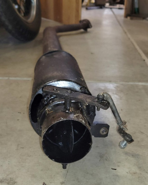

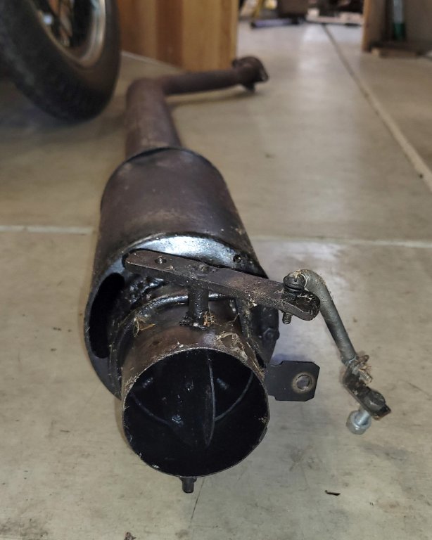

If you are running the type muffler which can be taken apart, you could turn the inner baffle around. That way the exhaust would go straight through instead of going from end to end because the holes would be at the back and go right out. That way if you decide you don't like the sound it will be easy to go back to stock.
- Posts: 4462
Re: Exhaust MOD
Or maybe just leave the inner baffle out.Norman Kling wrote: ↑Sun May 14, 2023 1:01 amIf you are running the type muffler which can be taken apart, you could turn the inner baffle around. That way the exhaust would go straight through instead of going from end to end because the holes would be at the back and go right out. That way if you decide you don't like the sound it will be easy to go back to stock.

Re: Exhaust MOD
Norm,
I think that's how my muffler was constructed.
Keith
Keith

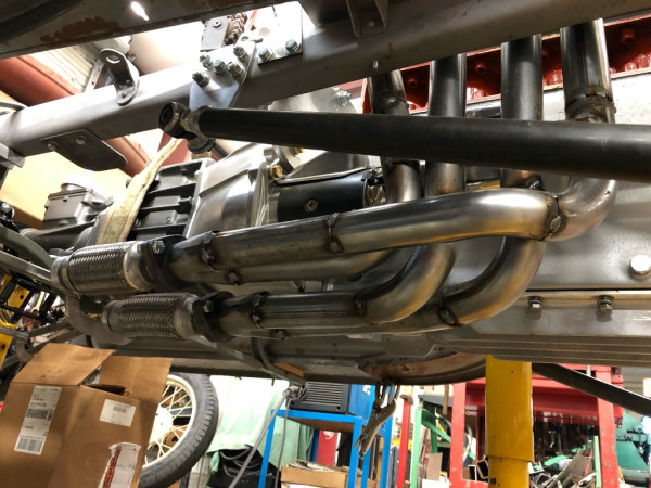

Instructions to make one - modified for dual exhaust manifold
https://www.mtfca.com/discus/messages/8 ... 1530408436
https://www.facebook.com/kathy.p.brown. ... 892621554/

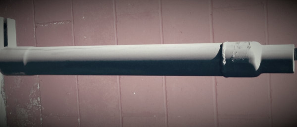

I made a modification to my homemade muffler.
The open 2 inch pipe is now closed with a 1.5 in to 2 in reducer, welded to the 2 in tube. The reducer was welded with the 1.5 in end inside the 2 in tube. This has created the necessary back pressure much like the stock muffler.

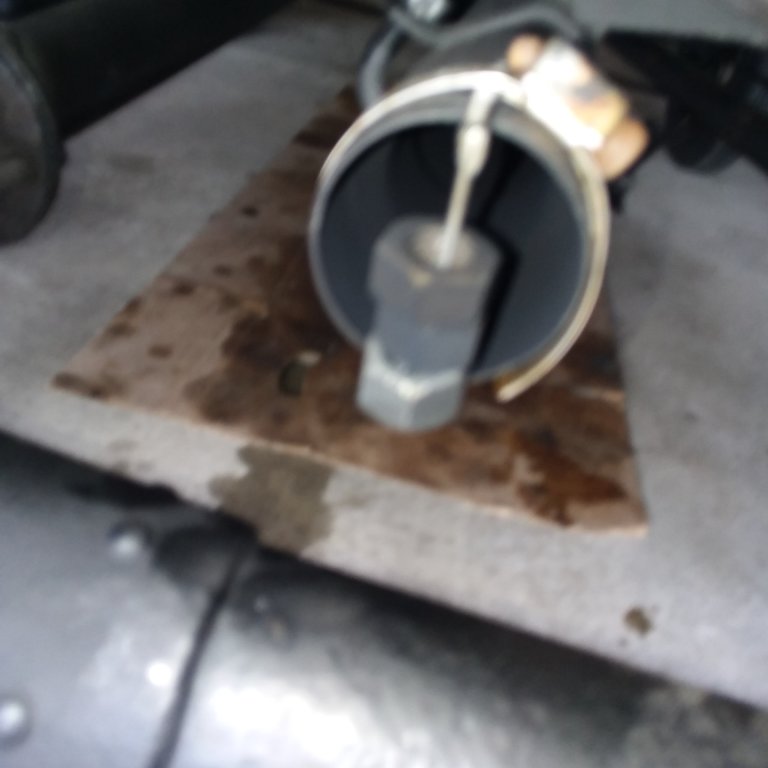

Re: Exhaust MOD

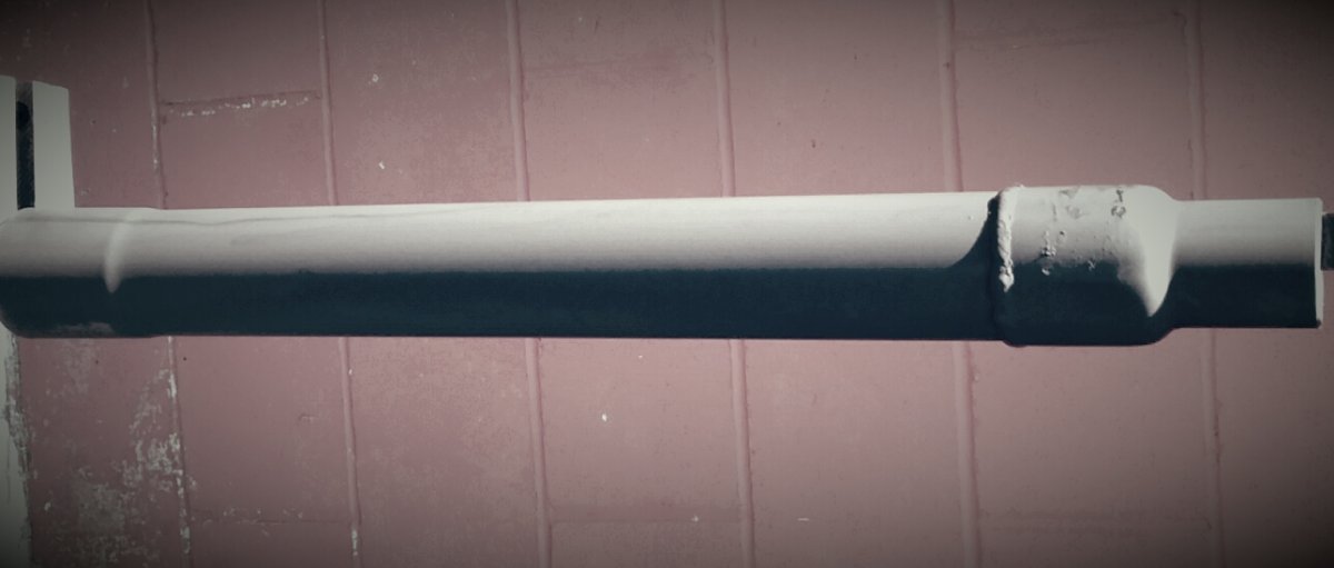

I have found "the recipe...."
-1.5" to 2" coupling to go into existing 1.5" stock pipe.
-18" length of 2" pipe welded to 2" side of coupling.
-1.5" to 2" coupling to go into the end of the 2" pipe, but weld it backwards with 1.5" side inside. The 2" end of the coupling becomes a 2" extension.
-->then three 3/4" nuts stacked to block part of the outlet as pictured.
The restrictive area of the nuts has brought the engine back to life! The motor now has crisp throttle and leaps forward and pulls well when spark is advanced.
Going to drill the exit of the pipe and stack them on a 1/4" bolt.
It's still very loud. But I have now achieved what i had hoped to.
Hope you can enjoy the "recipe" on your car/speedster!

I found that the outlet has to be about 30% smaller than the inlet.
I based my initial calculations on measurements of a stock muffler.
The number ratio reduction I calculated I tried to achieve with the nuts, on the premise that it would be easy to add or subtract nuts to facilitate changes in back pressure.
This was a fun project for sure! ****TUNEABLE SHOTGUN MUFFLER!!!******

I began with a 1.5" to 2" flange with 18" of 2" pipe.
The engine sounded "nasty" good, but it lacked any power and did not accelerate well in high gear at all.
Closing off the outlet down to 1.5" seemed to be an imrpovement.
Then I measured and calculated inlet/outlet ratio on the stock muffler. I found that in order to mimick the stock muffler restriction profile, I had reduce the outlet by about 30%. I achieved this reduction by adding the stack of nuts, with the idea I can add or subtract restriction by adding or subtracting nuts.
I calculated approximately 3 nuts would be very close to the 30% restriction goal.
And that did the trick! Car now is very responsive in both throttle and timing.
And the best part.... It's pretty loud, but not wildly like it was in the beginning with the open 2" tube and no restriction. More of a "refined" loud sound that allows the engine to perform well. I'm happy.
Hope this helps someone else.
But I don't see how a wide open pipe will perform well unless you wind the motor up in high rpm.
For me, I've found back pressure is low rpm torque.
I understand the velocity issue exists too.
But it's a model t, all glorious 20hp of it, and it's supposed to be fun. And it certainly is!

Any gain will be made by exploiting inertia of the moving gas column in the exhaust system. You don't want back pressure in the system. Ideally, you obtain negative pressure at each exhaust port just as the exhaust valve opens.
- Posts: 6579
Re: SHOTGUN MUFFLER
Good technical explanations on what causes back pressure, why its exists and why its unwanted
