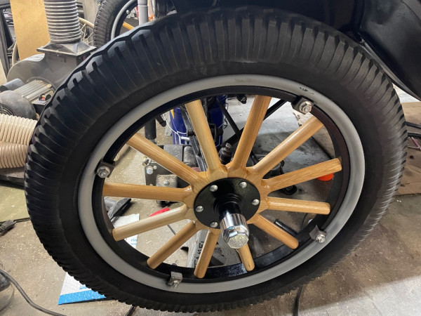

I had a busy winter working on the 22 runabout PU. I moved the body back 3/4 of an inch to the correct location, put new bearings in the front end, new seals an outer bearings in the rear end, along with rebuilding the parking brakes, made brake/running light mounts and installed the lights and brake light switch, installed the engine pans and carb heater, installed a battery horn, installed 5-1 steering guts and rebushed the lower steering bracket, installed Apco steering ends, a new steering arm, and tie rod ball, made a mount for my klaxon horn that goes on the spare tire mount, installed an exhaust whistle and cutout, rebuilt the wheels with matching Kelsey removable clip felloes and rims, installed a speedo drive gear, ordered 2 new tires to make a matching set (in transit), installed a sliding adjuster on my Rocky Mountain brakes, made a fat lady brace, made a new starter cable, repaired the battery bracket, painted the head and exhaust manifold, replaced the freeze plugs, replaced the pins in the hood, made new floorboards and a panel under the seat, installed a steering column brace, and bought all the parts to install a speedometer. The cable and a new head are on order and will go on when they come in.

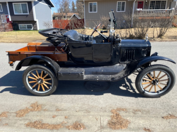

And today, I drove it for the first time this year. It feels really great. No wheels clicking, no death wobble. Fingers crossed, it should be a good driver. It does need a wash though!

Looks good. Now you can drive all around Alaska.

“All around Alaska” is a tall order. We don’t have many roads, but the ones we have are long and in some cases, pretty rough. Right now I am working on all around Anchorage! After you do this many things, it’s best to shake it down some.

Big milestone to get it on the road for the first time, congratulations. When you fold the top down, you take the front bow out of the upper clip and hook it into the lower clip so the bows are all the same length.
