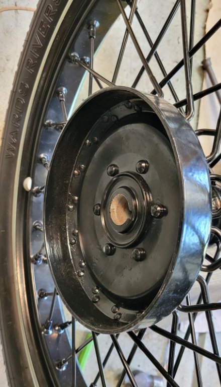

I have a very nice set of Hayes wire wheels that have been powder coated. Unfortunately the brake drums were powder coated too. Both inside and out. I plan to use outside brakes along with the inside parking brakes.
What is the best way to remove the powder coating to get down to bare steel?
