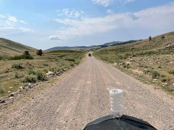

gatorade bottle.jpg (71.24 KiB) Viewed 925 times
You could always do like Dean and install a Gatorade bottle.
