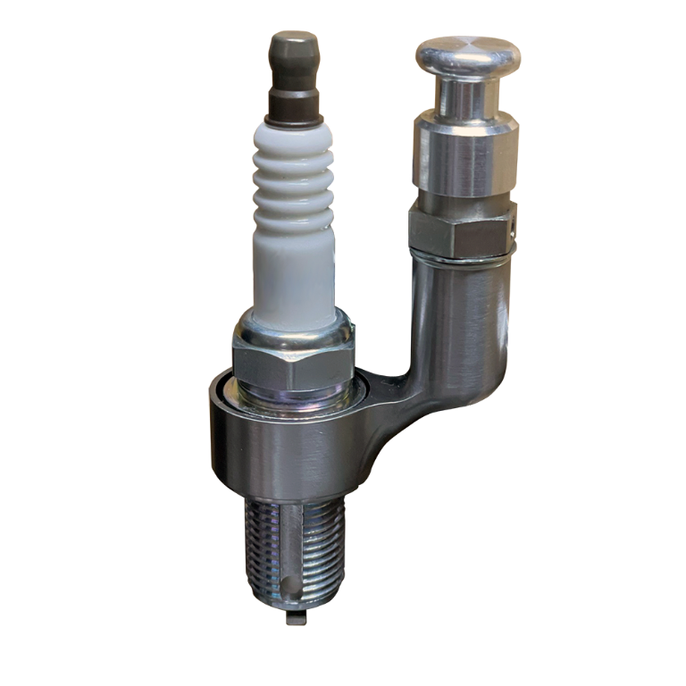

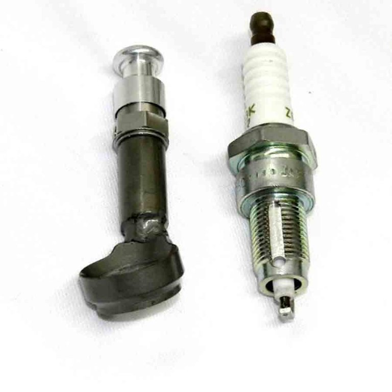

In my pursute of this issue I have found that if you use the 1/2" pipe to 14mm spark plug adapter they sell a auto shut off compression release
for Harley Davisons with real high compression. They are super expensive from $80-$150 each and would require a special plug that when
replaced are $40 each. I hope these suppliers don't mind.
