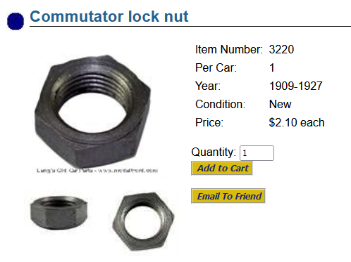

Need picture of the gear & nut on the camshaft. Are you using the correct nut?
What distributor are you using and where did you get the gears?
- Attachments
- comm nut.png (77.91 KiB) Viewed 2222 times
