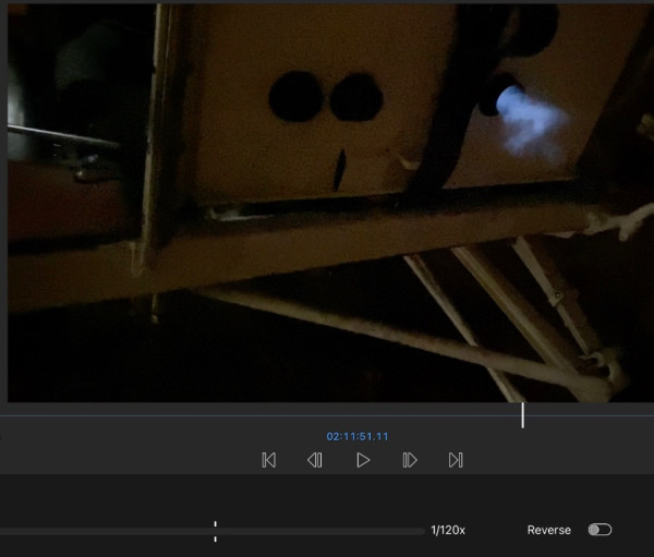

Bruce V. S. suggested I try videotaping the racer in the dark to see how the cylinders are firing at slow speed. Here are the results. I'd appreciate any comments/observations. Maybe this is as good as it gets, due to high cam/valve lift and valve timing?
The first video is at regular speed. Initially the trailer door is open and the motor a little rich (just started). I lean it out a bit, and close the side door to get a better view of the explosions.

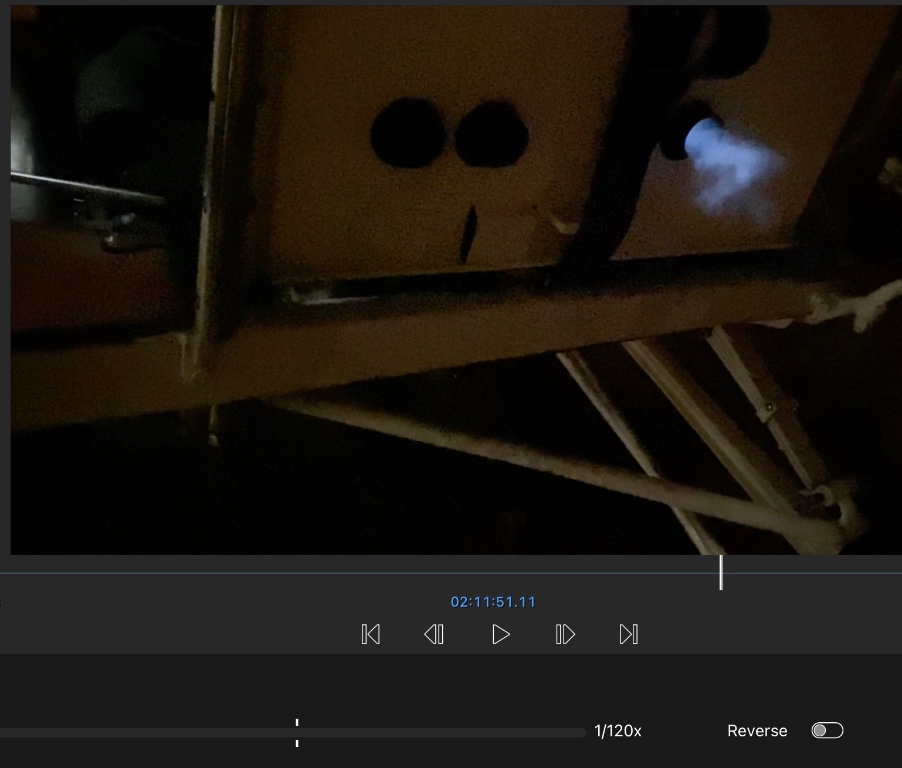

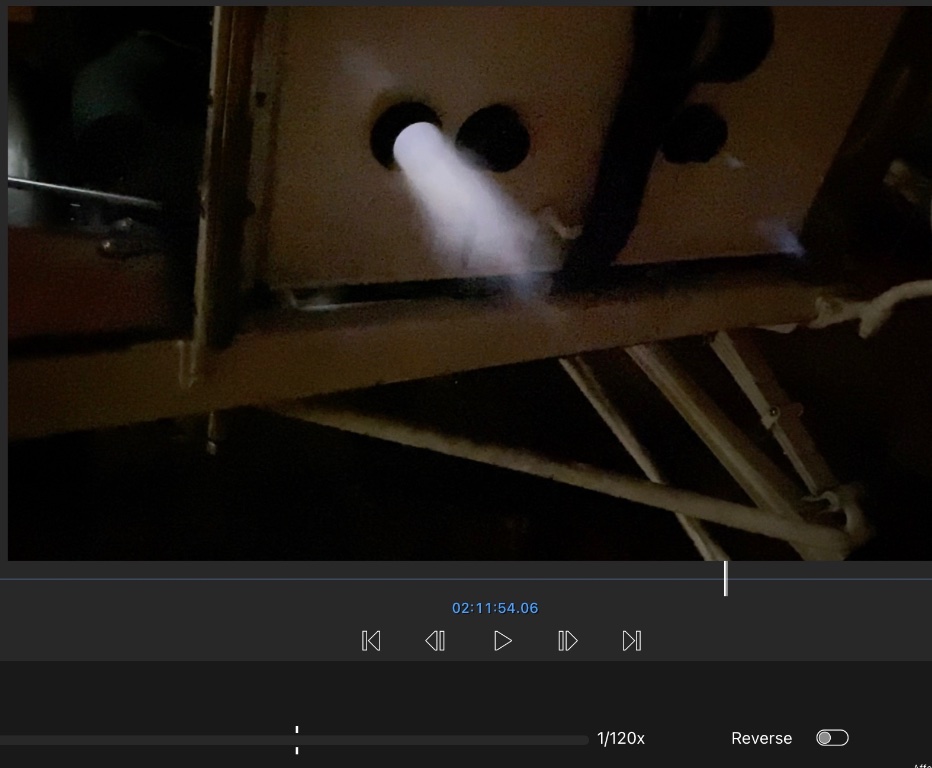

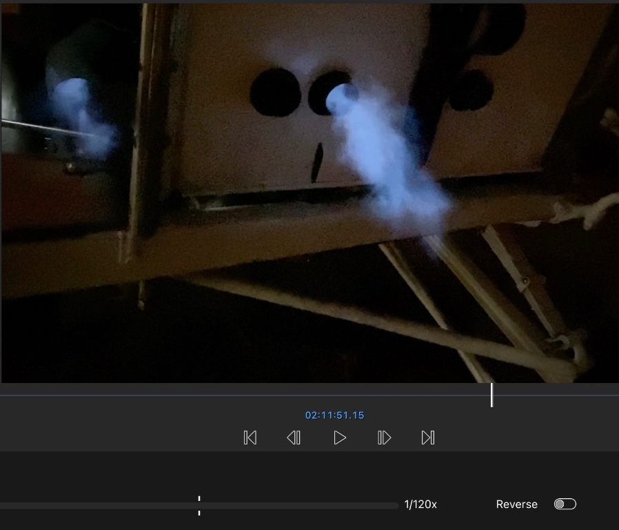

These are three stills, frame by frame from the slowed video (120th speed). The camera frames aren't slow enough to get every explosions, so I'll walk through it:
First, number 1 firing: Number 2 in the middle/end of an explosion with number 4 just starting: Number 3 firing:

Hi Rob, reat videos / pictures. It looks like #1 is putting out less blue flame that the others. Does that mean anything? I don't know, but guess that it doesn't mean anything.
Harold mentioned that the lift is 3.75 less the valve lash. Like the others said, that's probably what's causing the rough idle.

I wonder if the frame rate is matching up with one of the cylinders firing, there some cylinders appear to be firing more but if the frames match up just right it may appear to not be firing

Keith snd Mathew, thanks for your replies. I think I need to “hover” over each pipe for a few revolutions to really see the volume and color of each cylinder. I wish the camera frame rate was faster, but doubt in the dark it would help (if I can change it on an iPhone anyway).

#4 appears to be misfiring significantly
additionally, the weak orange flame shows fuel rich/oxygen starved situation and may in fact be waste fuel igniting on the hot exhaust pipe
not knowing anything about the cam, but understanding the purpose of the car, a smooth idle is quite likely never going to occur
since #4 shares the port with #3 and #3 is firing fine, if the coil ignition is working correctly, I would try a hotter plug or plugs
