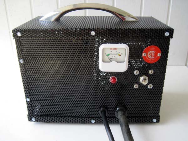

I renovated an old 40 Volt about 40 Amp Golf Cart Battery Charger that works very good with three short 5 Second zaps.
It had a 8 Hour Time Out Switch that was replaced with a heavy duty push button.
The last one I did had a compass that pointed right to the transmission case and pedals all over.
So, I removed the spark plugs, jacked up a ear wheel to reduce drag and put the brake lever in neutral.
Three short pushes of the button did a great charge, and the first one aligned the flywheel.
Putting the spark plugs back in and starting on Bat burned out my 1156 bulb used a a load for my volt meter and it was showing about 16 to 18 at a fast idle.
Now the engine will start on Mag too.
My design.

JBog

That's brilliant! I would love to know what you did to it.

I believe a 5 second zap is an extremely long time. It would serve to burn out any shorts on the mag coil but is a much longer application than the magnets really need
it is a very nicely packaged device, Jim.
