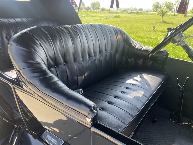

What do I do with all the extra material in the corners? It’s like its two panels too many.

It has been a long time since I did a 23 seat. If I remember, those corners are a head scratcher. I may have done mine 3 times to get it right before I drove in all the tacks. Hard to tell from the picture, but it looks like you tucked the upholstery into the side of the seat back springs. There needs to be more cotton and whatever is being used as an alternative to horse hair to transition from seat spring to side wall. You should not be able to tell where the springs end. You may need to pull the tacks out of the side / arm rest and pull the arm rest upholstery more toward the door to take out that big pocket between the springs and sides.

I have the last button at the door opening now. It seems to be at least two pleats too long.

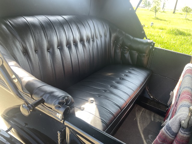

I feel your pain. I just finished my '23 touring. Spent the winter trying to get it right. I have done the upholstery on a '28 Tudor, '22 Center door and this Touring car was by far the hardest. I thought it would be easier when it was warmer. But I don't know if that would have helped or not. Kept my shop at 65 degrees,
Anyway, see picture and where the last button by the door ended up. Also, after you get that done, look at how we ended the material at the door. We looked at every picture we could and came up with the pleats like shown. Everyone seemed to do it different.
Good luck!
Rich in Colorado

In the corners, dont follow the sewed pleats. Where they come together, the back seat section has extra material that gets folded under. Do some try fits. A bit of extra padding gets stuffed in to fill the corner material for better appearance. You do work from the door edges towards the centered back section & adjust where they meet. All this should have been pointed out in the instructions.
These kits are like a fits all format. A real upholstery guy would make the pleating translon neatly in his custom fit cover. These kit jobs dont look like an upholstered couch you are used to seeing
My first was a Carter cut & cover. Known for the worst instruction sheets.
Riches job looks better than typical. Very nice job.

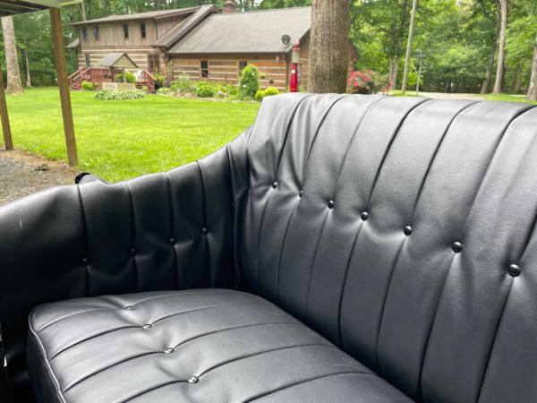

I am attempting ro send a picture of my upholstery.
