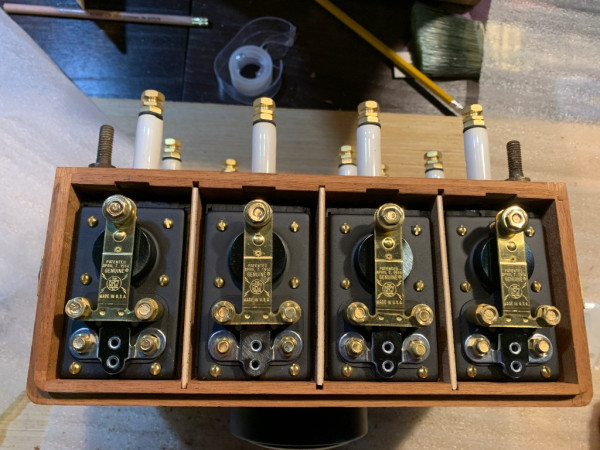

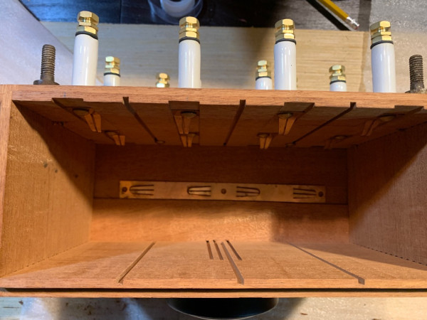

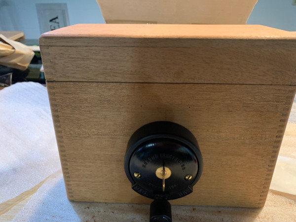

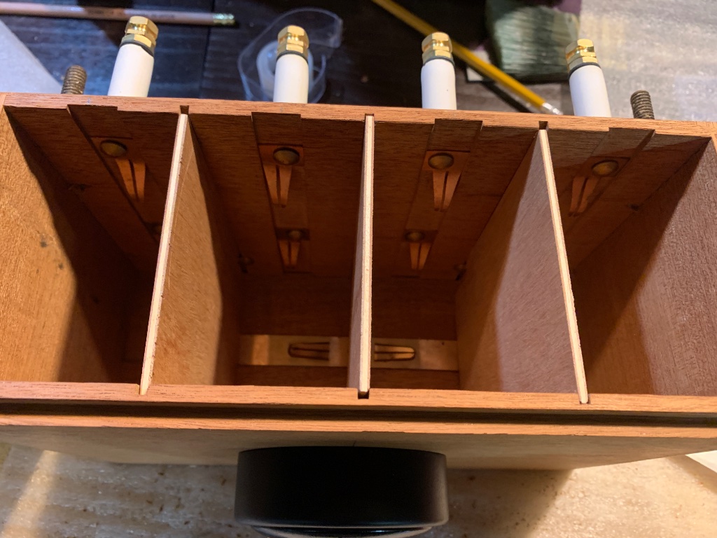

Hi guys, I’m needing some direction on how to wire up this Kingston Coil Box:
Here’s the materials I’m using:
Kingston coil box (repo) to accept later style coils. My coils fit very snugly inside.
Fun Projects coil contact set
Repo Kingston coil switch
Questions:

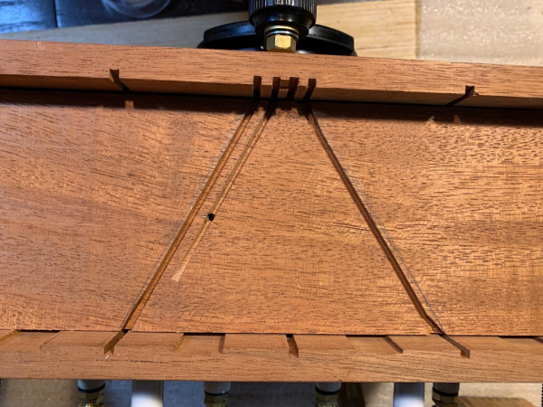

What kind of wire do I use?
How is the switch wired?

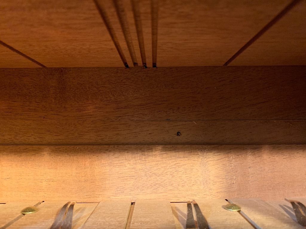

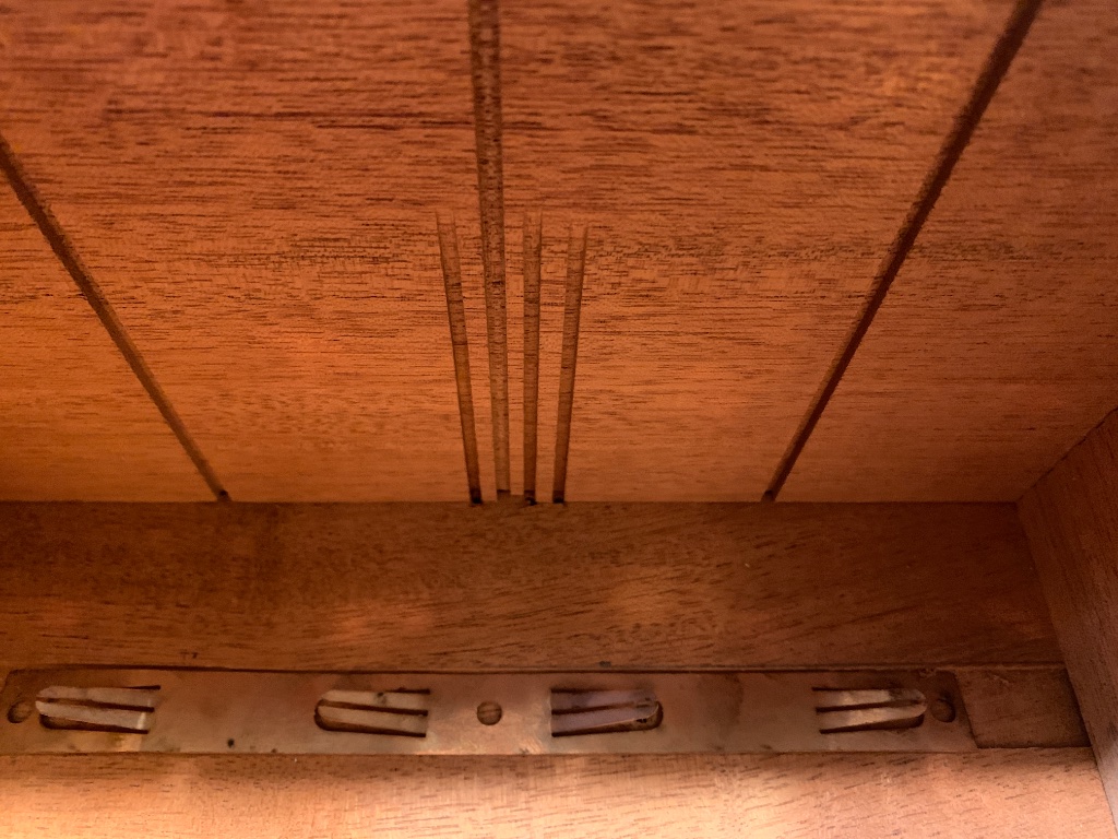

What wires go where in the grooves?
Pictures/drawings would be helpful if you have any

NealW
Posts: 516
First Name: Neal
Last Name: Willford
Location: Kansas
Re: Kingston Coil Box Wiring
Post by NealW » Wed May 24, 2023 7:53 am
Mike,
In late 2021 I built a similar box for our 1911 restoration, except I used a replica Heinze box and switch. Lang's sells the insulated wire that you need. You will need to solder three of the wires. I used the Vowell art as a guide for the wiring. I must have done it correctly, because the T starts and runs well! I hope that this helps.
https://www.mtfca.com/discus/messages/7 ... 1510857688
app.php/gallery/image/128
