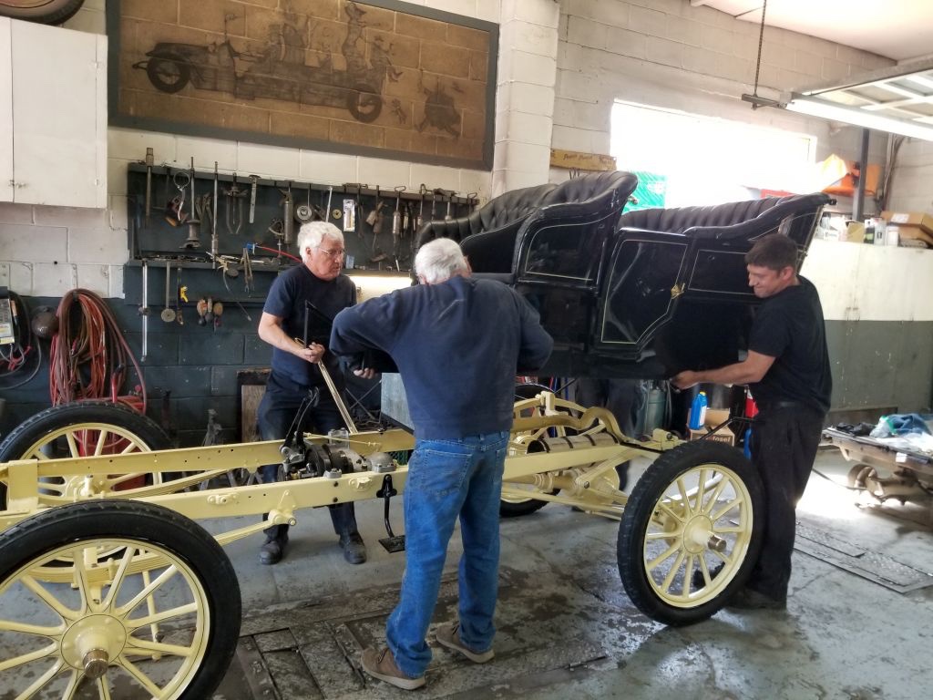

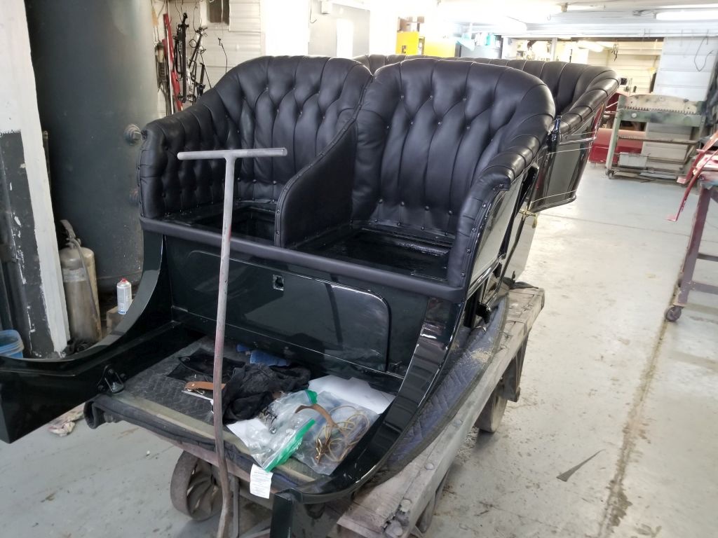

The plan is to have this 1905 (built in late 1904) Ford Model B at Richmond for the Model T Reunion. We hope to have all the “alphabet Fords” there. I plan to be in Canada by Monday to see the guys at Fawcett Restoration finish the car. My plan is to arrive in Richmond by Thursday evening. I’ll post photos as the car goes together:

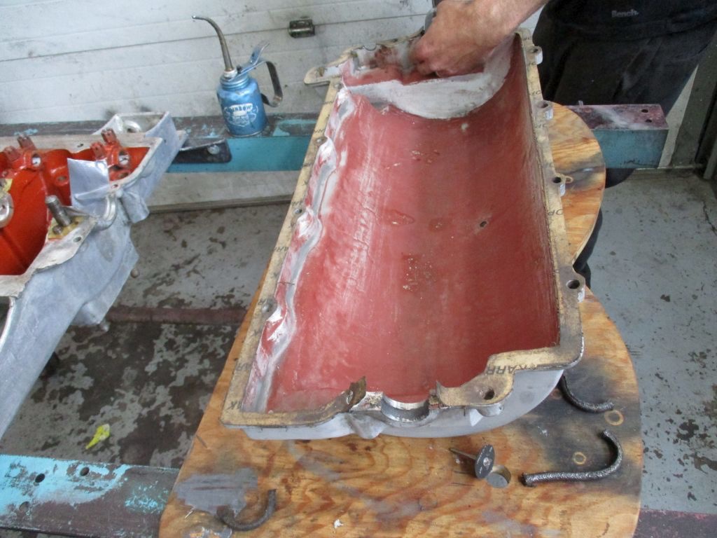

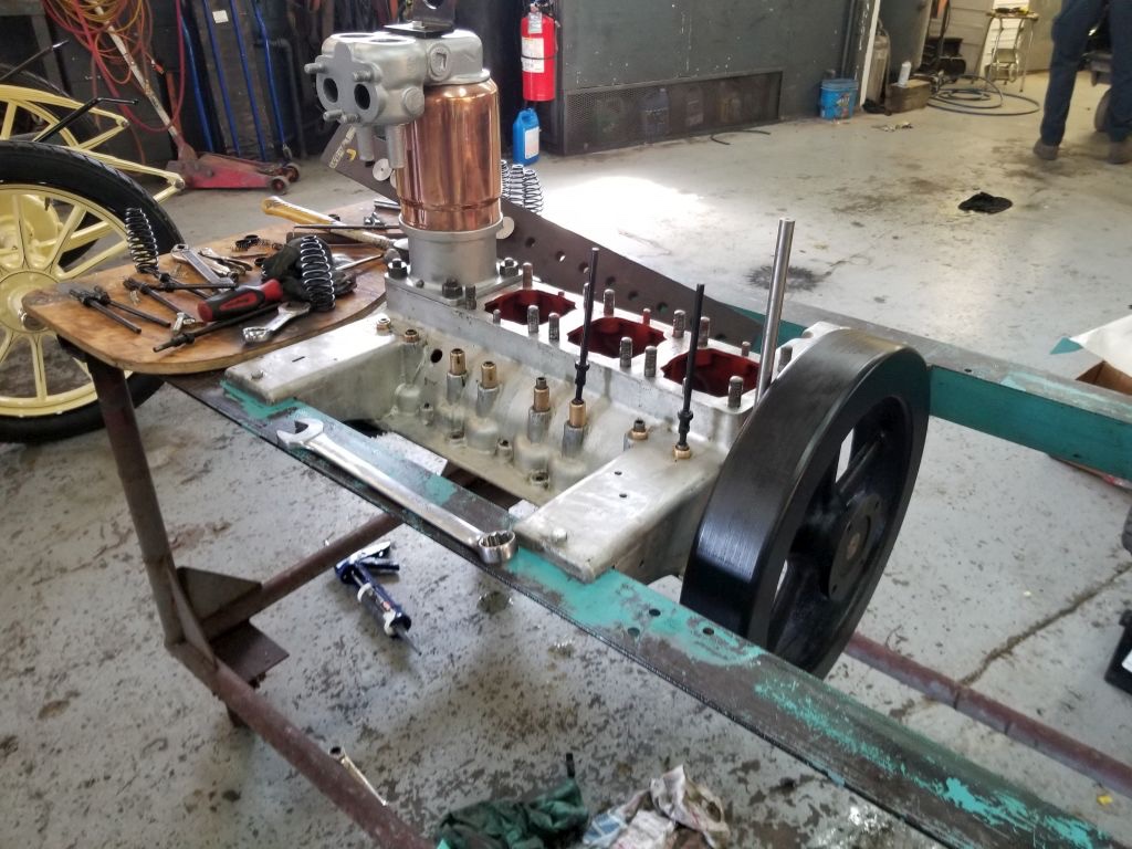

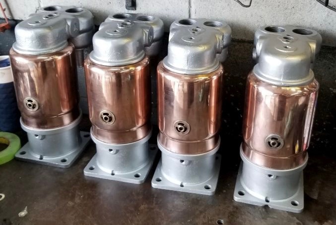

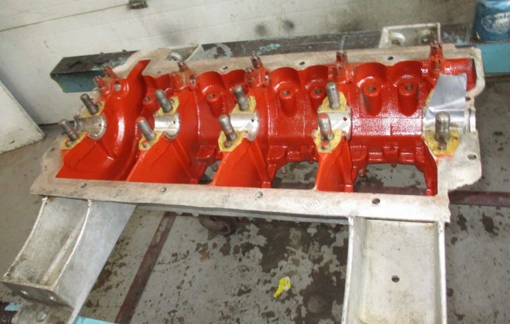

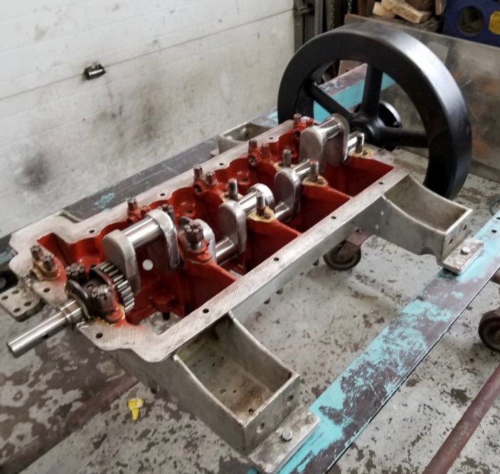

Engine photos:

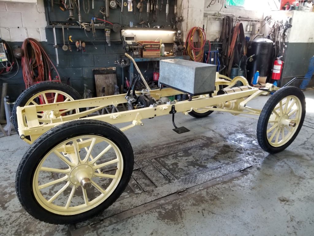

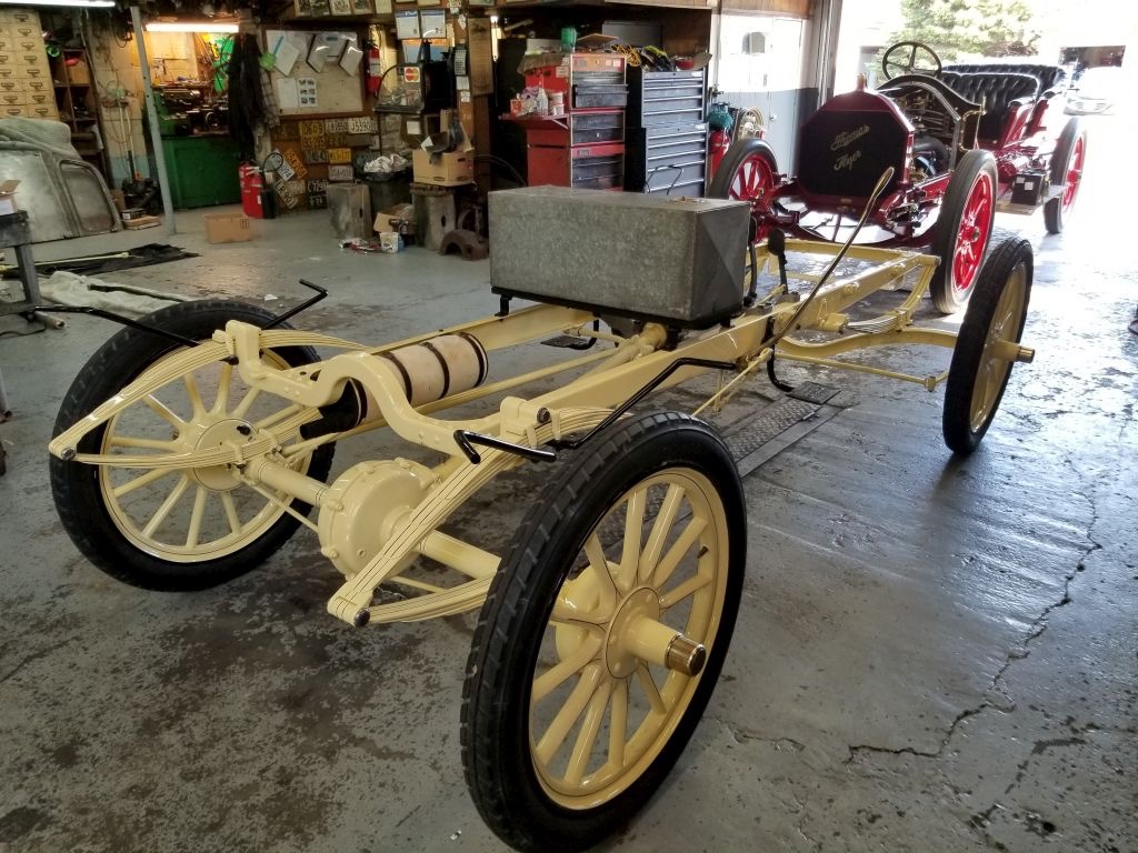

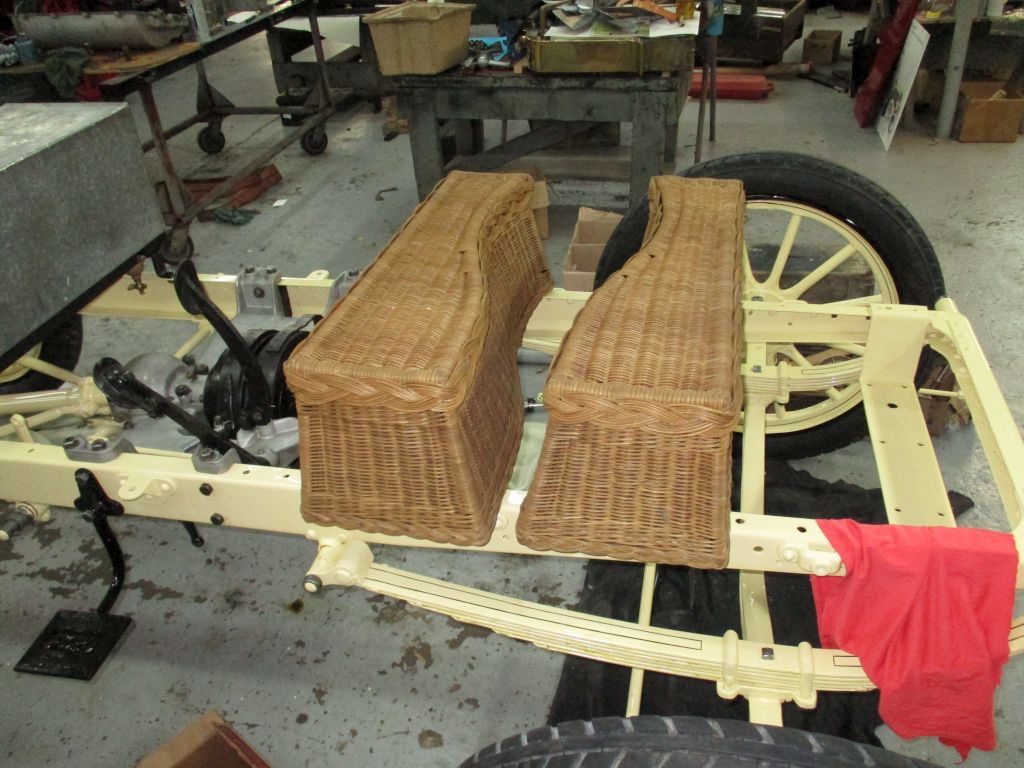

Post by Rob » Wed May 24, 2023 3:02 pm

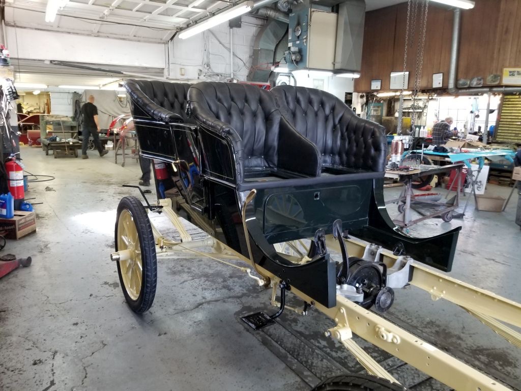

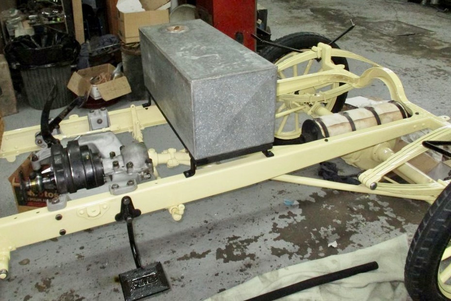

Chassis and more:

Hope to see it there on Saturday. Do you use the flywheel to start it?

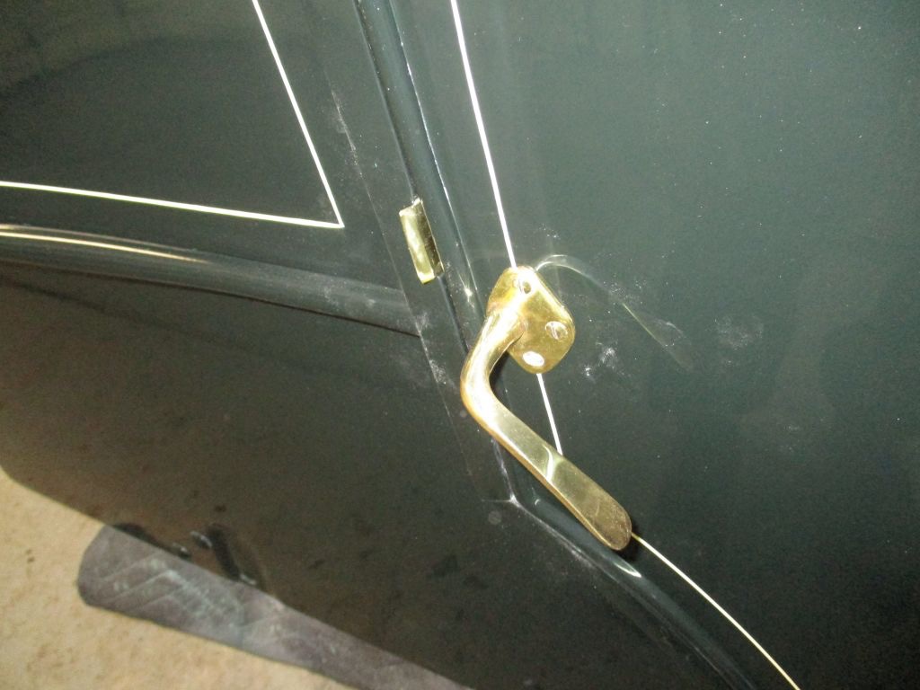

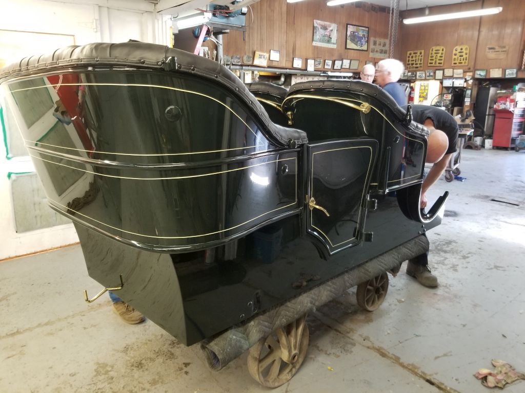

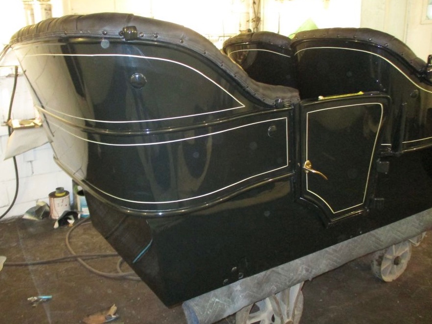

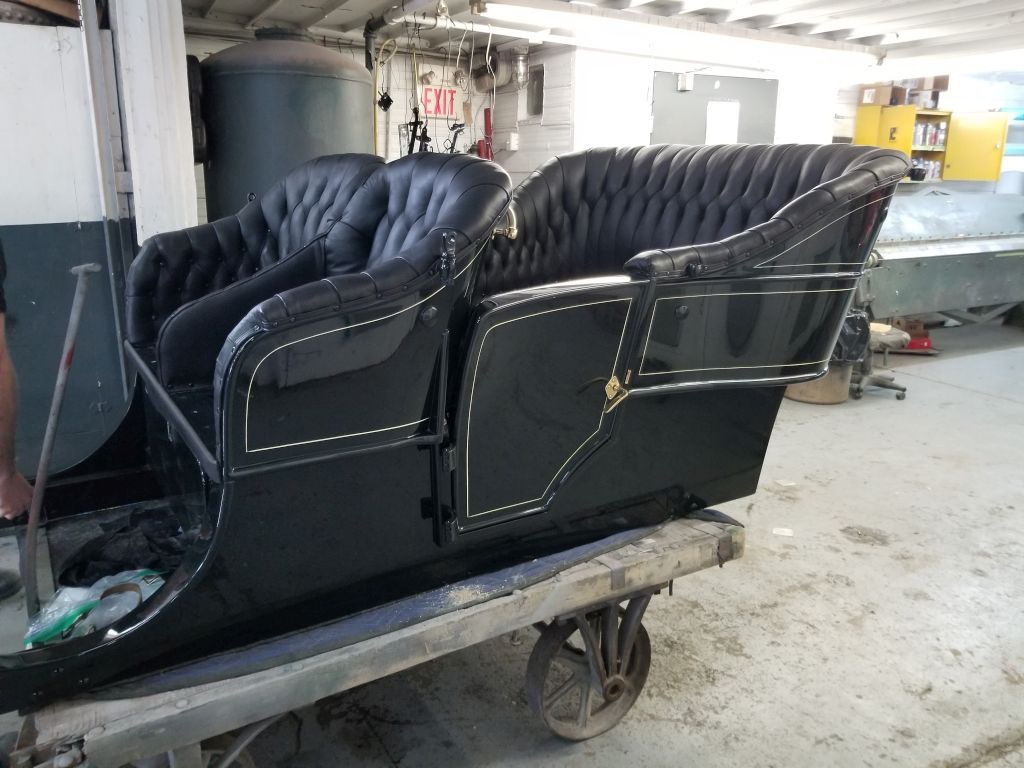

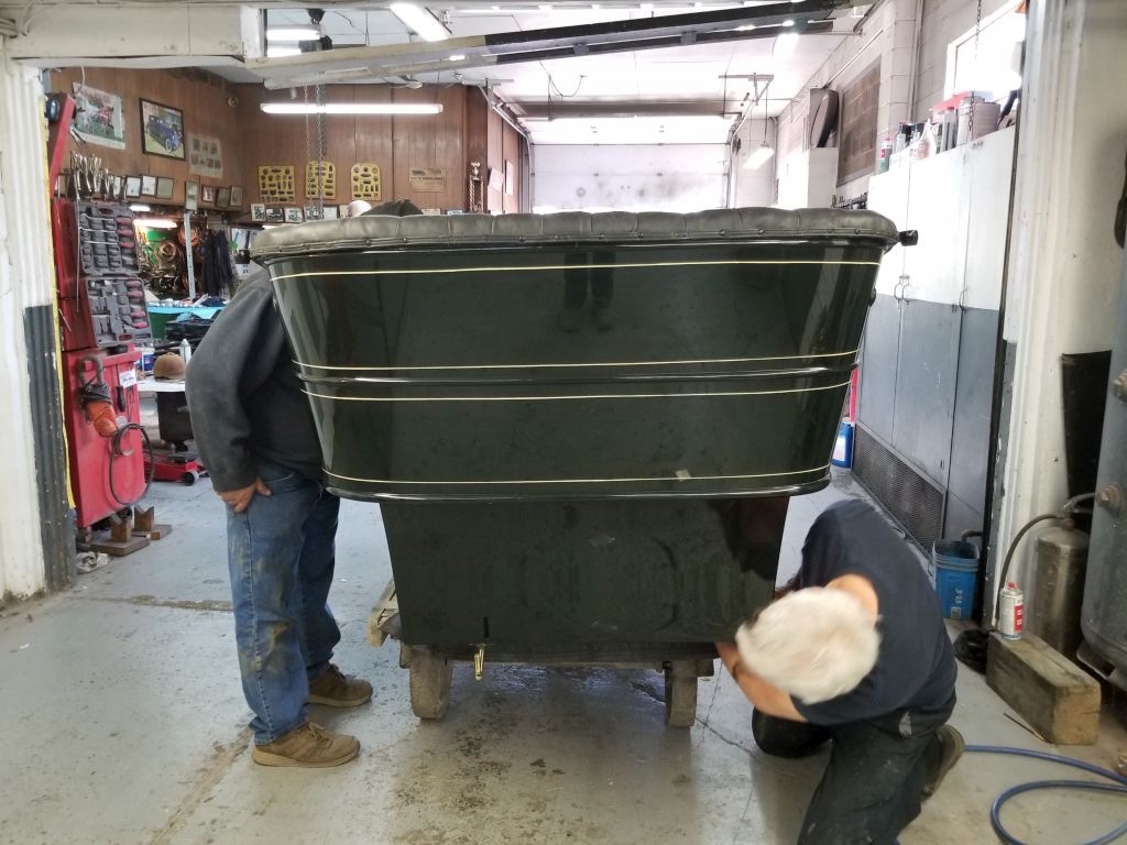

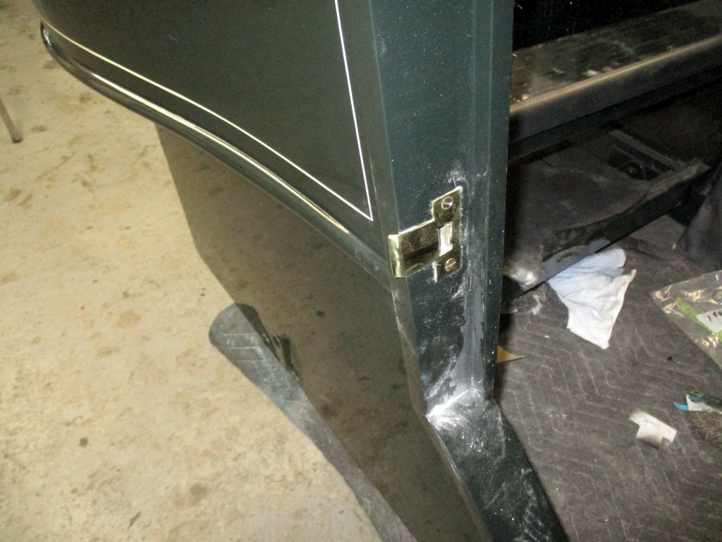

I wonder about the striping? I don't think they would have done it that way in 1905?
Rob
Posts: 1591
First Name: Rob
Last Name: Heyen
Location: Eastern Nebraska
Re: One of Fords first four cylinder cars is almost ready
Post by Rob » Thu May 25, 2023 11:20 am
This closeup shows several reflections, that appear to be striping, as well as some of the striping:
Same stripping, possibly on the same early car. Only the first 50-60 Model B had steplates, with a switch to running boards and a larger rear door by mid January 1905:

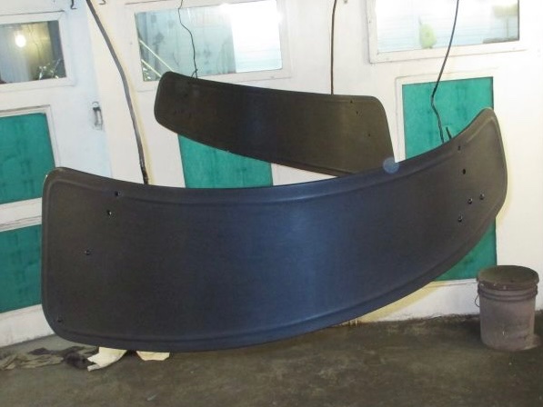

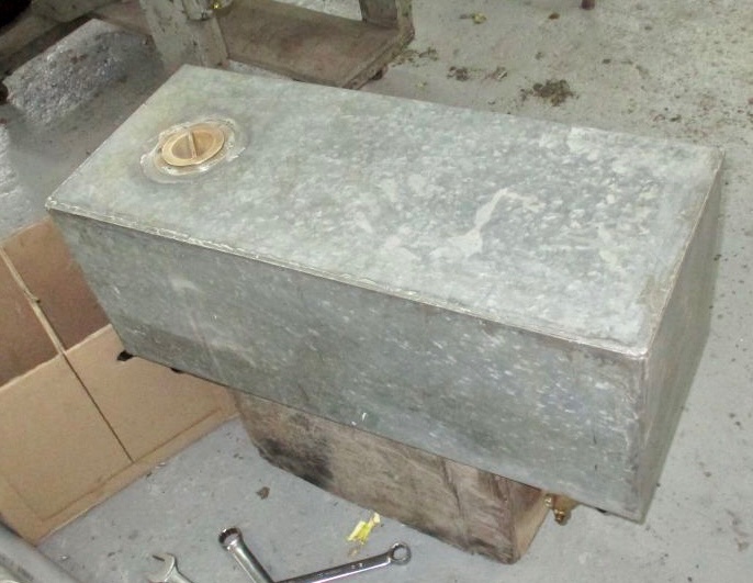

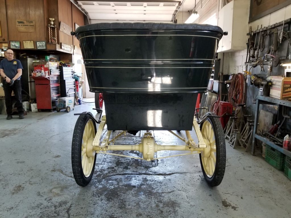

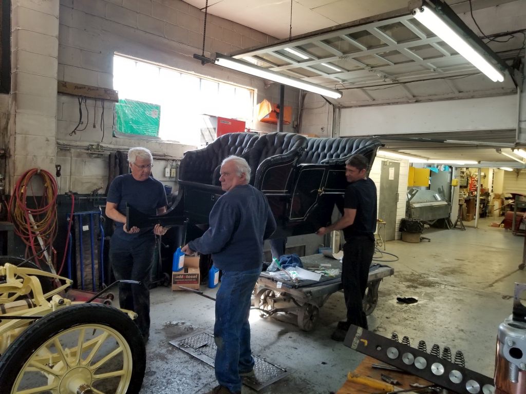

The next batch…..

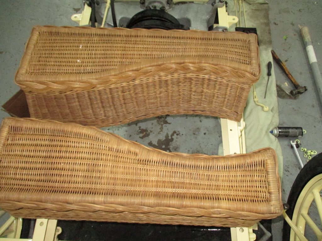

Post by Rob » Thu May 25, 2023 7:28 pm

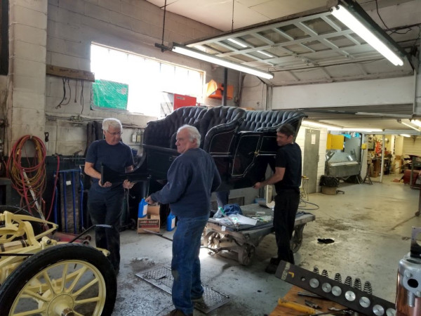

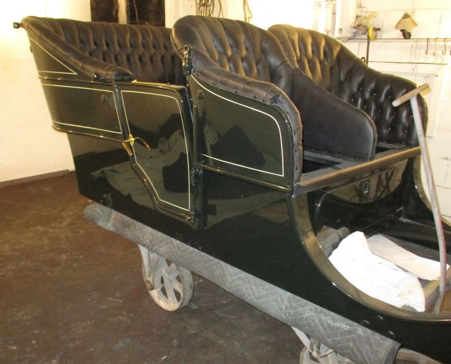

More from today:

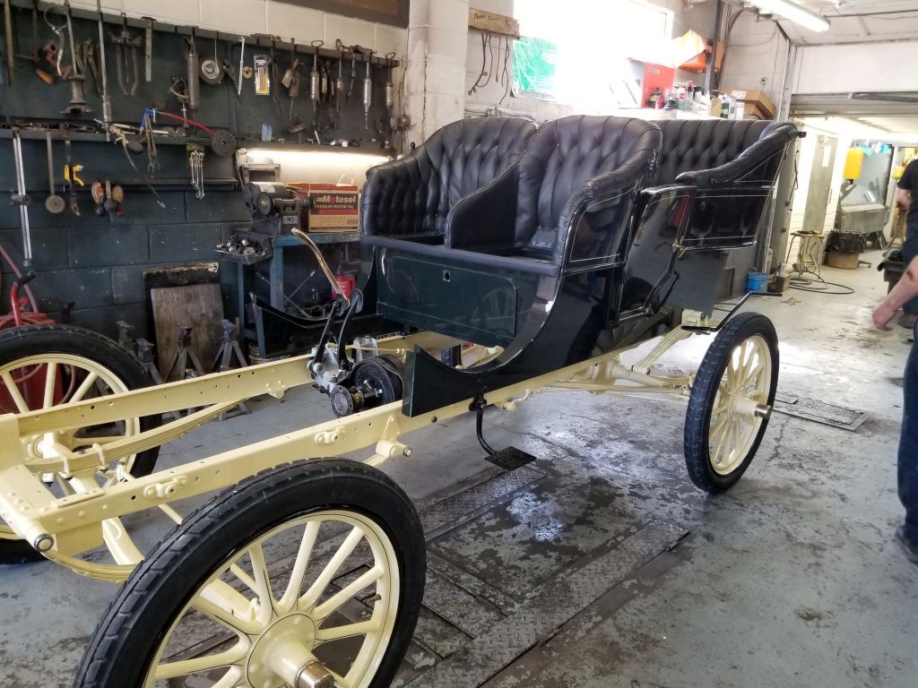

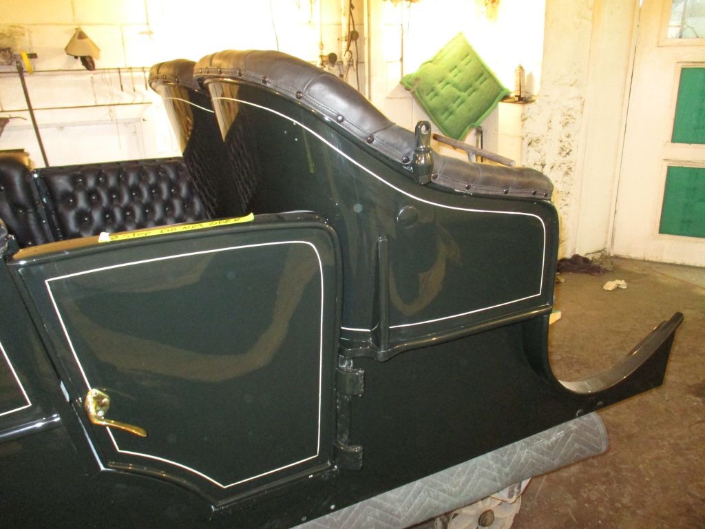

Post by Rob » Thu May 25, 2023 7:29 pm
The rest for today:
