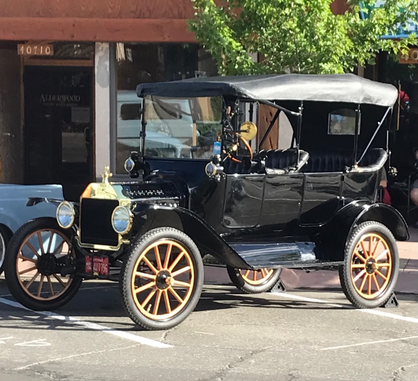

I decided I wanted the wood look when I replaced the wood wheels in my ‘15 Touring last year. I received the wheels from Stutzman with new hickory wood and sandblasted/primed hubs and rims. I stained the wood with a mixture of golden pecan and red chestnut Minwax Wood Finish Penetrating Stain, then applied 7 coats of Total Boat Gleam 2.0 marine spar varnish. I selected the Total Boat product because it was possible to apply 2 coats per day. I then painted the metal parts with Rust-Oleum Appliance Epoxy. I was happy with the way they turned out.
Funny story- When I finally got my car back on the road last summer after sitting for 15 years, I took it to a car show in Big Bear Lake, California. One guy came up to me and asked how I I was able to get the wheels to look so much like wood. Uh, they are wood. He was amazed that wheels could be made out of wood!

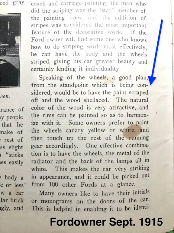

If you can find a concrete example or memory of someone scraping paint off a Ford wheel in the early days, I'd like to add it to my list. So far, all of the Ford wheels I've seen in early photos up to 1925 are painted. A n option for varnished wheels on a Ford pre-1925 would be through five-lug accessory demountables.

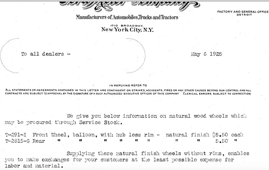

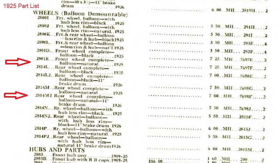

from earlier discussion viewtopic.php?f=2&t=18742
appears to be available in 1925

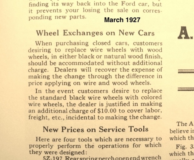

They were no cost option, in lieu of wire wheels on the closed cars by '27 to spur sales. A set of wood wheels were only $22. The wires were more a set, so dealer swap was made at no labor charge, as the dealer made some on the difference.
For a few bucks more the varnished wheel really set off the plain Ford. The Ford price was lower than a Chev. so why not outfit it with a few accessories, you know, always been the Ford vs Chev owners!!! Started in '26-'27!

As for the other Ts, the cost was held down to help dealers cater to customers who liked the varnished spokes.

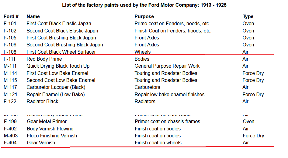

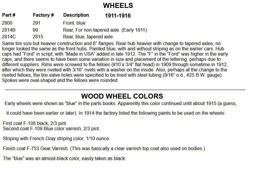

To answer what is correct- note "blue" was almost black
from https://www.mtfca.com/encyclo/P-R.htm#paint1 on paints
Another interesting dip painting operation was the painting of wood wheels. The first coat applied was F-108 Black Wheel Surfacer. This paint was primarily made up of pigment (52-54%), with the oil, gum and metallic dryer representing 12-14% of the paint, and a thinner of mineral spirits which accounted for 32-34% of the paint. Unpainted wheels were mounted horizontally on a vertical spindle above a circular vat partially filled with paint. The vat was raised, immersing the wheel in the paint and then partway lowered. The wheel was then spun at 540 to 720 rpm for about a minute while still within the vat but above the surface level of the paint. After spinning the paint was considered to be dry enough that the wheel could be handled and it was placed in a drying room for the next 24 hours. The subsequent two coats of paint were applied in a similar manner. The second coat was F-159 Black Wheel Color Varnish. This was followed by F-404 Finish Coat on Wheels. F-404 could be described as a nearly clear topcoat varnish. It contained only enough pigment to give it a dark tint. This painting process resulted in wheels that were a deep, gloss black color.
NOTE: The above does not mention F-109 as the process below includes it and the codes for "Gear Varnish" are different

So the idea of scraping off paint to make varnished wheels really did exist, wonder how common it was. The suggestion of painting the radiator and headlight shells white is just freakish.
