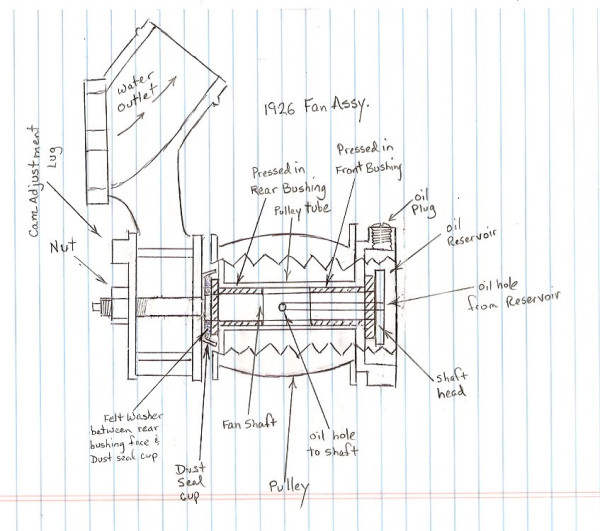

How much adjustment is there in a '26-"27 fan pulley?
Rotating the adjustment lug of the '26-'27 eccentric, thru it's 180 degree range,
....raises or lowers the upper pulley approx. 1 inch.

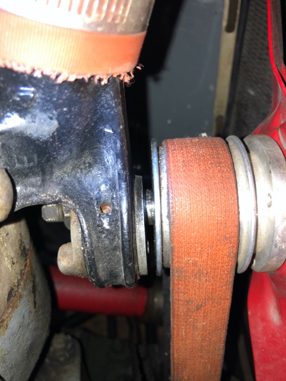

Post by Norman Kling » Fri May 26, 2023 10:22 am
As you look from the back, turn the adjustment clockwise. That will move the belt farther from the timer. This will prevent interference with the timer. The belt should be tight enough so that if you rest your hand on the fan blade, the fan will not turn, but you can still turn the blade with your hand if you push it just a little more than the hand resting on it. It should not be too tight. In fact if you tighten it too much the belt will actually come off, because of the high center of the pulley, the belt will move toward the center but if too tight it will slide off one side.
