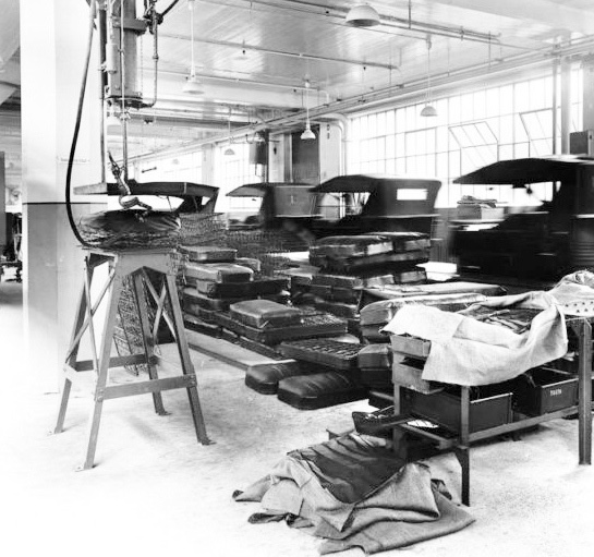

The spring just under the compression press sure looks black painted.
