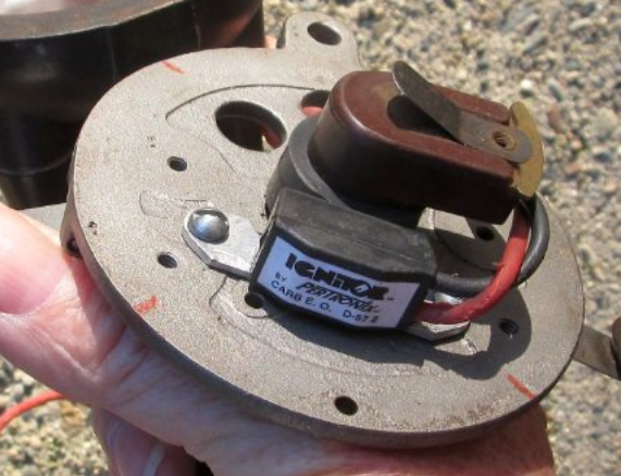

I sold an Atwater-Kent dist on the classifieds 3-4 months ago that had a Pertronics conversion installed- Here is the URL to the ad:
https://www.mtfca.com/phpBB3/viewtopic. ... er#p263996
Richard Kemp purchased it- contact Rich and see if he can get the model # off of the module.

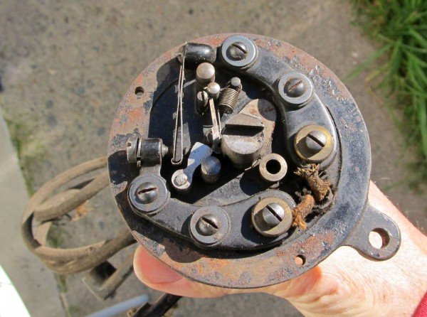

I think I'm the new owner of the model H Atwater Kent pictured. Atwater Kent has some real small odd shaped point cams. I picked up a Pertronics
at a swap meet a while bach that was sold as a 4cyl. chevy. Turns out it is a odd ball Mazda unit, it's for a vevy small point cam. Take a pic & meassurements of your point cam lets see if we can make it work. It checked out ok as per Pertronics test procedure.
