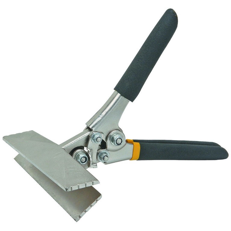

I used this type of sheet metal crimping pliers. Others will have an opinion I’m sure of what to use. I also used some slip joint pliers in the tight places.

I tried a similar plier, but it was not compound as the tool pictured. I couldnt get enough squeeze with my tool.

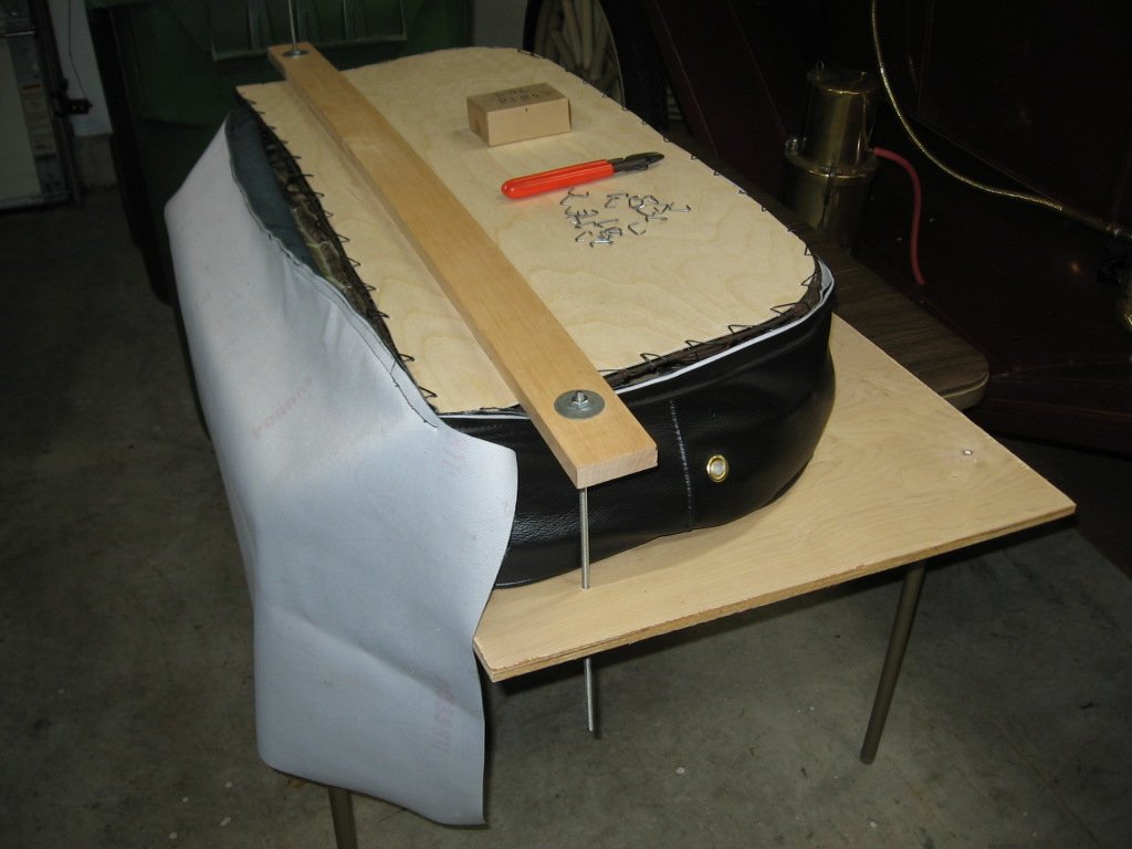

Regarding John's post, here is a home-made seat cushion compressor in action on my Flanders 20 seat. I made it from a piece of plywood, a board, and some all-thread I had lying around. :)

Clastique suggests the same seat compressor as suggested here, but with two lengthwise boards and all thread. Works very well.

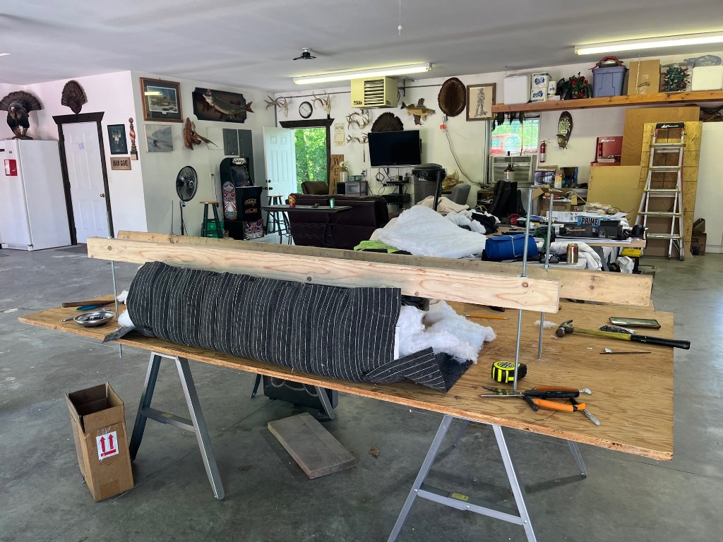

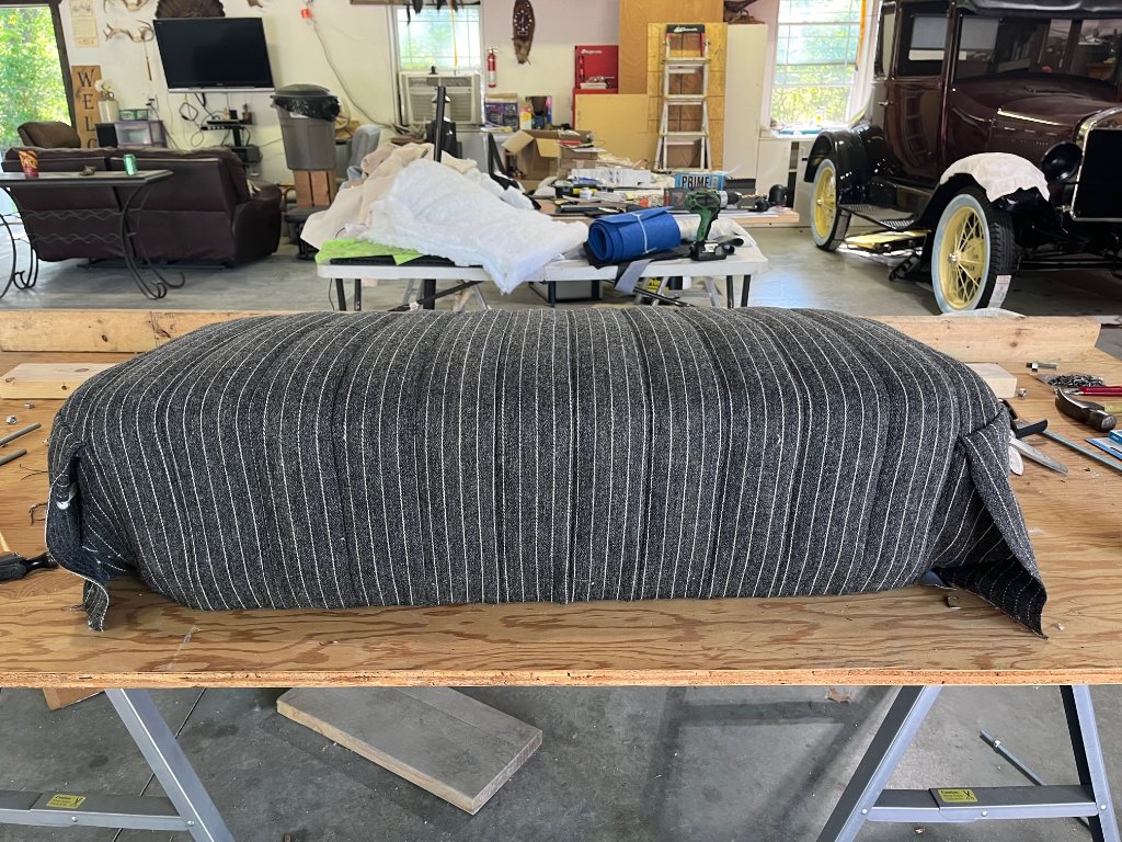

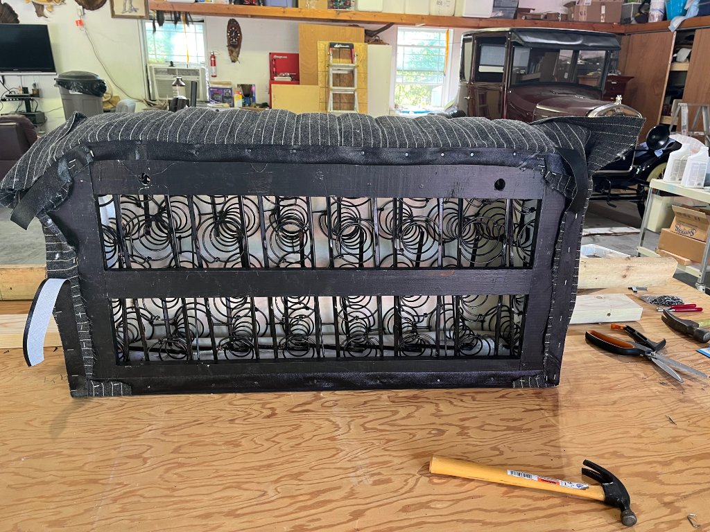

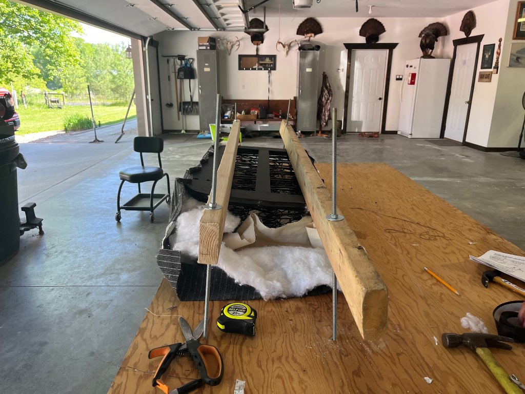

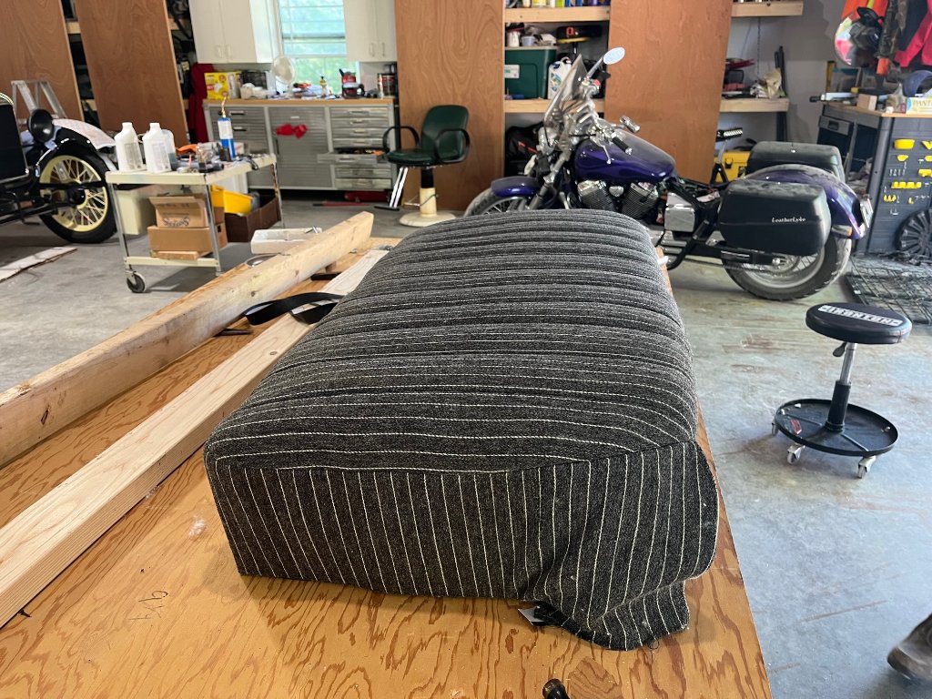

Post by BLB27 » Fri May 26, 2023 11:03 pm
Today, we worked on installing the cushion onto the seat spring for my 1927 coupe. We used a compression table. Here are photos. We still have to finish the corners.
