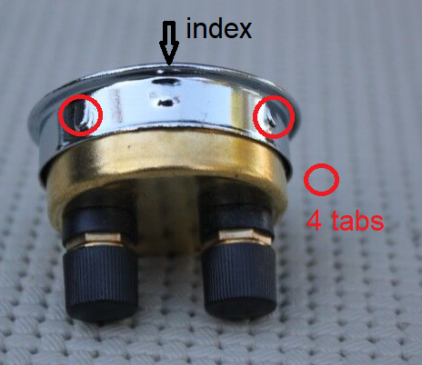

Can we assume its a small ammeter for 1926/27. The bezel holding the glass & indicator plate has a centering raised area to fit into the rectangular notch on the top of the hole. Also the tabs on the bezel need to be flattened when inserting into the curved notches in the plate. press on the bezel when inserting not the glass. I may have a spare glass - will email you if I doNY John T wrote: ↑Sat May 27, 2023 10:44 amHi All,

- small bezel tabs.png (234.04 KiB) Viewed 1625 times

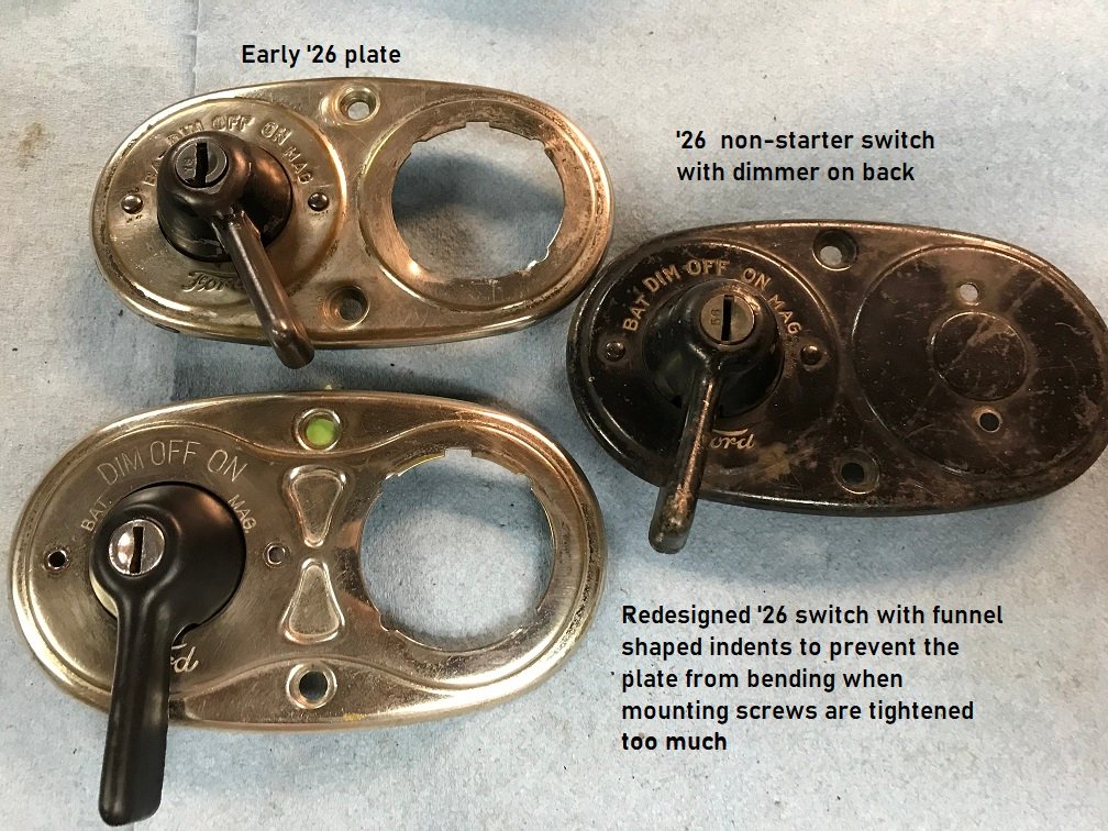

I'll check if it's an early or later 26 plate. The ammeter is the small script one with a flat bezel. For some reason, when I put it in and hooked it up, no power went to the lights, horn or coils. Wonder if I burned out the ammeter.

The small ammeter is the same for the early to lat '26 switch plate. Send me the measurements of the diameter of the broken one (or the indicator plate) to be sure its the same size. Just postage for what I may have - unfortunately it may be more than 1/4 inch if so postage about $5 for First Class

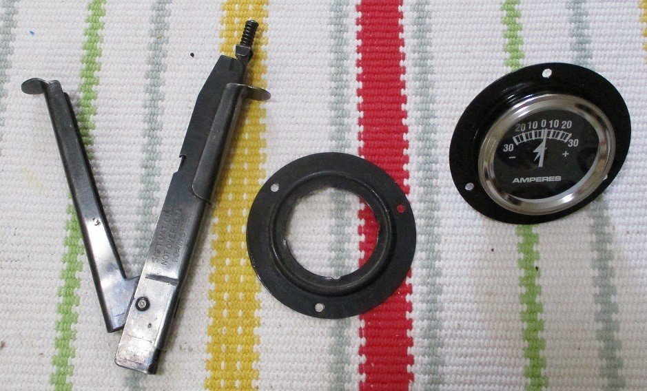

Another option is the ammeter that Tractor Supply and other sources sell. The cost is $11.97 at Tractor Supply.
This gauge has 30 - 0 - 30 numbers and fits perfect in the 1926-27 panel. Si it lends itself to Ts with an alternator upgrade.
I just used an aircraft nibbler tool to make the adapter a litle larger inside and the gauge slid right in.
Now it can be used for the earlier 1917 to 1927 panels.
